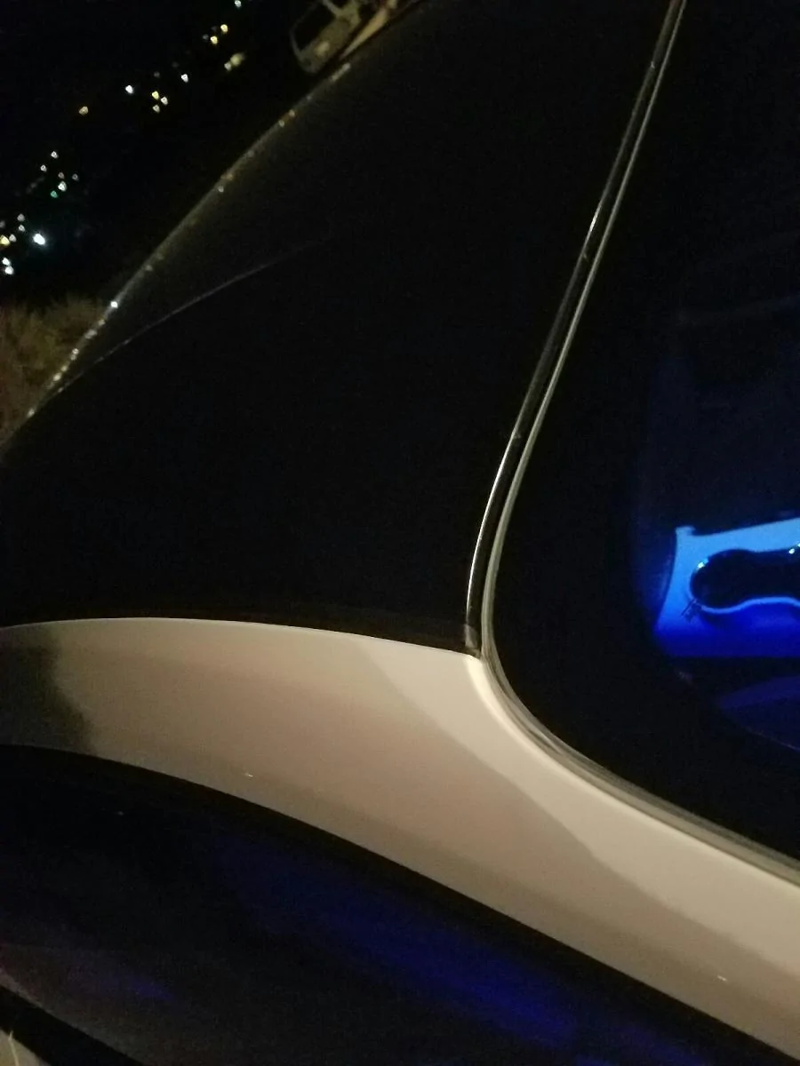

Yes was not to hard....hey sliver and black would look pretty mean on yours:thumbsup:

I've been debating doing it. Seems pretty easy because there's not too many contours to the roof. What did you do for the side edge? Just cut it at the bottom of the water channel?

Ther is wire tape that you lay down to cut the wrap ..makes super clean edges..then afterwards thers a thicker black tape to put on the edges to keep it protected...so never gets, snagger or ever comes up. Makes it look really clean

Kind of dark right now but you can still tell him the photo the tape that protects it
