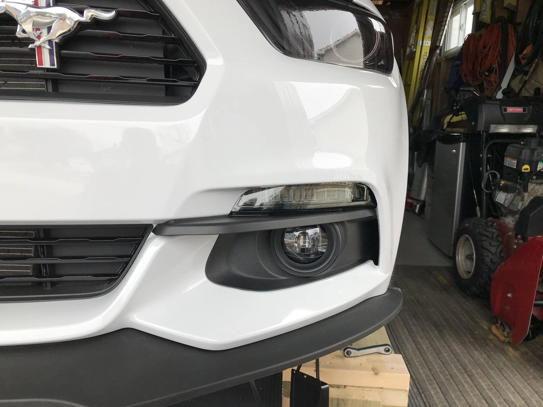

I'm still on the fence, how was install on splitters
If you mean difficulty level, it was easy. There is a screw behind the fog light you need to remove. Slip the splitter in and replace the screw. Everything else is just tape. It was easier for me, as I had the belly pan removed for the signal light install. But can be done rhru the front fender liner. Just need to remove a couple of the fender screws to get your hand in there. And you shouldn’t have to remove the wheel, but maybe easier. :)

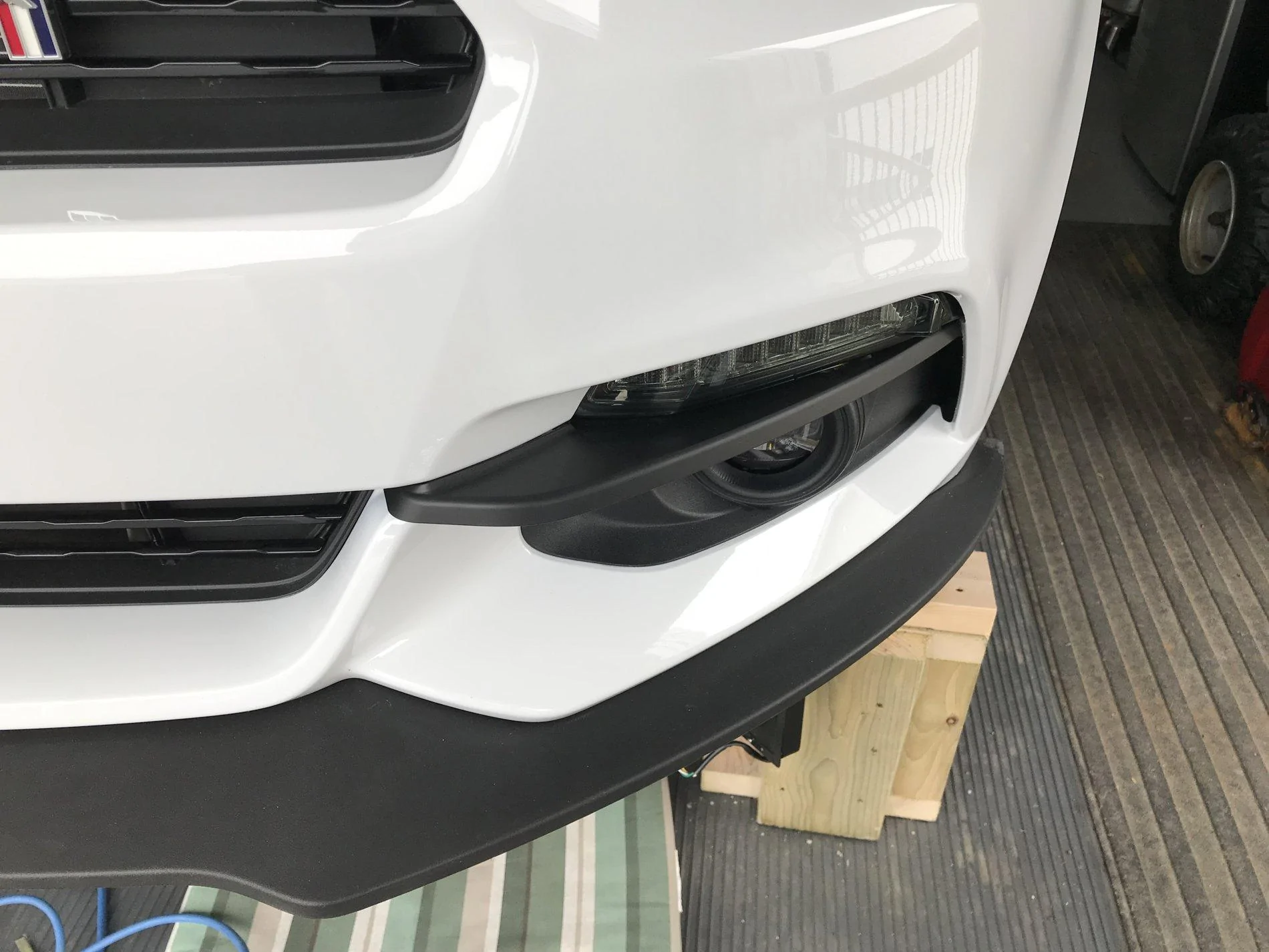

Best comparison photos I've seen to date. Thank you.
It should complement my GT/CS grille set well!
