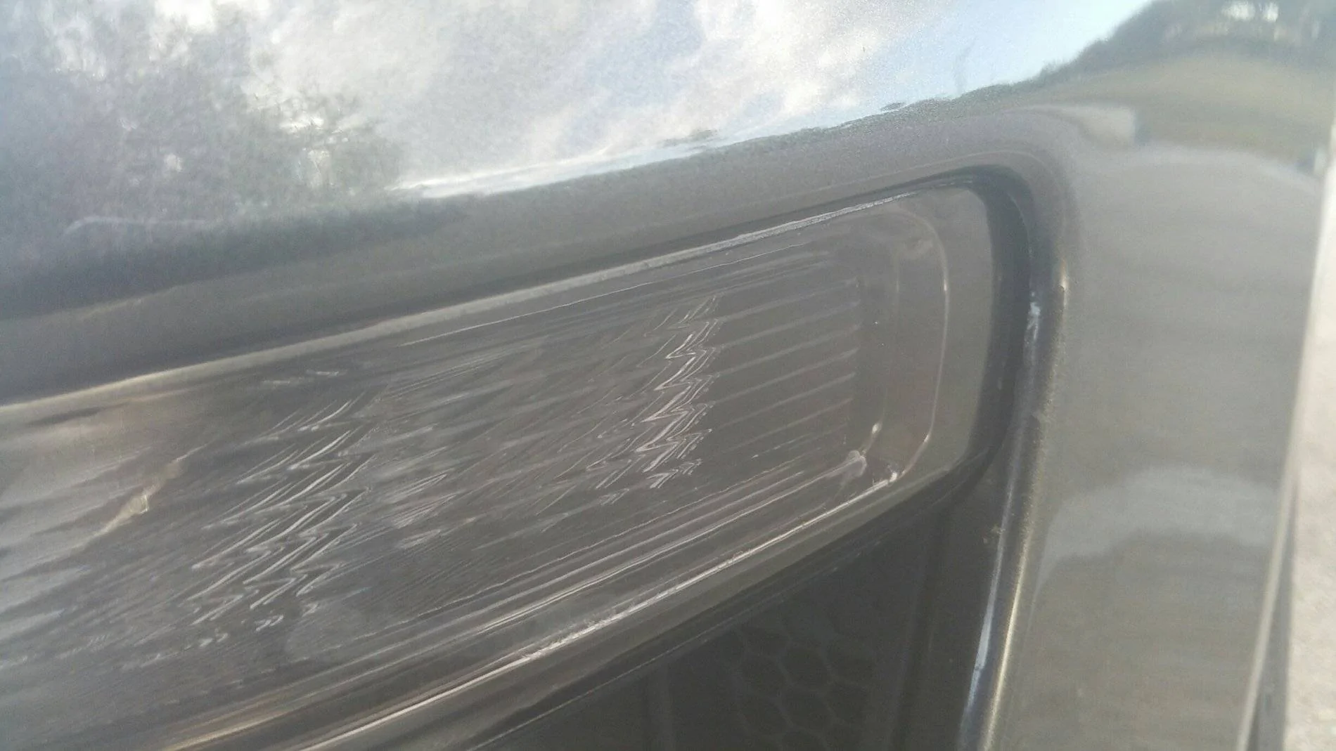

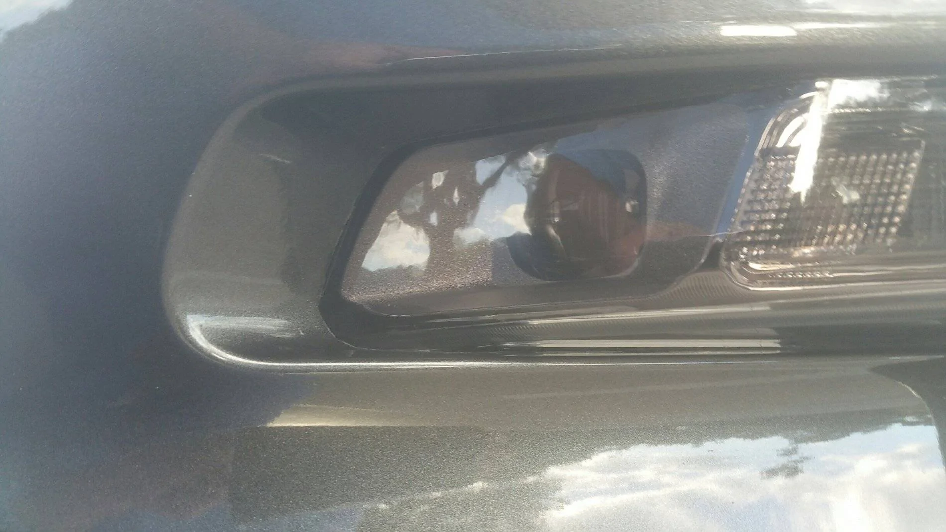

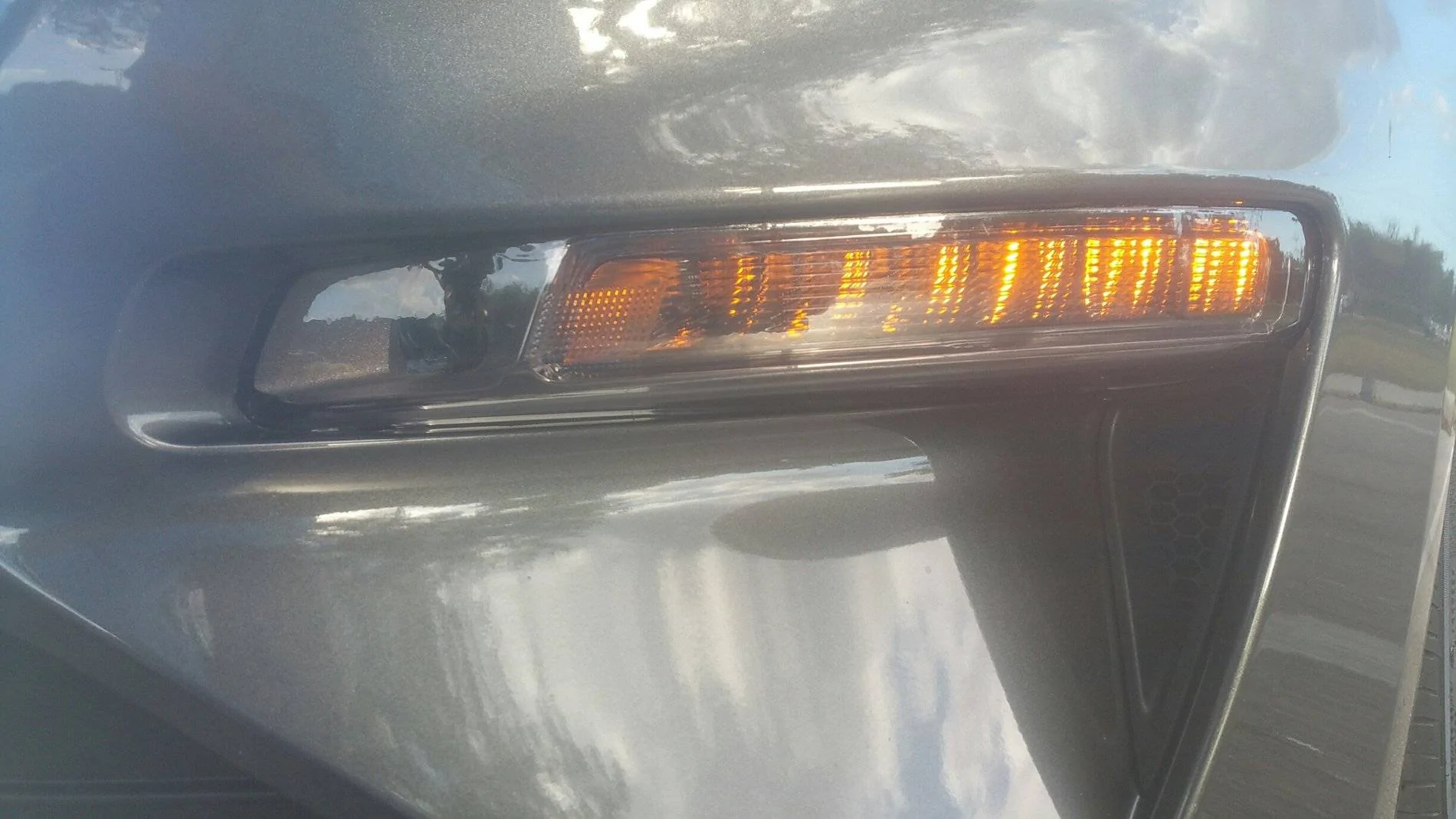

I didn't remove my 18+ fog lights when I installed mine from Big Worm.
I just soaked everything in distilled water with a spray bottle, lined up the film the best i could with about 1/4" overhang, gently pushed the lens back away from the bumper ever so slightly then used a plastic fiber stick and gently folded/pushed the film between the bumper and the lens. Be gentle and take your time.
then hit it with some heat and squeegee out the rest of the water.
sorry for the dirty car pics, been running around for 4 days trying to set users up to work from home... fun
FYI - the shade I am using is listed on Big Worm's site is "tint(lightest)"
