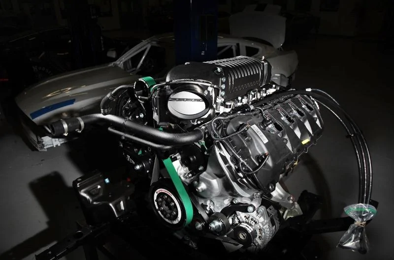

When I get back from deployment, I plan on making an aluminum pipe like on the CJ motors, except with a direct 90* bend at the tank nipple. It's hard to see but it's just loops over the throttle body.
