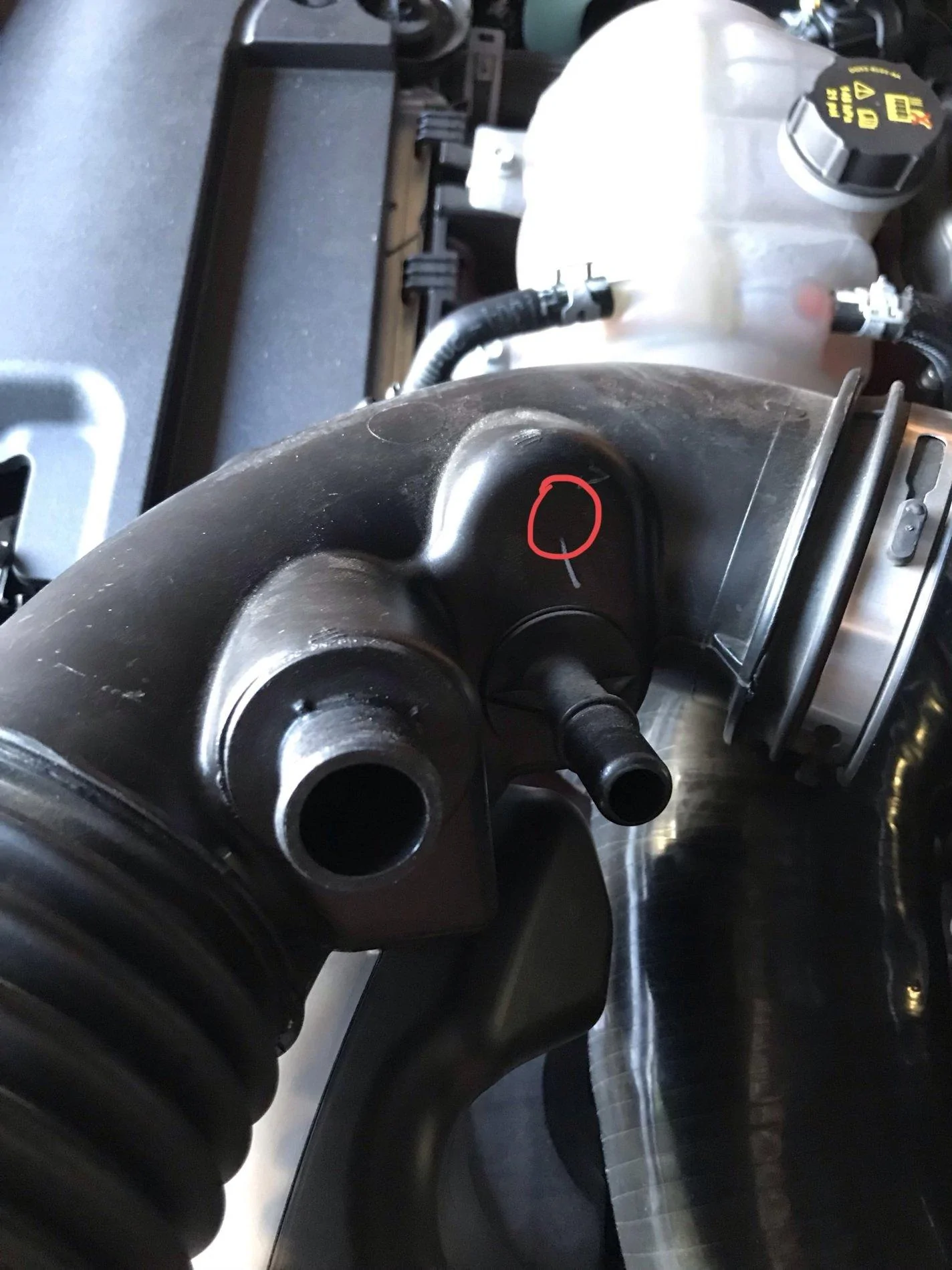

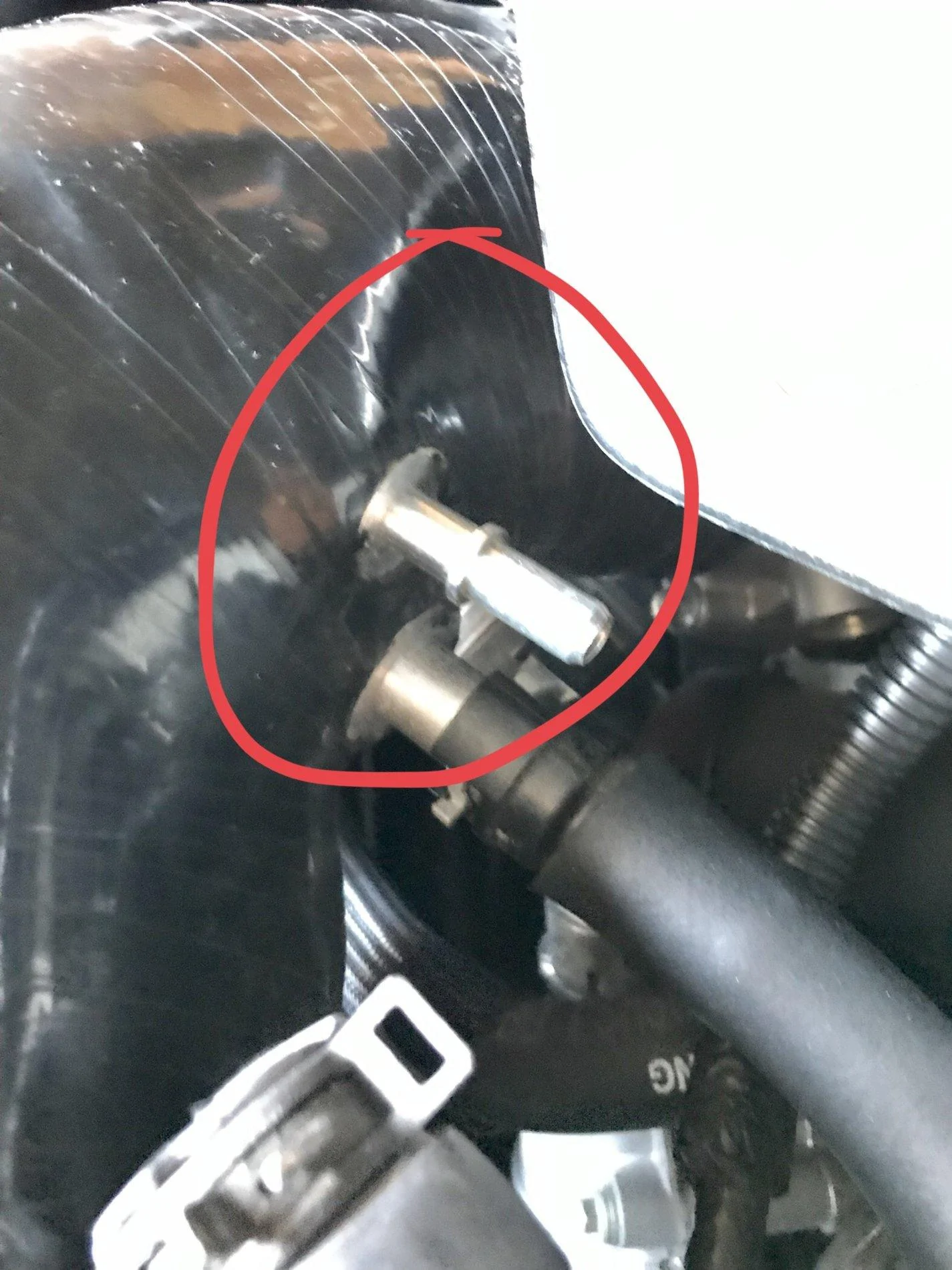

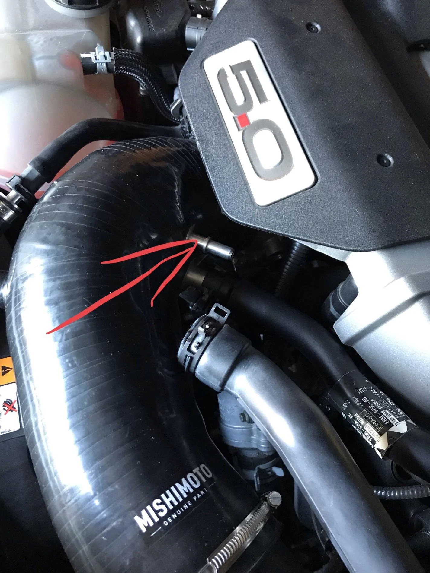

I managed to pick up a mishimoto intake for cheap and when installing I found that it has an extra male pipe connector that isn’t on the factory intake. Is this just a US spec thing and just needs blocking?
This is where it would be on the factory intake.
I’ve checked the mishimoto website and they use the extra one, guessing the US spec s550 have an extra breather...?

it was for the intake runner exhaust that was phase out in 2017. It now vents to atmosphere.
They should have supplied you a blank off bung for it

Thanks for that. Yeah I currently got it bunged so all good. Good to know what it was for.
