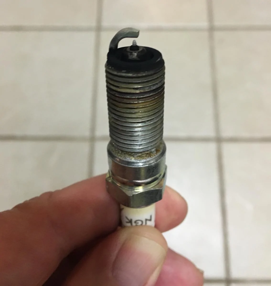

Looked fine until I placed it upside down

Im back on 93 and i changed the plug it runs fine now will be switching my plugs for densos and eventually going to get an AP3

I'm willing to bet you were getting lean misfires and some det. Either your tune is way off or your mix is way high in E content.

Detonation in the tune, but also high cylinder temps from being lean.
I have had this happen to a customer of mine as well, but he kept switching between tunes for some reason.
