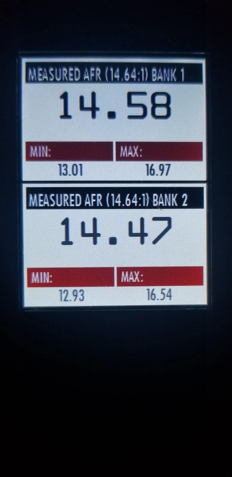

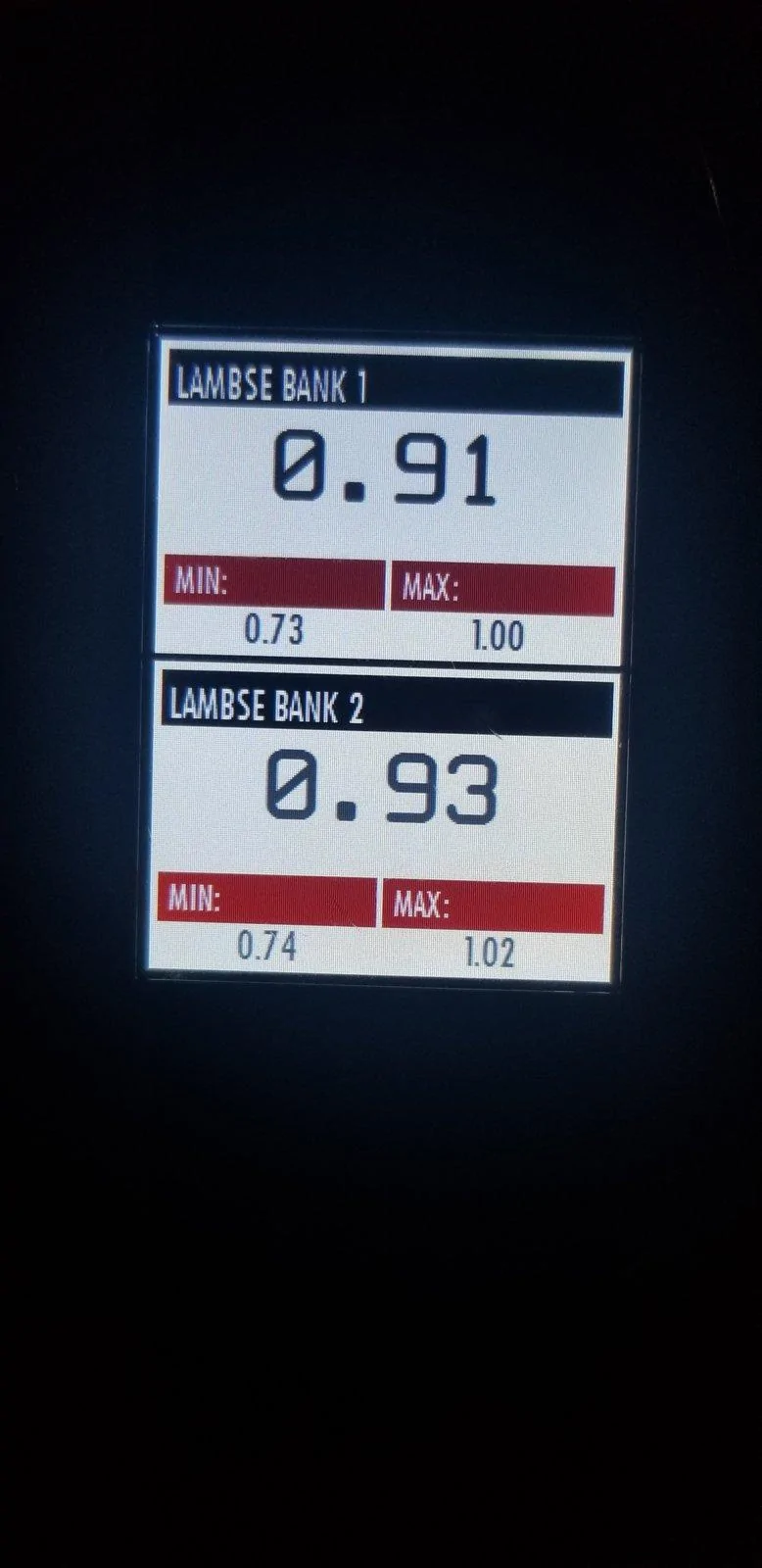

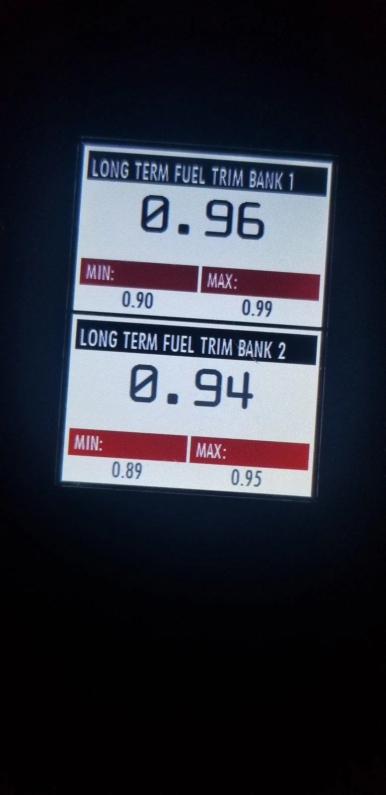

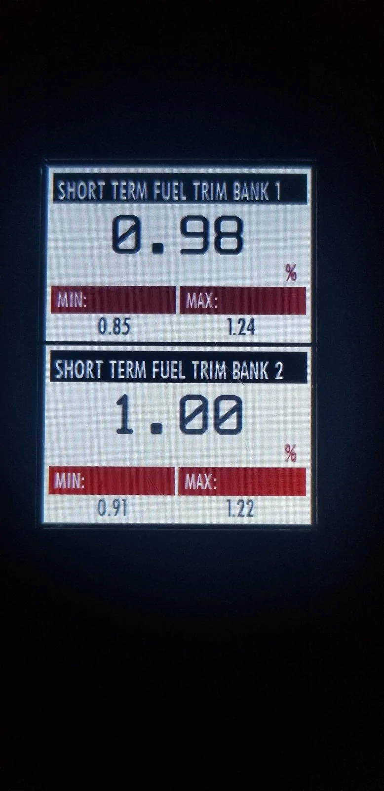

Does that mean my injectors are working properly?
Not enough information for that, but as far as your fuel trims at idle those look fine. A small variation between banks is normal. If the difference was larger there would be an issue but also a CEL for a/f mixture imbalance.
