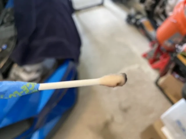

I saw misfire on cyl4 in the first 1000 revolutions, but only after the car sat for 2 days or more. I had a tiny coolant leak into cyl 4, but it took 2 days to leak enough to cause the misfire.

How does your coolant look? If its the slightest bit low, ask them to let it sit for a day, and visually look for moisture. they can do that shining a flashlight in with the plugs removed.

mid your coolant is disappearing, and it’s not on the ground under the car, then it’s getting in the motor or in the oil. Time for a compression test. Or, if your out of warranty and want to do yourself this is how I did it. I pulled the plug on the cylinder that was misfiring, put a towel over the fender to protect the paint, put a small 3 step ladder next to the car, climbed up and shined a flashlight into the cylinder. I could see a tiny puddle clear as day. I taped a qtip to the end of the straw, and stuck it down to get a sample of the liquid, and the color matched the color of the coolant. Since I’m under warranty still, I took it to the dealer and told them what I found.

Thanks for information. I’m scared to check the compression... gonna throughly check for fluid leaks with fingers crossed.
