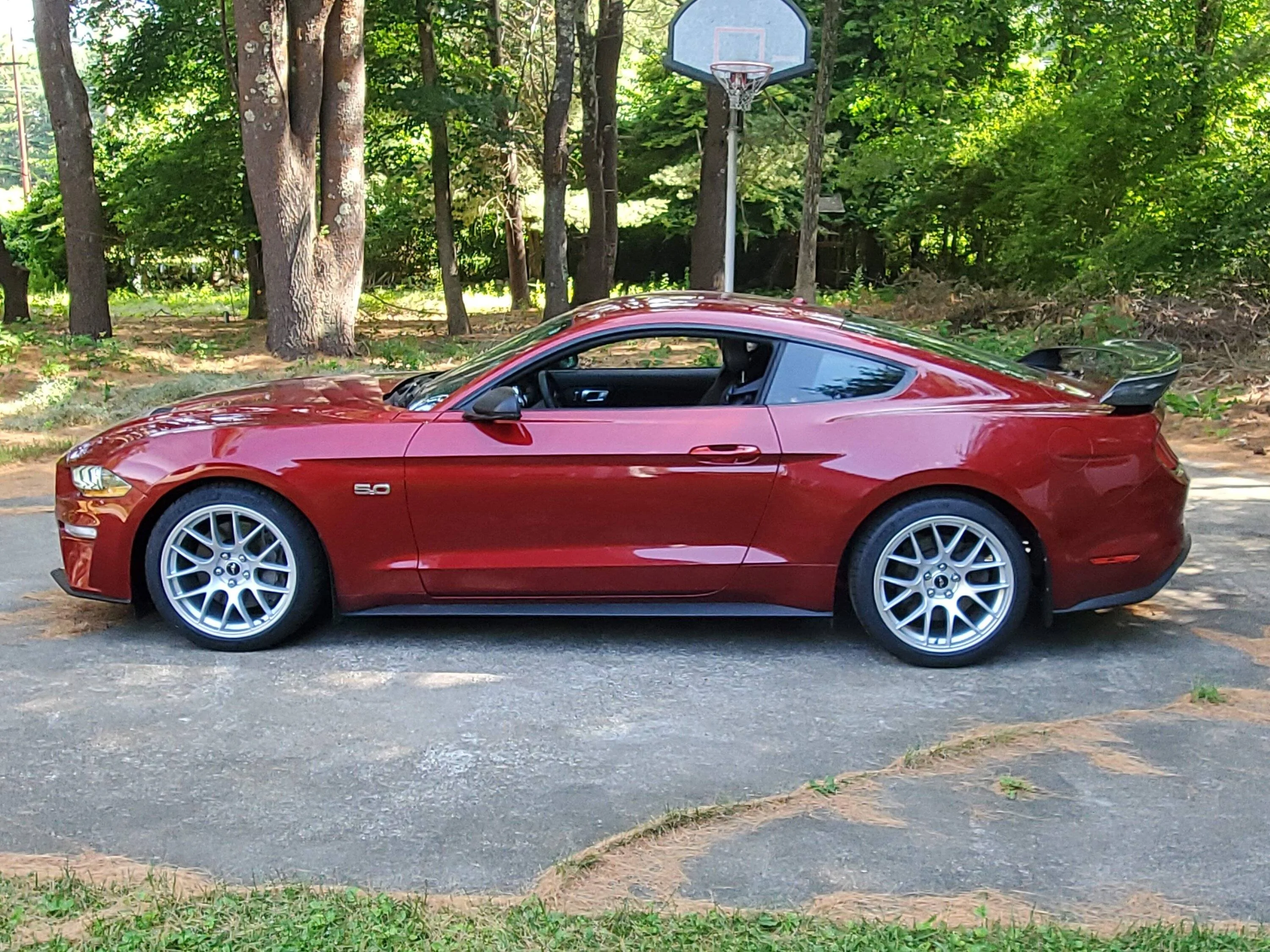

This is my car today. I'm running Michelin PS4S 275/35-19s on Apex EC-7s in 19x10 with the 40mm offset. I *just* finished installing Steeda minimum drop springs and Bilstein B6 shocks all around (1/4" spacer in the rear). It might not be as dropped as some people would care for, but it's about as low as I would want to go living in the northeast and this being my DD.
It was a non-PP car, so even with the minimum drop springs I went down between 1" to 1-1/4" in the front, and about the equivalent in the rear minus the spacers. I've got less than 100 miles on it since the suspension and it needs an alignment, but there's no rubbing even at full lock. The fronts are *close* to the struts, but they clear, and looking straight down from the fender tops, there's no poke.

Looks great.
