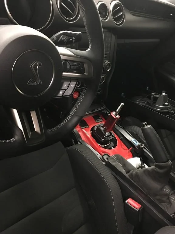

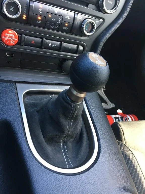

I had George install the MGW shifter a couple weeks ago at his shop in Augusta. First of all George is a great guy and the experience was awesome. As far as the product, it is top notch! It is a work of art in terms of craftsmanship. It is really a shame that it isn't visible all the time. That's why I took this pic before George buttoned it all up.
One thing I love about this shifter is that whether you use MGW's aftermarket knob or the OEM unit, you don't have to use Locktite to secure the knob to the shifter like Ford does. :frusty: It comes with an adapter to lock down the OEM knob or their knob locks down with a set screw. Much better design all around.
As far as using the shifter, it feels like you have a much more direct connection with the transmission. Where the OEM shifter was pretty good, this is just that much better. It does transmit more vibration through the transmission tunnel and the shifter itself, but it isn't bad. My OEM shift knob would rattle around 4500 RPMs ... this one doesn't do that. Might be the shifter itself or because I'm not using the OEM knob anymore. Shifts are very mechanical in nature and have positive engagement; no wet noodle shifts here and you can bang on the thing and never worry about bending or breaking anything.
It also removes the lift to reverse engagement. Now you press down on the knob to enter the reverse slot.
Is this a must have modification? ... honestly no. But it IS worth the cost and it makes driving this car a little more engaging and fun and that is probably worth the price of admission here alone.
