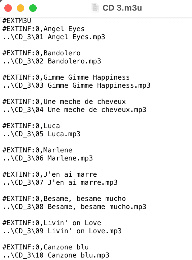

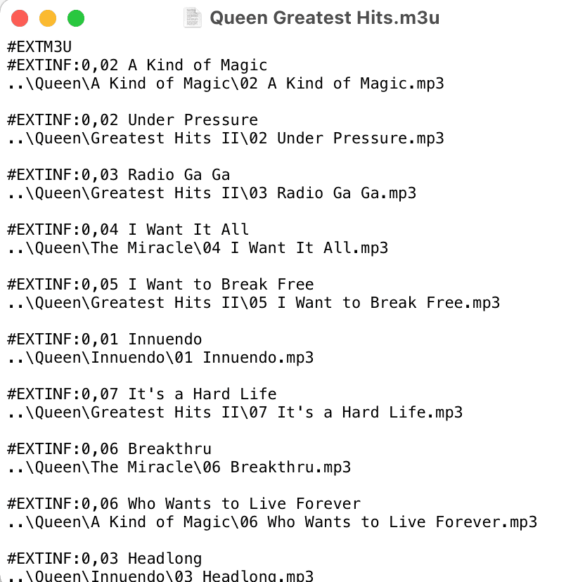

On my thumb drive, besides the various folders holding MP3 files, there's one folder called "Playlists". And in this folder I store playlist files in standard M3U format. An M3U file is simply a text file containing a list of paths and filenames. For instance, I have a playlist file called Queen Greatest Hits.m3u, whose contents looks like this:
I've also made playlists that mimic the contents of my music CDs. For instance:
And now I use the voice control to switch between playlists. Press the voice control button on the steering wheel and say "play playlist Queen Greatest Hits", or "play playlist CD 3", etc. The name of the playlist, as seen and understood by Sync, is the filename without the M3U extension.
If your MP3 files have the metadata well defined, then you can use the voice control to play certain albums, or artists, and so on. When you're in the mood for Pink Floyd, for instance, but your Pink Floyd songs happen to be scattered over several folders, all you have to say is "play artist Pink Floyd", and it will search for MP3 files with this tag in all folders. It's quite neat, actually.
I still miss the ability to browse music files with the steering wheel buttons, but the voice control can be a reasonably good substitute if you give it a chance.
