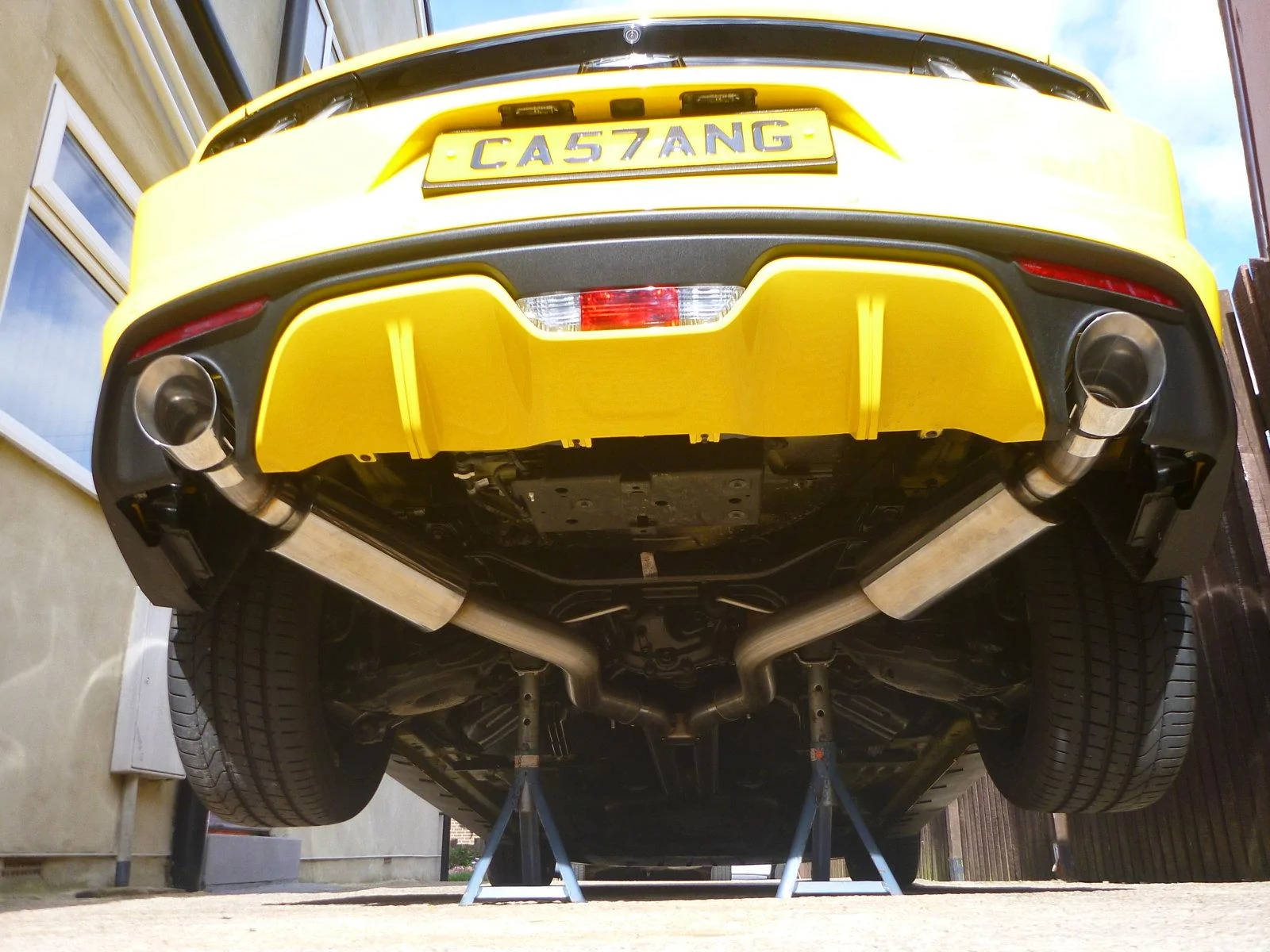

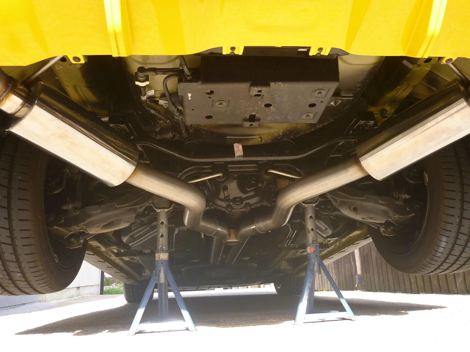

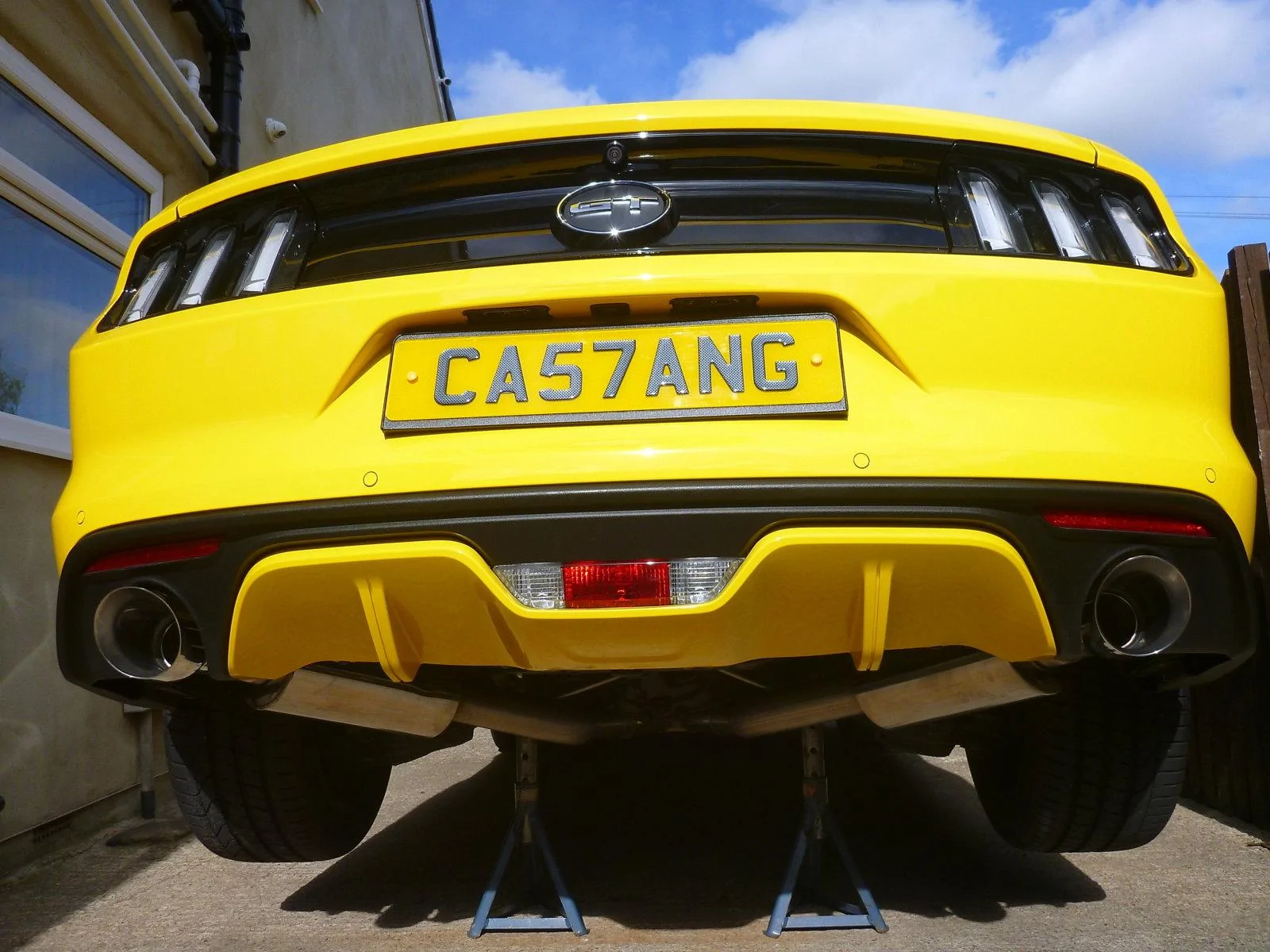

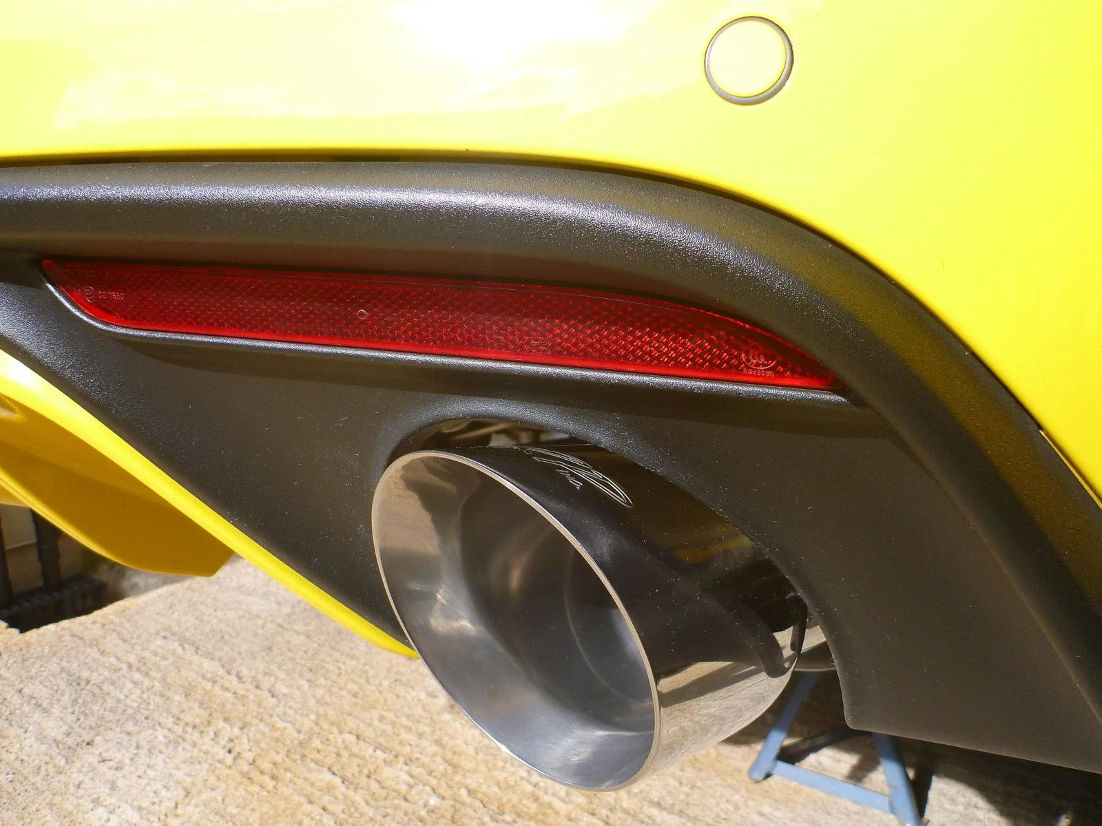

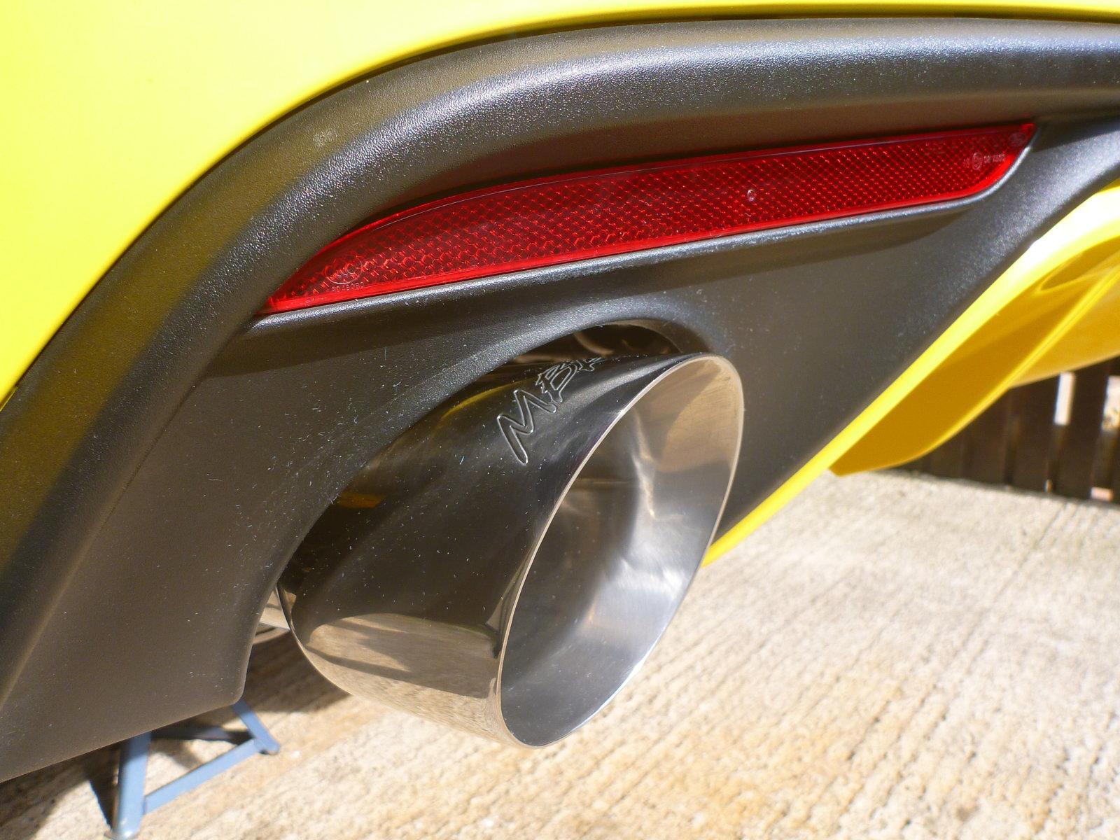

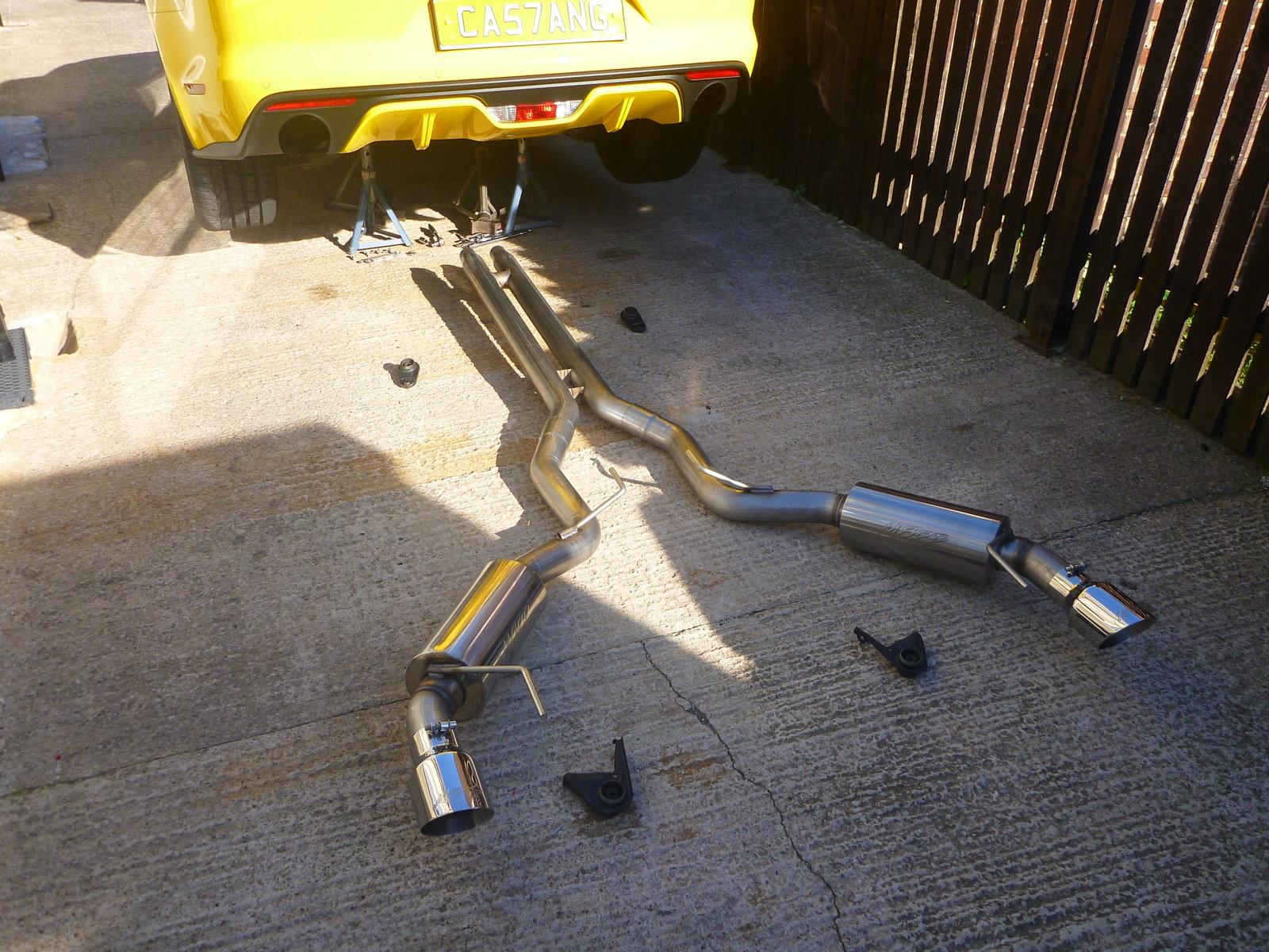

Fitted a new exhaust yesterday. MBRP street Cat Back in 3 Inch stainless.

simply brilliant! nice tone Chris!:clap:
what a great difference :rockon::rockon:
looking forward to hearing it in the flesh at Howden - you ARE going I guess?

Thanks Bob, it has transformed the Mustang from a Grand Tourer to a Muscle Car. I'm very happy with it :clap:

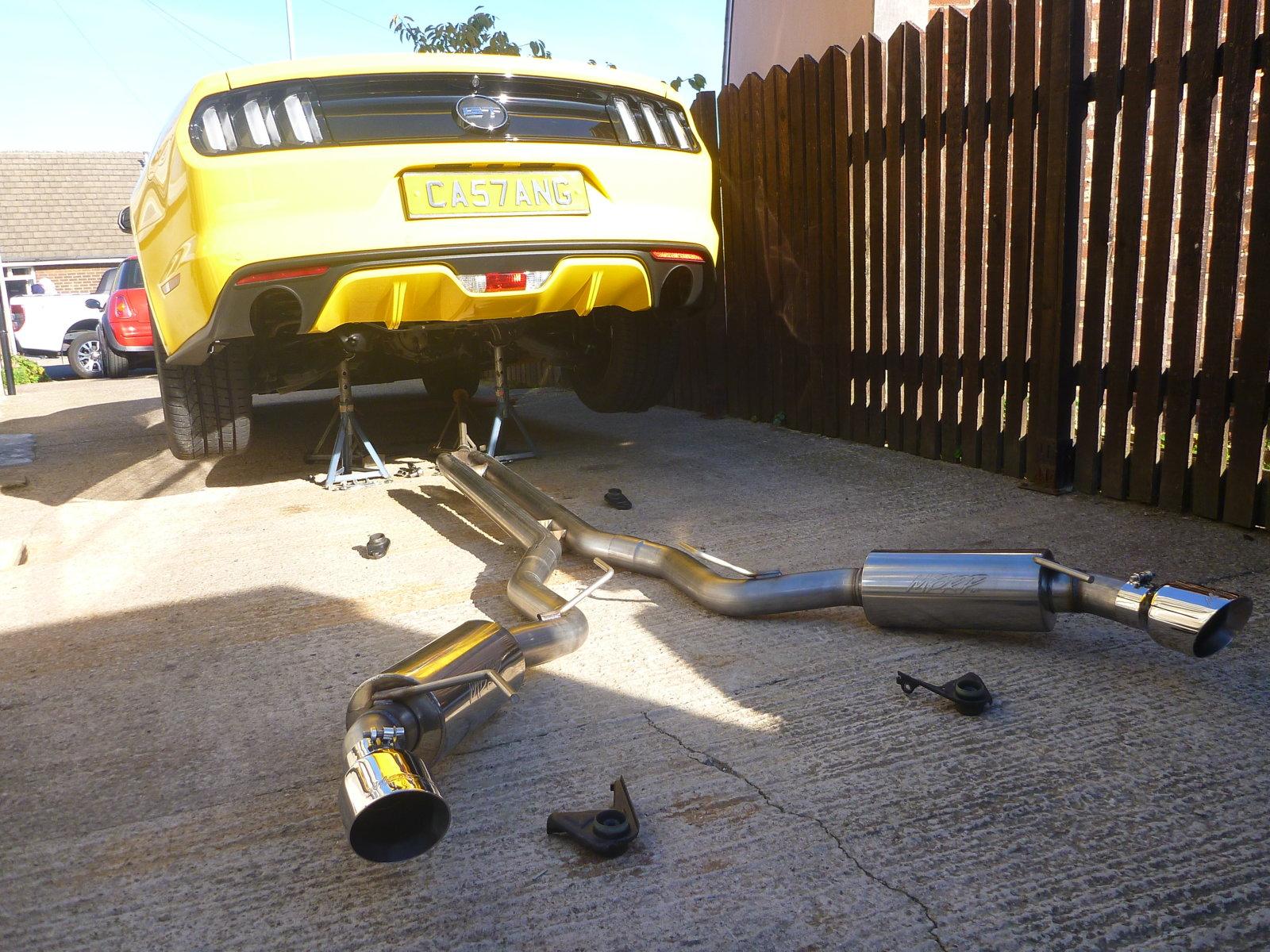

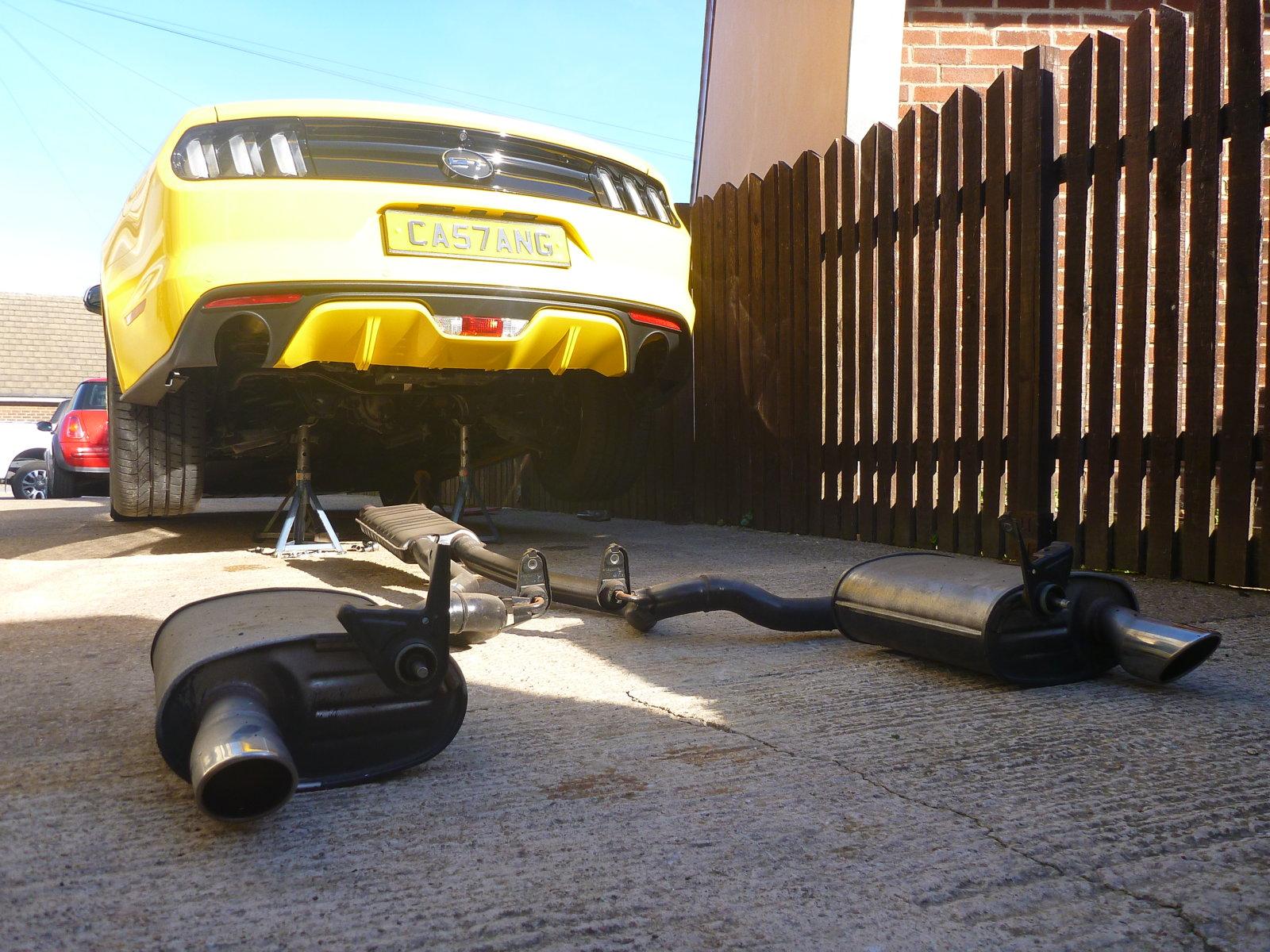

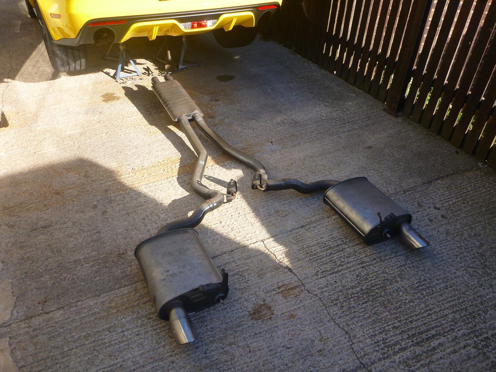

Just bought one of these. How hard are they to fit on ramps?
Thought I'd have a go at it myself!

Hi, very easy. I did it single handed. Took about 2 hours. The old exhaust is one complete piece, and very heavy, I placed an axle stand under each tube when it was loose. You can remove all the hanger bolts without it dropping as the have small hooks that sit inside the chassis, when it is ready to be lifted off, simply lift up and back at the same time. The MBRP system is less than half the weight and in three sections. Re-use the original clamps and hangers. You may have twist the back boxes to get it perfectly aligned before tightening up.
It is a great exhaust sound, good value, well built. You'll love it.
