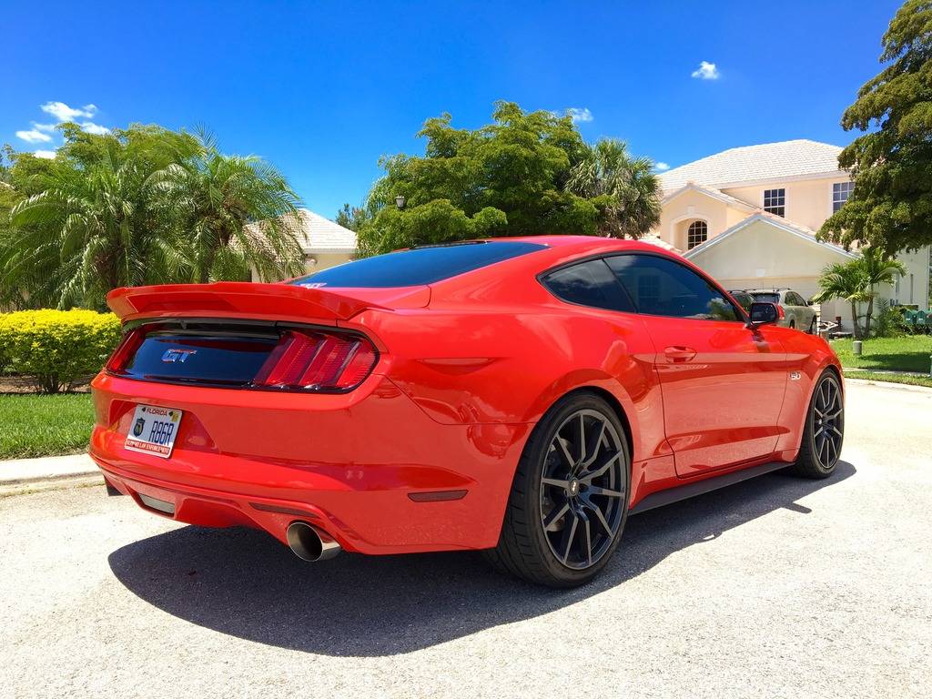

You could weld in some resonators. Alternately, and I swear this sounds crazy but it's legit, if you rotate the tips 45* so they match the curve of the valence, it drones less. (and looks cool)
Like so:
45 degrees? Could you get a better picture of it for me please? so 90 degrees is a quarter turn. 45 degrees would be half of that right? Would even more of a turn, let's say turning it upside down, eliminate it even more? Or perhaps a legit 90 degrees? Thanks for any answers.
Like so:
Wonder if this really works.. It looks very nice flush like that.
-Josh
Well I gave it a shot. It took about 10 minutes to get it set up correctly. But I angled them and took it for a drive and it didn't really make a difference sad to say. I was hoping this would work so as to avoid having to get another cat-back. But I guess the only thing left for me to do now is to get a Solo Thunder cat-back since I have a vert and they are the only other ones who make a cat-back that fits. I teased myself with the idea of just welding in some resonators or something but that's a bit more than I feel like doing. So in a few weeks I'll be getting the Solo.
