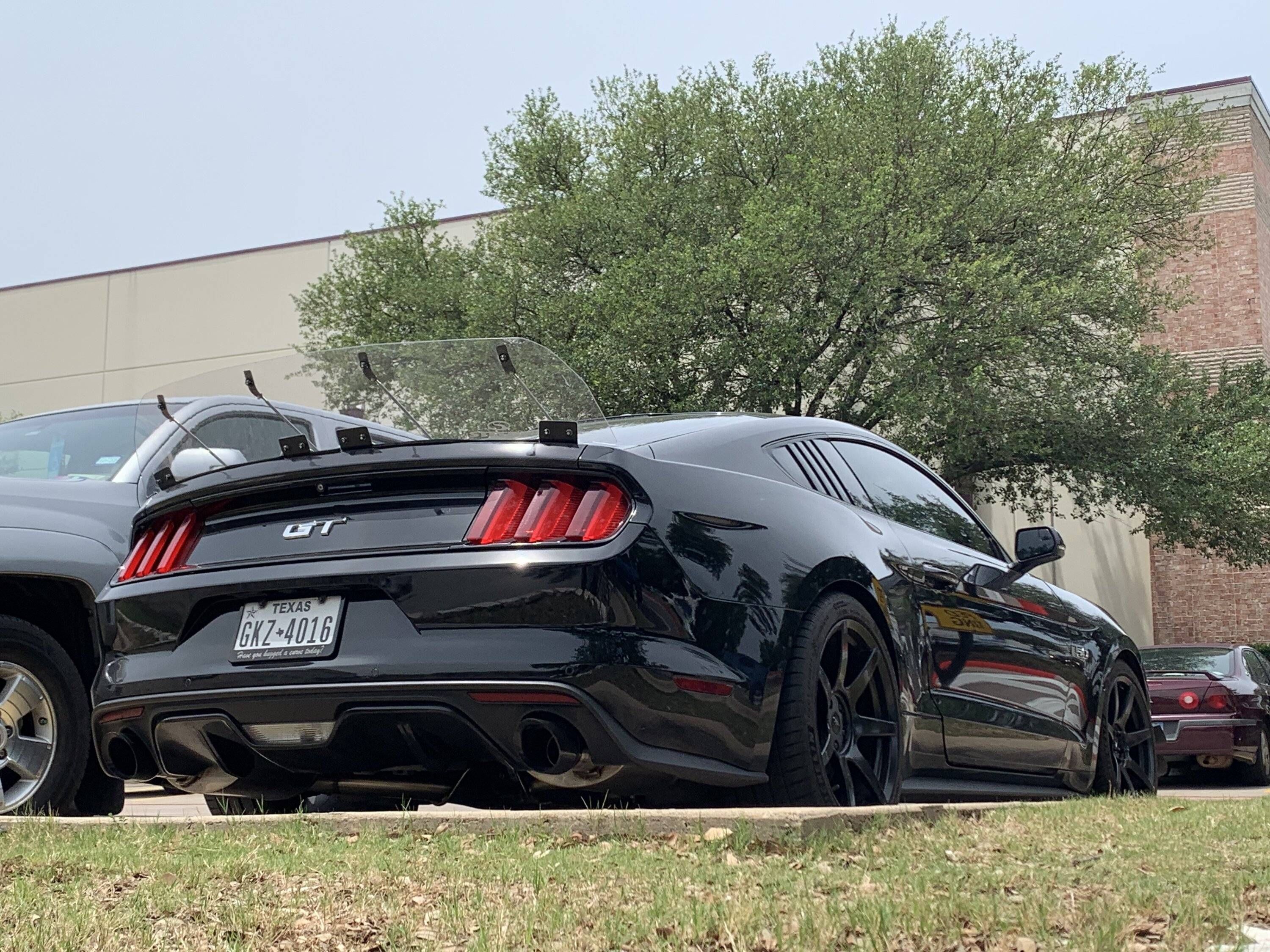

The offset locates the center of the wheel (and tire). If you go wider with tire width (and/or wheel), you're pushing equally on the inside and the outside clearances.
With the right offsets, you can run a 285 easily in the front, usually with a 10" wheel, but the offset will need to be ~35-40.
On the rear its pretty easy to run a 305 tire even, but probably with a 52 offset. You can run a 285 with a 35-40 offset in the rear.

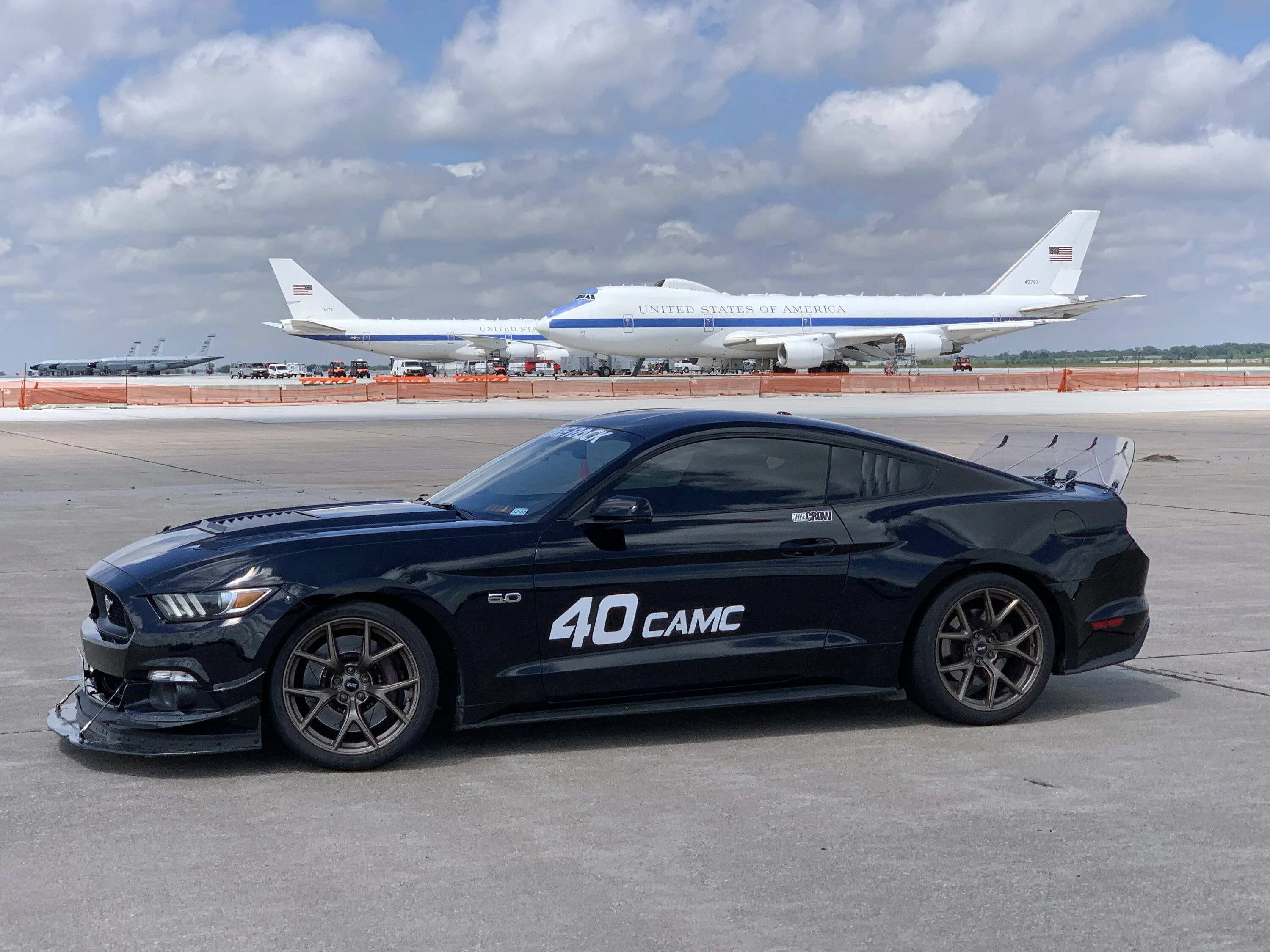

Once you start going wider than stock, offset will neccessarily change.
There are about a billion 20x10 ET40-35 and 20x11 ET52-50 hubcentric wheels meant for mustangs that will work . 10.5” wheels are a whole lot less common, but some exist. None of em have stock offsets.
My square street setup is flush with the fenders and is a 10” ET35 wheel with a 285 tire
I also run 315 square on 11” wheels with extra large spacers but thats another story.
