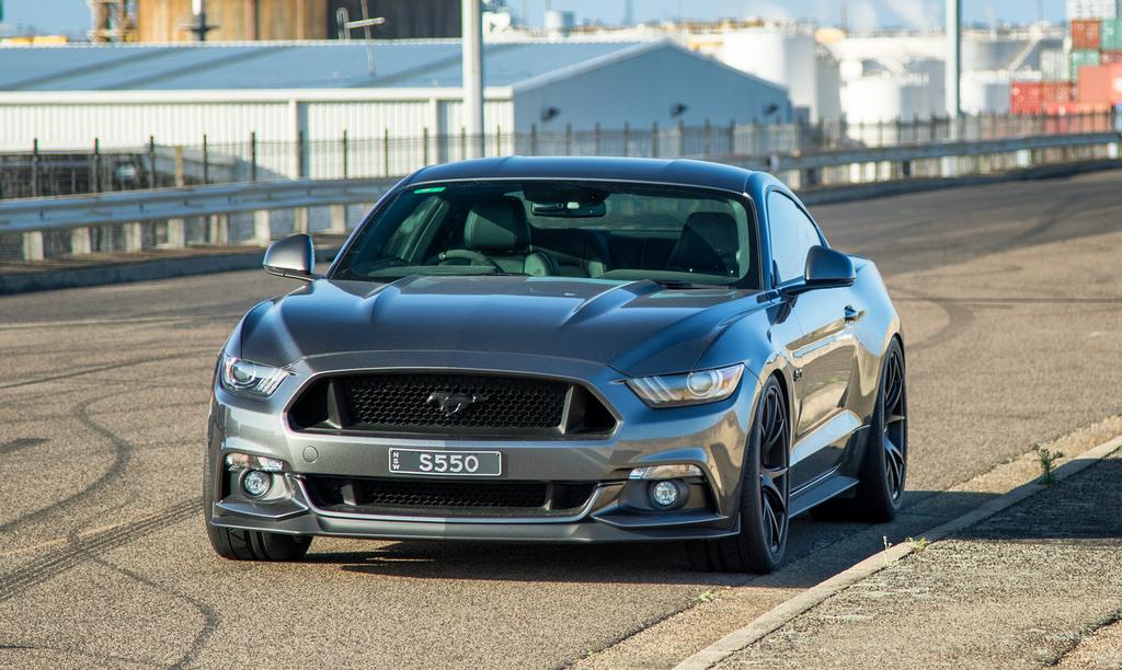

It'll probably fit with a lot of camber. Mine are 20x11 +55 with a 315/35, and I'd call them plenty flush at -1.4 degrees.
