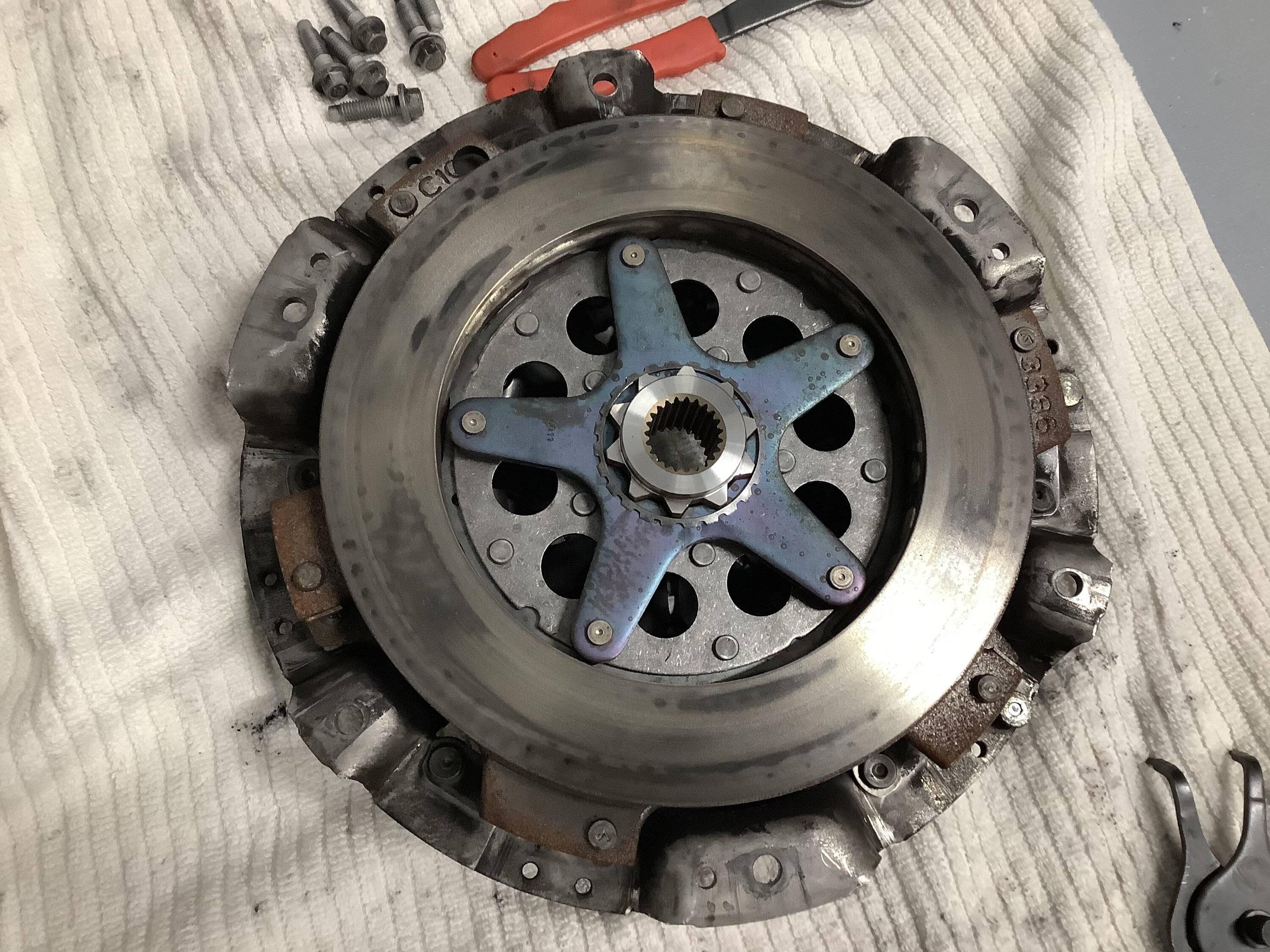

What’s the fix for a glazed clutch? Could it fix this?
A few high rpm launches can sometimes remove mild glazing.
Hmmm I'm not a clutch 'expert' and without knowing driving habits that looks a bit burnt to me rather than glazed but the pattern is interesting, like uneven pressure. Do you have pics of the clutch?

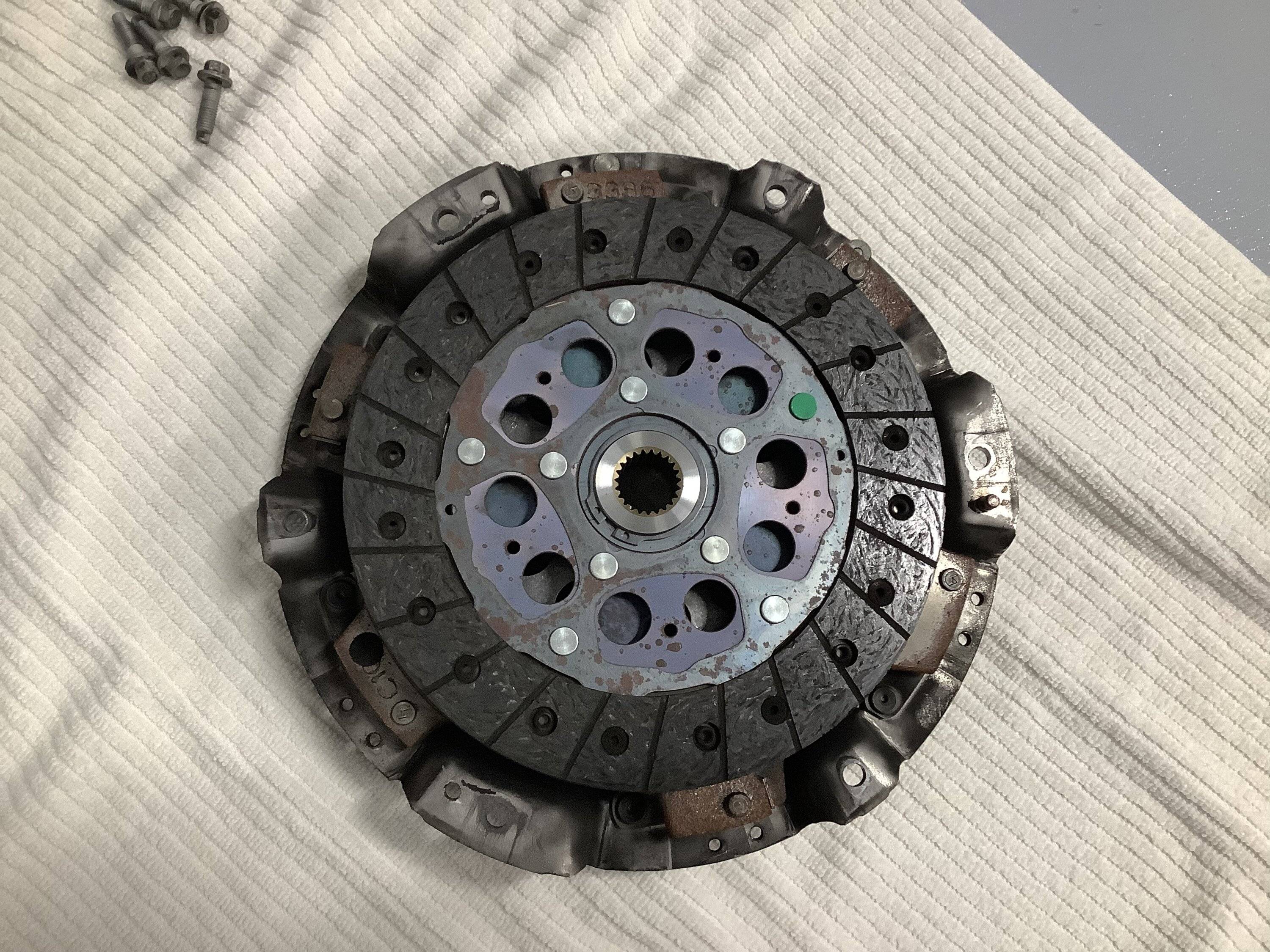

Yes, here are the clutch discs.

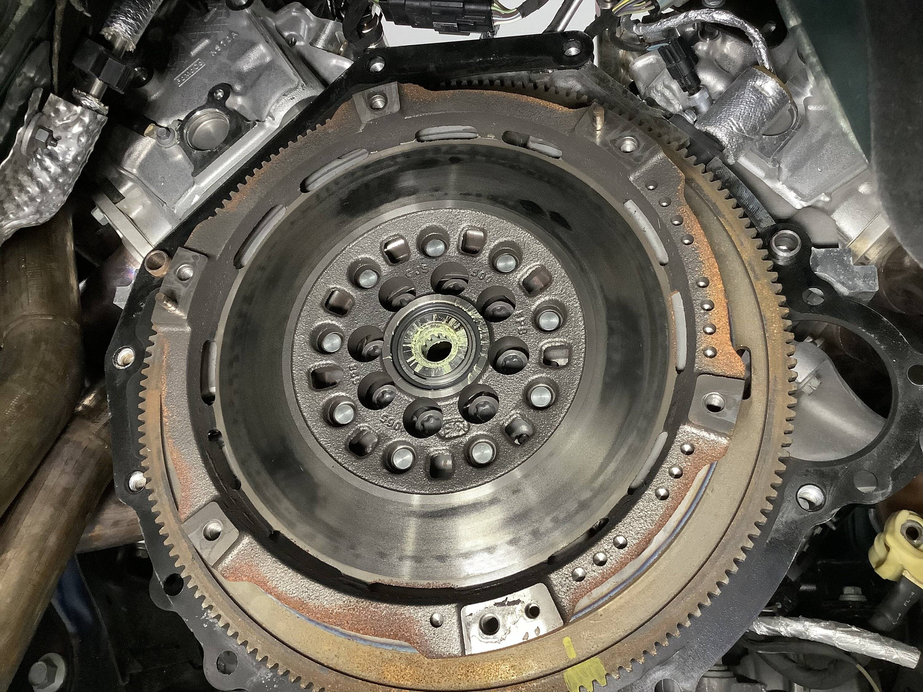

That doesn't look bad at all, it's a bit hard to tell from the photo but noting the marks on the flywheel can you see corresponding marks on the disc? Has the flywheel been confirmed as flat and true? Also there looks to be some burnishing of the pressure plate at 3 o'clock. What symptoms were you getting?
I didn’t see any corresponding marks on the disc, nor did I check to confirm that the flywheel was flat and true.
I experiened some slip on my 5th pass at the drag strip, as well as crunching on the 2-3 shift. I drove the car on the street a bit afterward and noticed a chirping noise every time I released the clutch pedal during takeoff.
I wasn’t too upset about it, because I had always felt that the clutch and tranny were weak link in the drivetrain and either one or both would eventually give out on me with repeated nitrous use, so I decided to upgrade both. I’ve since replaced the clutch with a Ram Pro Street Twin Disc and lightened aluminum flywheel. I also rebuilt my tranny with stronger internals and special treatments where applicable. I should have the car back on the road soon to begin testing and evaluating the upgrades.
