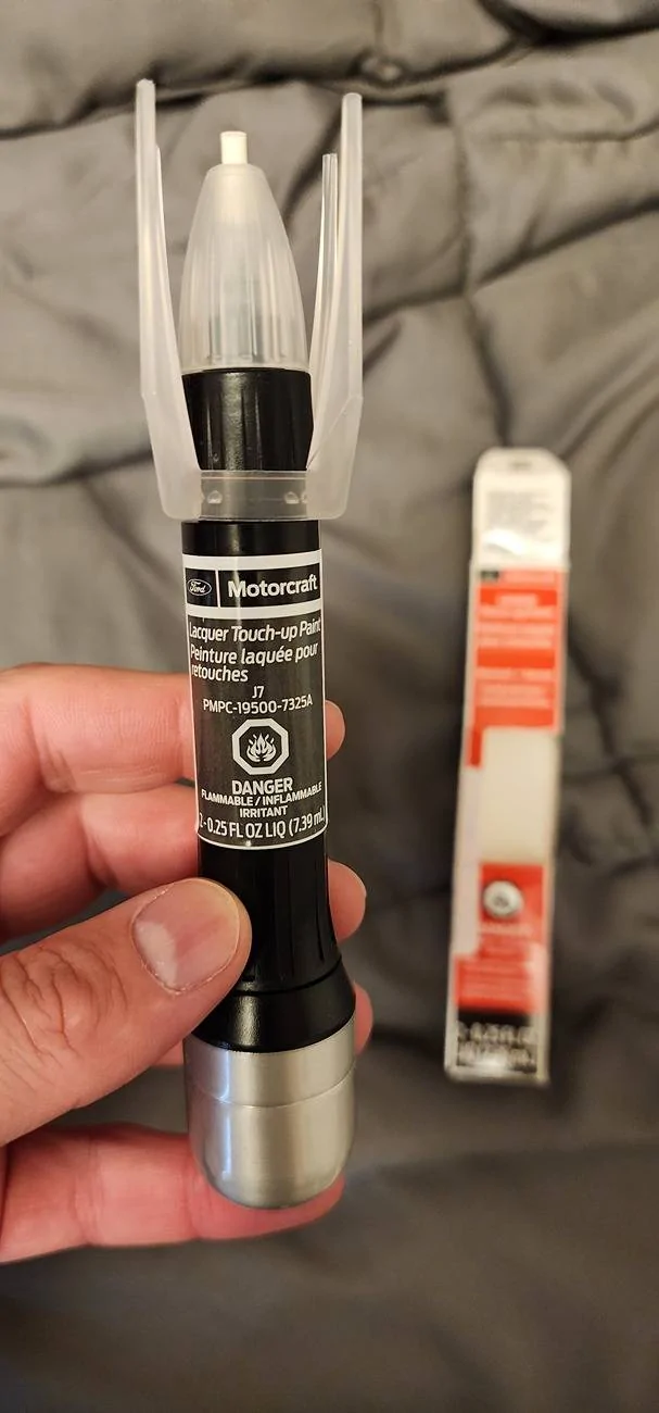

Has anyone been able to get the magnetic metallic touch paint from Ford and if so could post the part number?

It’s a rock chip on the spoiler from a semi.

Don’t use that stuff, it’s total garbage. Dr. Colorchip is the best way to fix chips and scratches. With this stuff you can properly blend and it looks cleaner. The Ford stuff just sits like a blob of paint…

The area is about the size of the end of an Apple air pod bud/ear tips. Worth the price for the Dr color Chips?

Based on their video, the paint looks much easier to apply than the typical Ford touch up bottle. I ordered the kit so hopefully it does its job.

Ive fixed honestly around 8 chips or so with it of different shapes and sizes. None have had any issues staying filled after washes, waxes and winter weather conditions.
