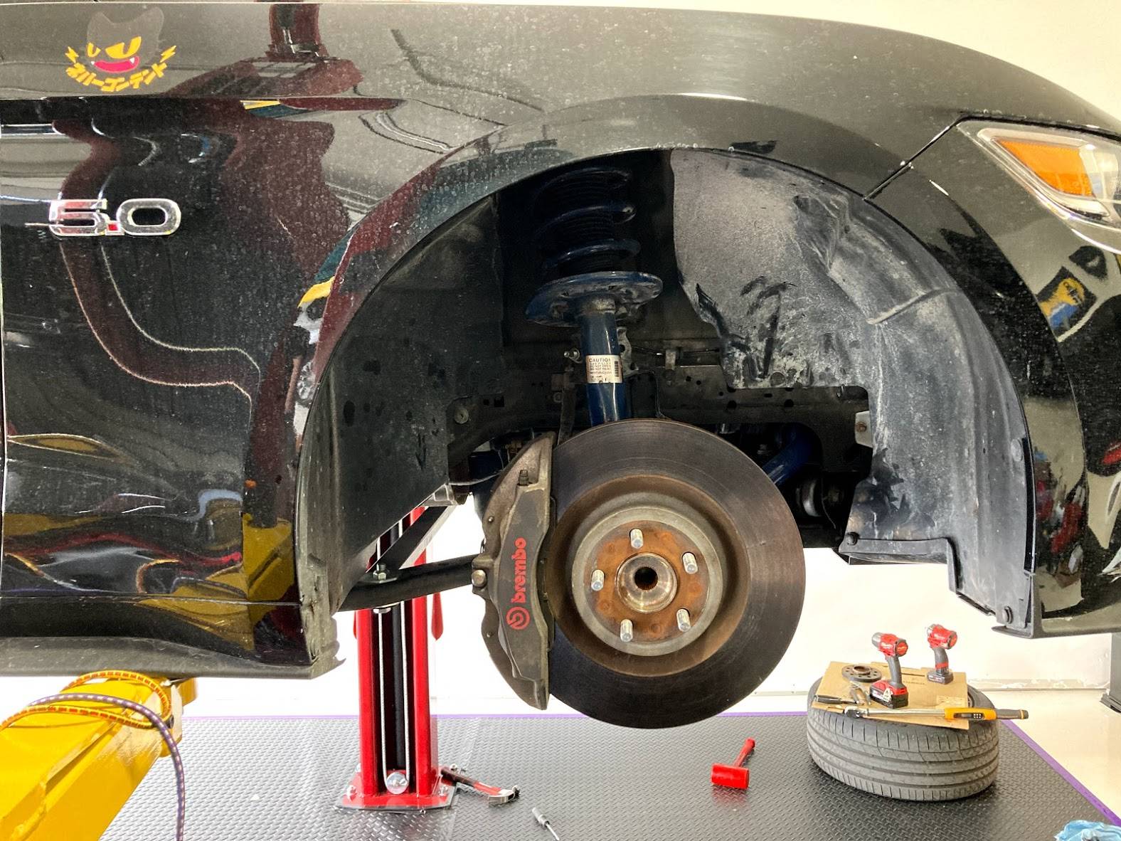

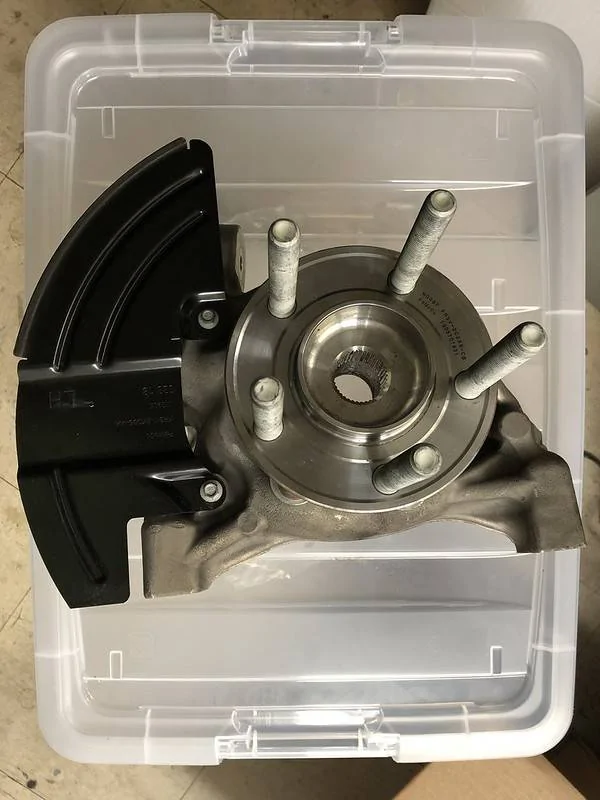

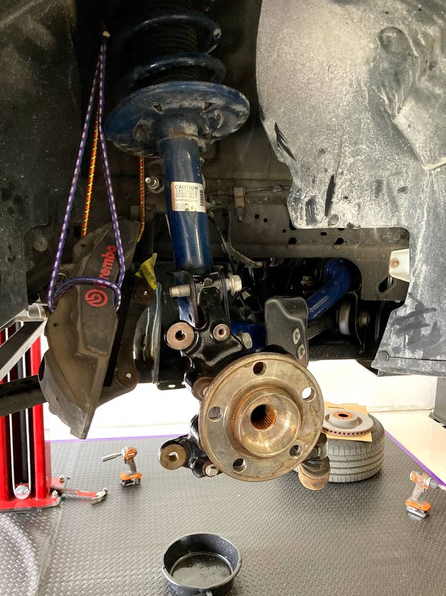

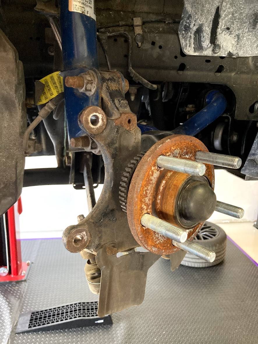

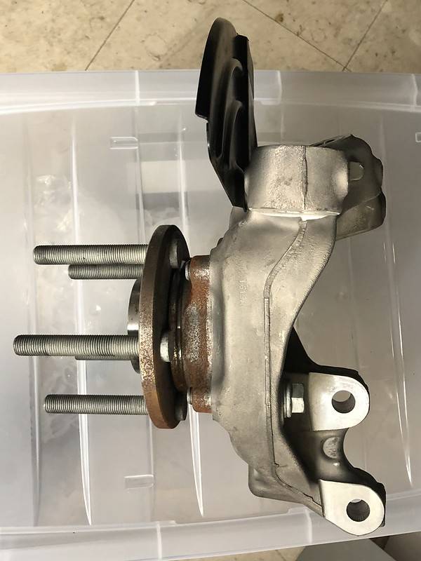

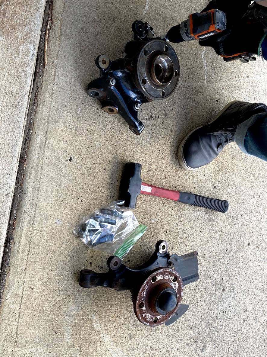

During this weekend, I put on the Magneride Front Knuckle I've sourced from the Parts Farm. Some pics:
Before:
Comparison:
After:
I have developed clunks in my front wheel hub, so the first impression is: the clunk is finally gone. Besides that, I have the benefit of a stronger Shelby-spec wheel hub that takes more load and provides more front-end stiffness, both vertical over bumps and lateral in the corners. My dead center in the steering is also gone. I don't know if it's the good hub or the beefier front axle, but anyway.
Some remarks:
  • The ABS sensors are different from the non-magneride mustang! If you don't have them, make sure you buy them off somewhere! I got mine from Rockauto. The good thing is that all mustang ABS sensor-hub combo has the same connection and sends out the same signal type. No need to program anything.
  • These pieces are stupid expensive currently. I lucked out and caught them off the parts farm, but the new knuckles are around $400 per piece, and hubs are around $200, so $600 per side. Why, Ford, if I may ask??!! Anyway, the part number for the knuckle w/o the hub is JR3Z-3K186-A and JR3Z-3K185-A, and the one for either front hub is FR3Z-1104-F.
  • The wheel hub can clunk while still feeling fine if you rotate them by hand. My faulty one spined fine, but the viscosity of the grease wasn't quite there compared with the new hubs. I guess it would only show symptoms while under load. So when your suspension starts making noise, if you can't tell anything by an examination, use some logic to help you navigate the faulty part. I live in Michigan and drive offroad every day, so bad wheel bearings are not a surprise. SMH
  • New observation: these knuckles themselves seem to add around 0.6 degrees of negative camber. With 1 inch drop and without touching the camber plates, my front camber went from -2.6 to -3.2 degrees.
