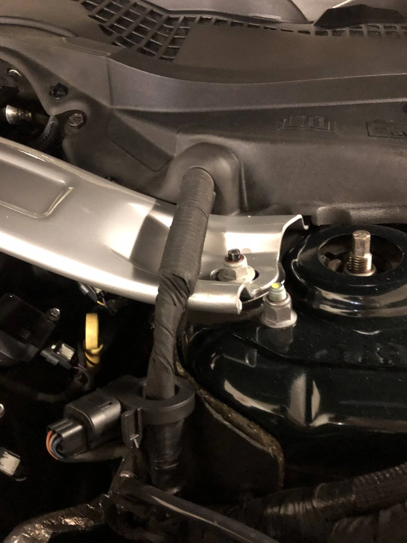

Just interested - do you have a picture ? I wonder if ford messed with the stud lengths ?
WD :like:
dpollard
Dec 15, 2019
38
Leeds
2020 Bullitt in Shadow Black

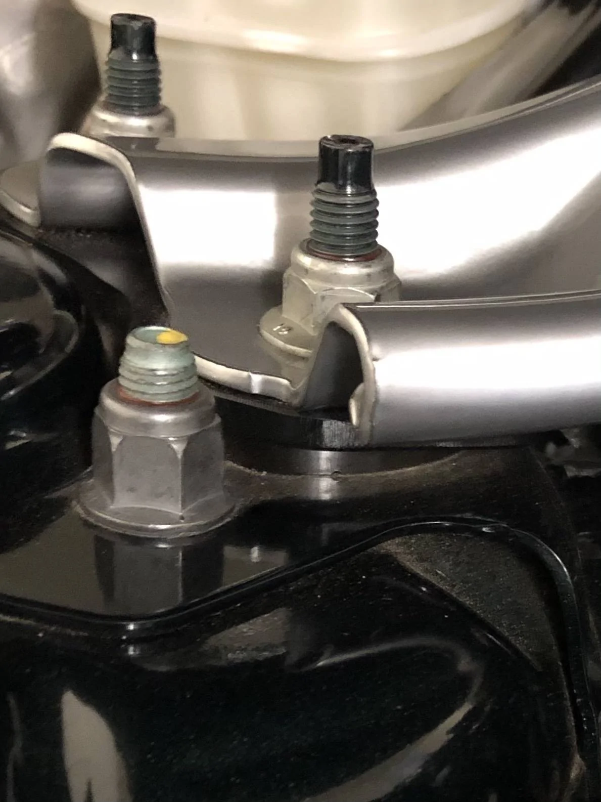

Funnily enough, I do.
You can see that the studs on my Mustang are also painted black. The nyloc plastic taking up the thread, leaving just the unthread part of the stud exposed. You can see the washer underneath the brace in this photo.

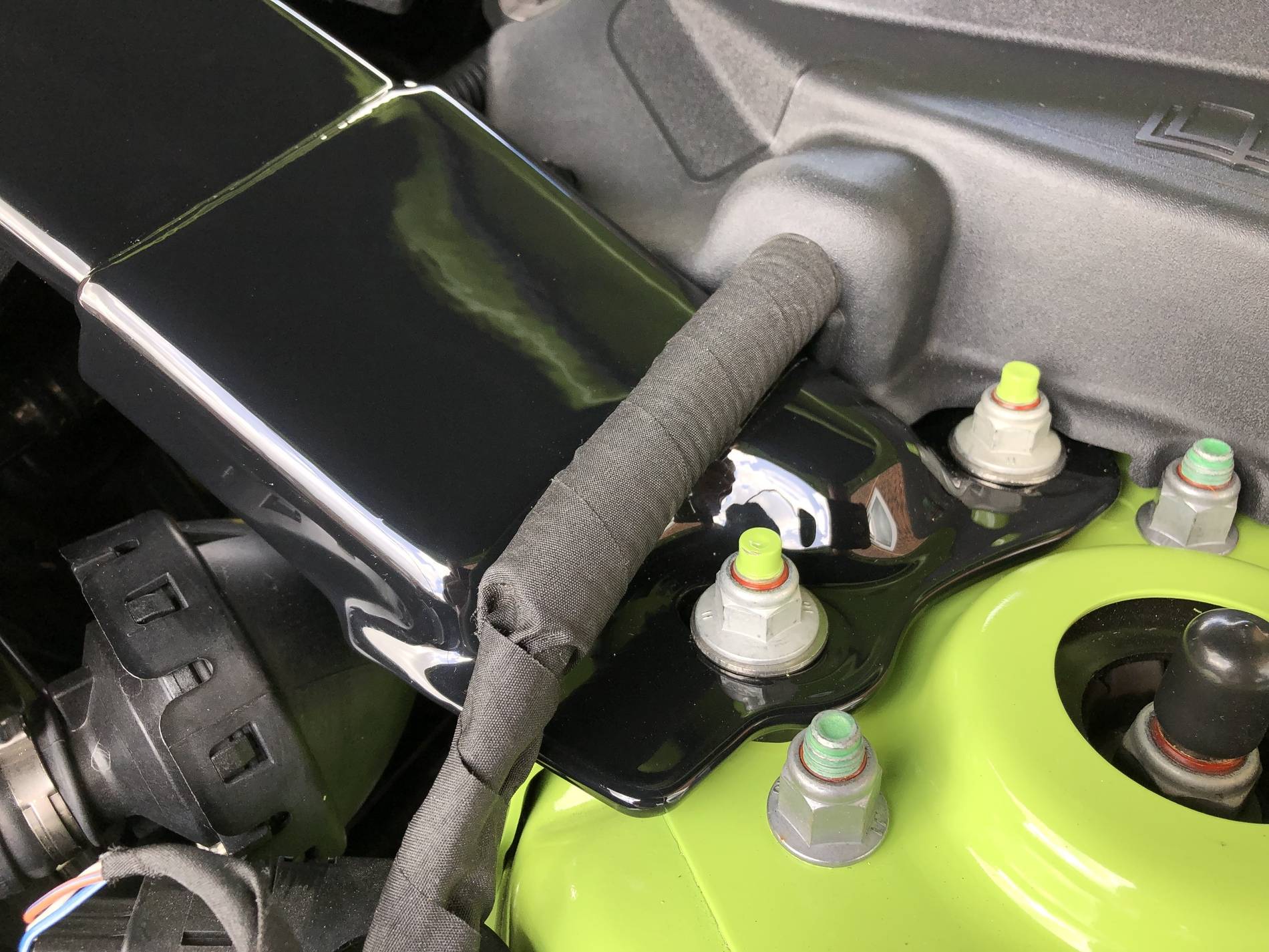

Yeah that’s good, I have a little more engagement (full thread exposed) but not as much as you would expect - must be a tolerance thing and the extra thickness of the 350 aluminium brace :like:
Not quite sure how either option would work though with the 8mm spacers that Ford supply …
That pvc tape section on the loom can be removed if you want - the fabric tape underneath is a continuous run :like:
As a side note, mismatched spacers would do my head in - buts that just me … :facepalm: :giggle:

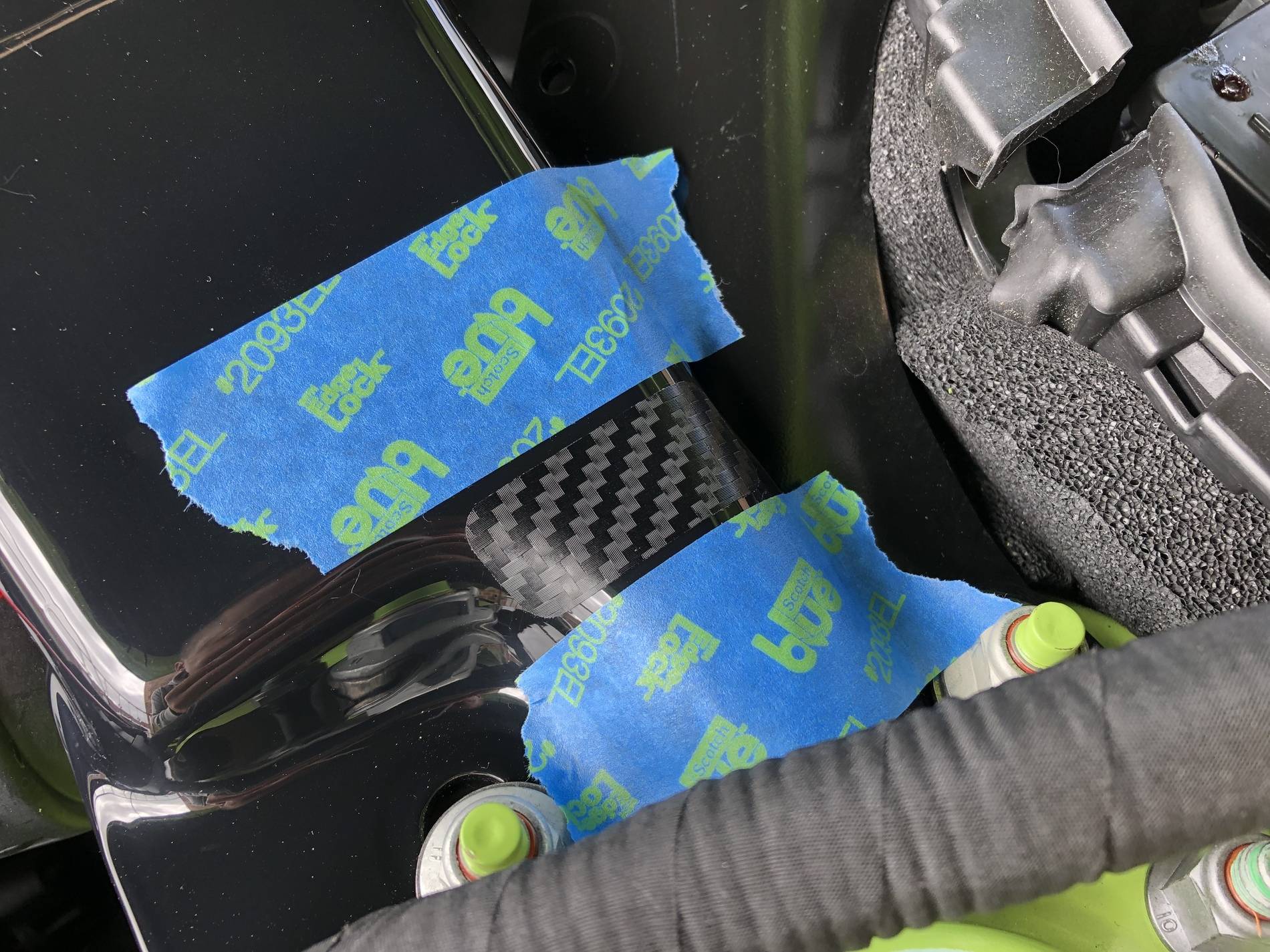

Yeah, I used one of those bike frame protection patches under the battery cable :like:

No, it might just be the carbon pattern or that it’s on a curved surface that it throws your eye off - it’s a simple rectangle with rounded corners :like:
Barely visible once fitted and at least it provides a little sacrificial protection that’s easy to replace :

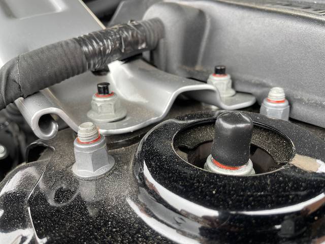

Another consideration for the passenger side - The locking part of the nuts won’t engage on the studs if you use the spacers :like:
WD :like:
So is there a way around this? Seems odd that FP would provide spacers that don’t allow the nuts to lock properly.
I am thinking of importing a brace from the US which is a hell of a lot cheaper than buying one from a dealer here and them just drawing up the spacers and getting them laser cut. how much short of hitting the nylon are the nuts with the factory spacers and would 6mm thick spacers still work as well as fix this issue?

Sorry for the late reply :like:
I suspect a few things are going on here, all comments are my ā€˜opinion’ :wink:
  • I suspect the steel brace ā€˜might’ be OK due to thinner material.
  • In my experience, the ally brace defo wasn’t ok due to the thicker material.
  • I wanted the brace mounted low so I choose to modify it.
  • My powder coat job (after brace modification) was thicker than fords, that wouldn’t help.
  • I suspect some people are happy without full nyloc engagement, some are happy with no spare threads and some want to see clear threads (like me) at the end of the nyloc - that’s a rule that the SVA inspectors use in the U.K. (min 1.5 full threads).
  • Maybe there’s slight variation from car to car ?
I’m not sure if you would get away with a spacer thinner than what Ford supply ? Maybe they air on the side of caution.
At the end of the day even if the nylocs worked loose, it’s going to rattle rather than be safety critical :like:
Unless you have access to a laser or water jet cutter, I think stainless stand off spacers of the chosen size would be a cheaper option and they are readily available on eBay :like:
Hope it all works out for you whichever option you choose :like:
