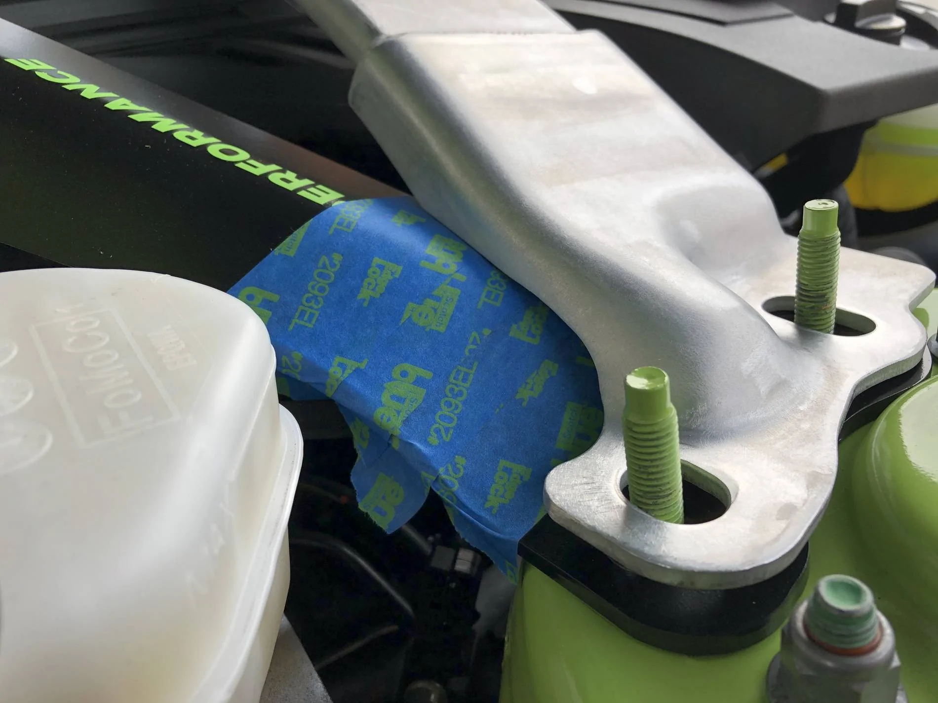

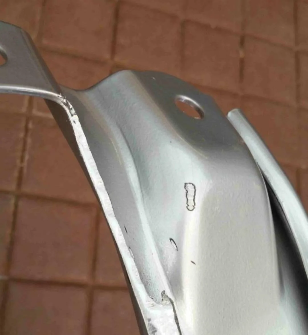

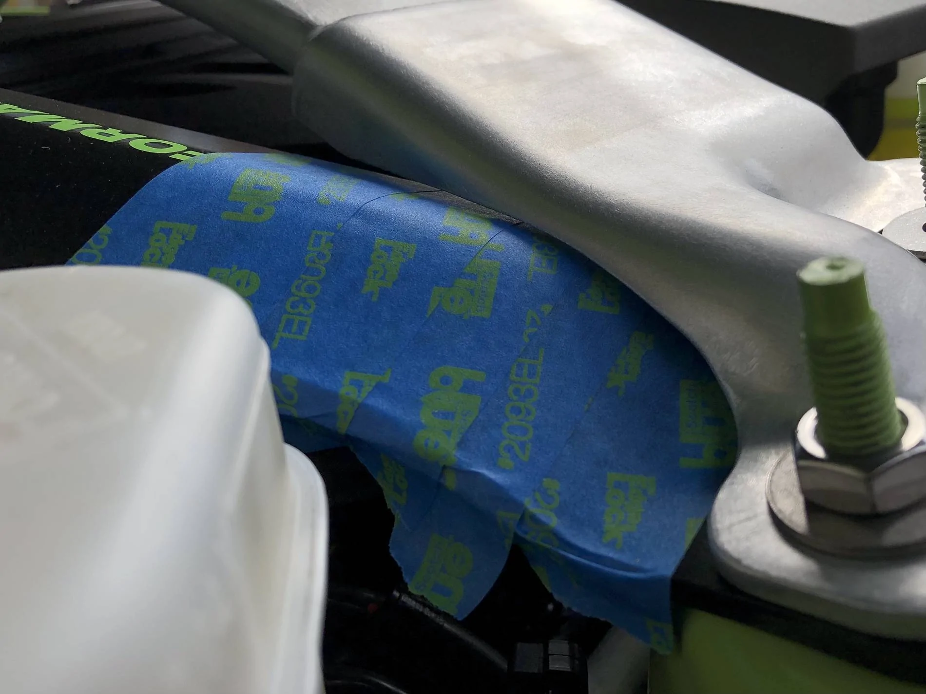

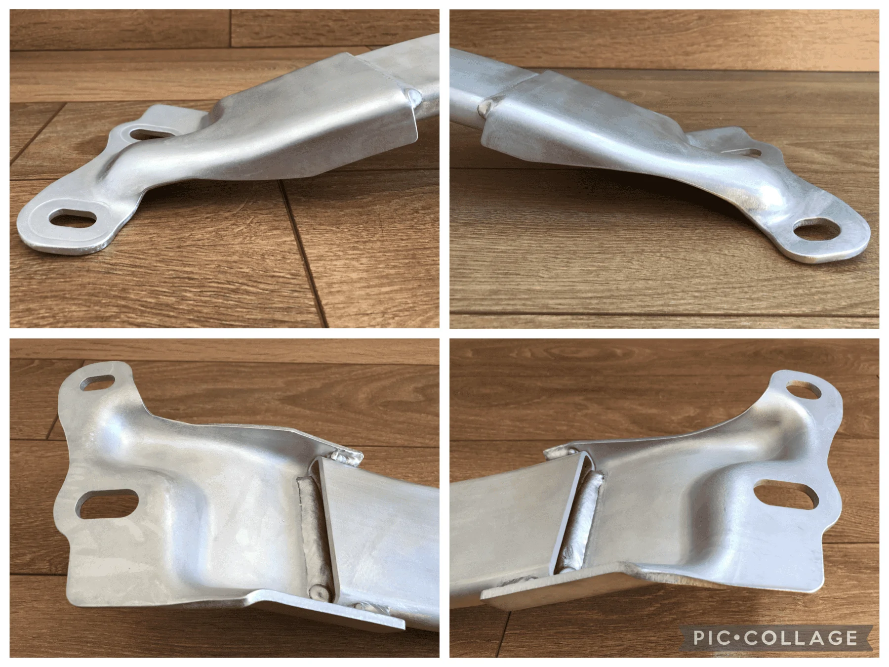

RHD cars either need 8mm spacers under the brace (as supplied in the Ford kits) or they need the grinding mod shown above to clear the RHD cowl brace.
The ally 350r brace will also fit, here is the grinding mod on one of those, both sides shown for comparison :
The problem :
The fix :
WD :like:

And if you don't fancy grinding strength away from the brace, the other way to mount is to add washers under the brace. 5mm thick on the near side, 10mm on the off-side.

Another consideration for the passenger side - The locking part of the nuts won’t engage on the studs if you use the spacers :like:
