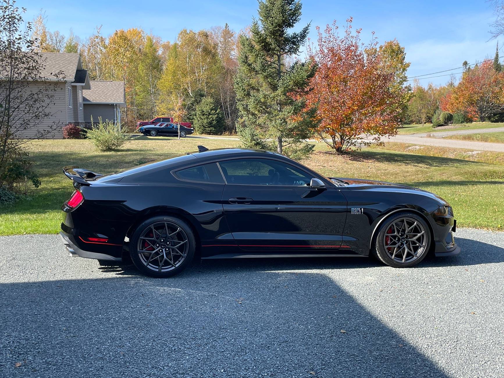

Steeda sport progressive gave me about 3/4ā€ lower,
with the camber plates dialled in, the stance is very nice
Car looks perfect!

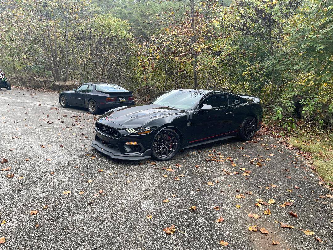

I used Steeda dual rate magneride springs on my 22 HP as part of the competition package (with sway bars). Also swapped out the Ford Perf camber plates for the Steeda units for more negative camber. It lowered mine +/- 1/2". I don't have any chin spoiler clearance issues around town - just be conscientious of speed bumps.
Car rides very well when cruising and is much more planted during spirited cornering.

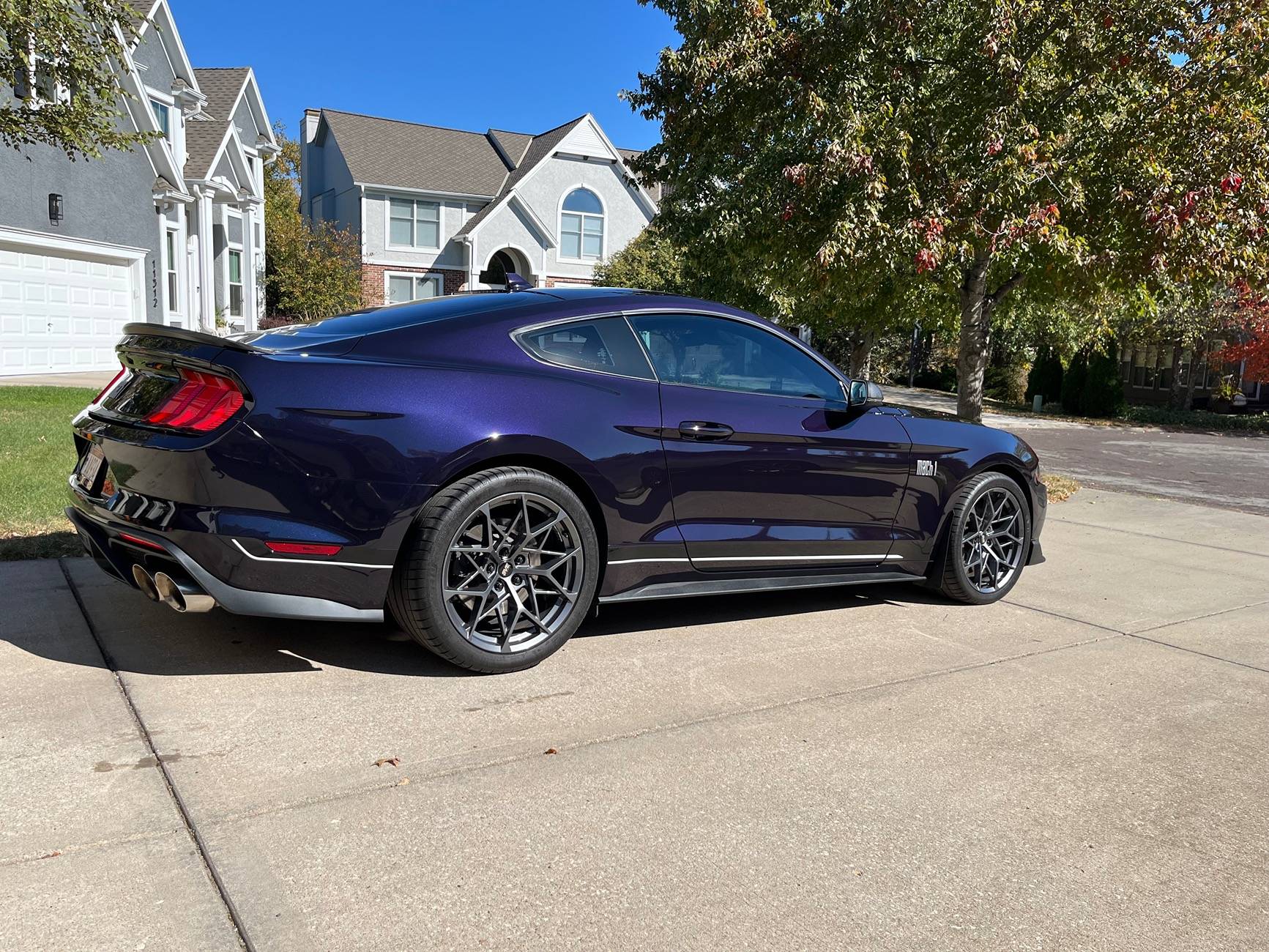

I’m having the ford performance W springs installed for $1050 including alignment. They had it all day yesterday but didn’t finish😳😬.
is there a little extra negative camber available without tire wear? I didn’t install plates since there’s no track near me. Happy Friday!
