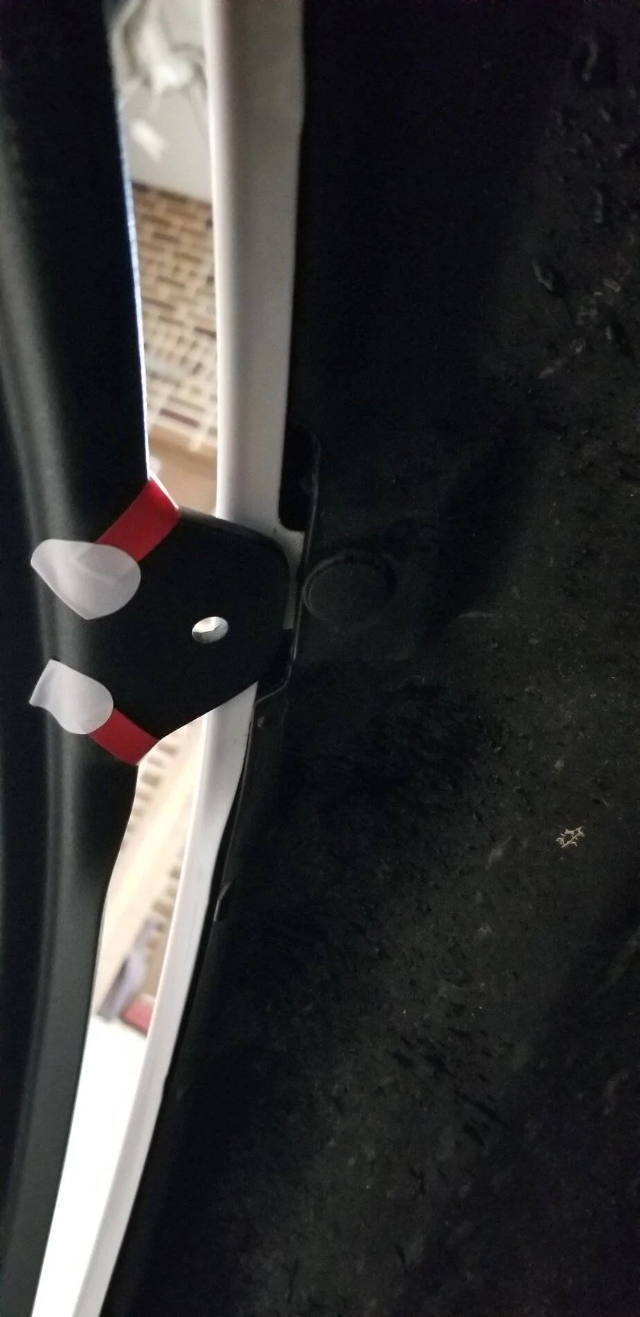

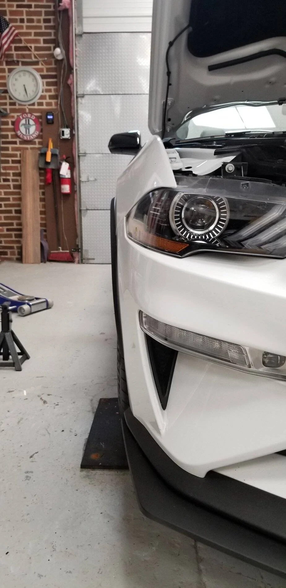

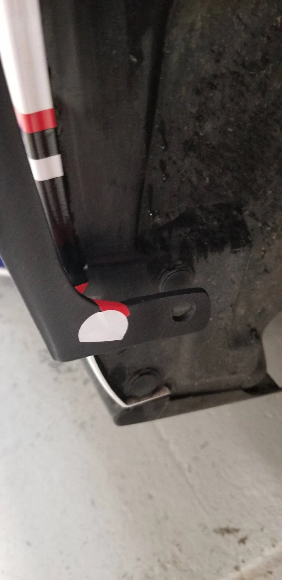

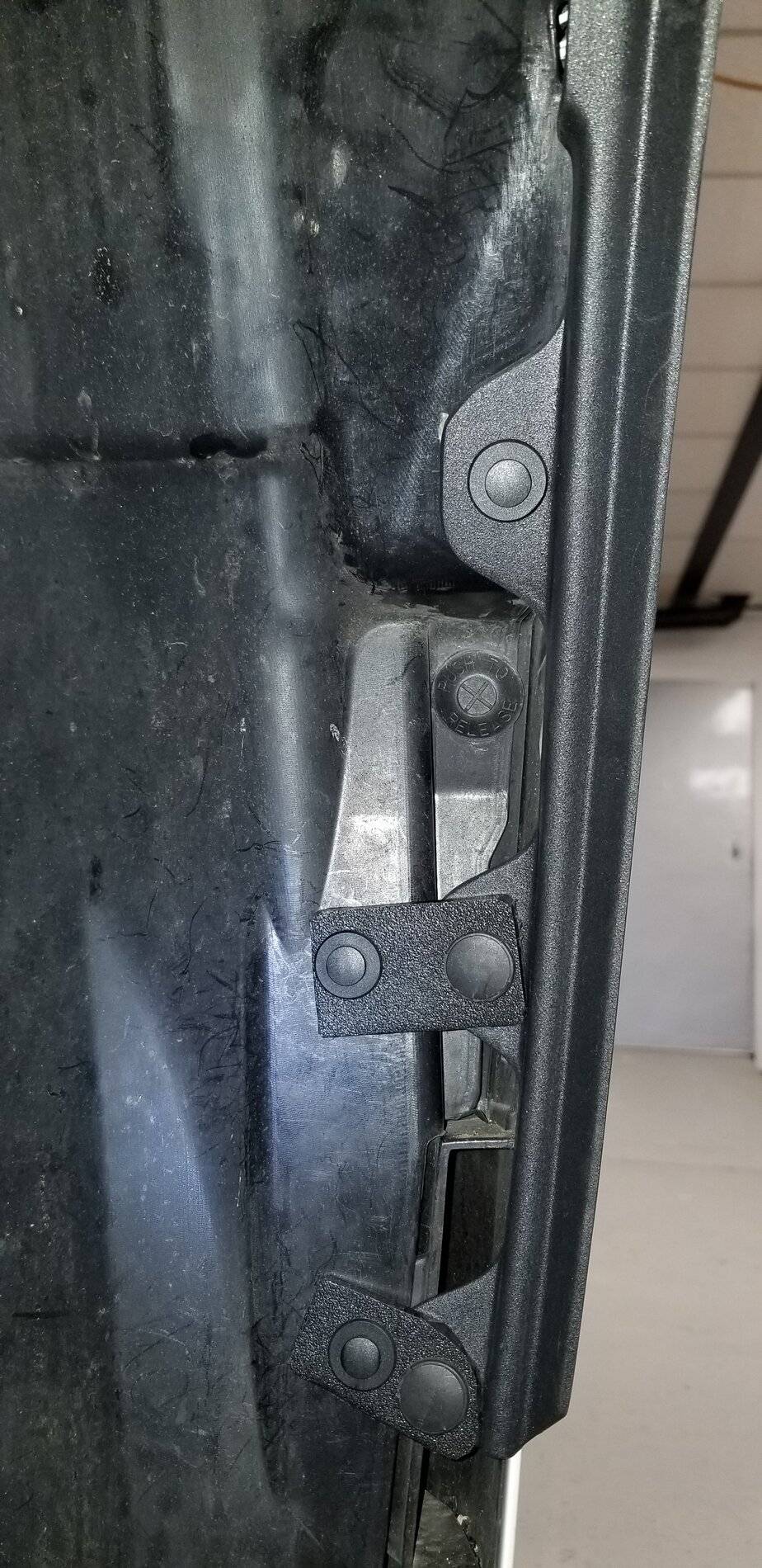

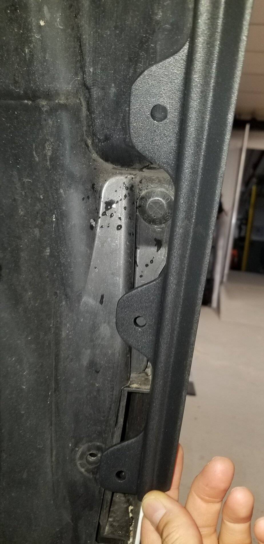

So here's how it worked out on a '19 PP1...
Out of the 5 push pin locations, 2 were a perfect match. The 3 fronts needed either splice brackets or a new hole drilled. Used a piece of leftover fender flare plastic for the splices. In the end... it's a great fit. I ordered some $25 winglets from AM to fill that 3.5" void up front. This mod is purely cosmetic at this point. However, it will definitely cover some PP2 wheel poke and cover other wide offset wheels.

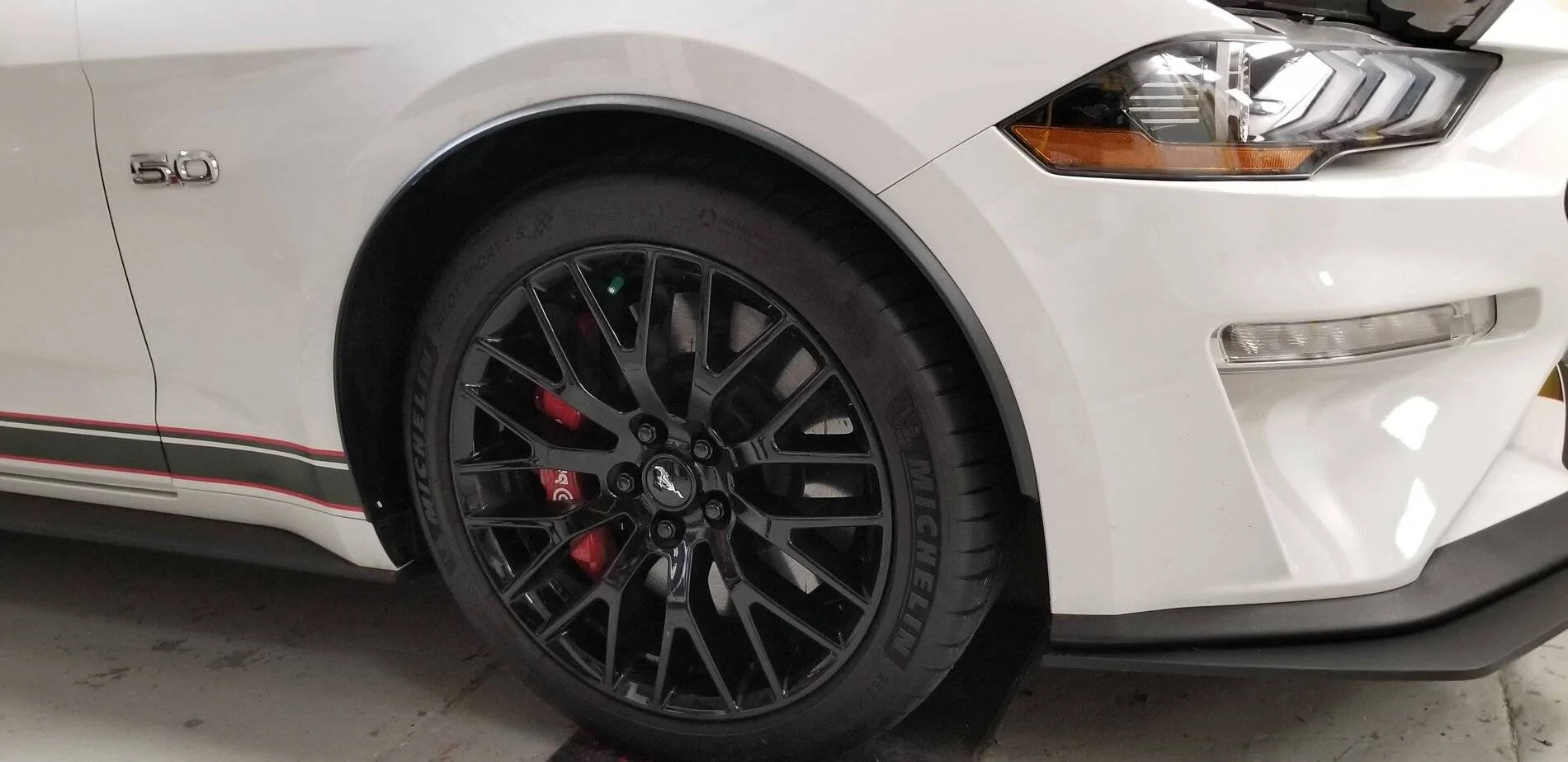

Yup I got them. Oem Mach 1 fender flares. Took a month to get them in from my Ford dealer. Shout out to Zach @Peoria Ford here in Az for hooking me up.
I have a 15’ with a roush kit, gt500 rockers, and gt350 rear valance. So we will see what needs to be done for fitment. Bare with me as I will have to wait a few days to install them. My car has bowed out front fenders from the previous owner bagging the car with the wheels turned to one side (bastard) Im waiting on paintless dent removal to be completed. Until then I took some pics of the flares.
