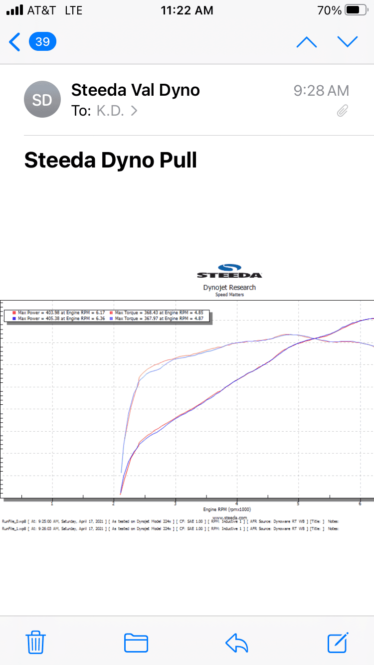

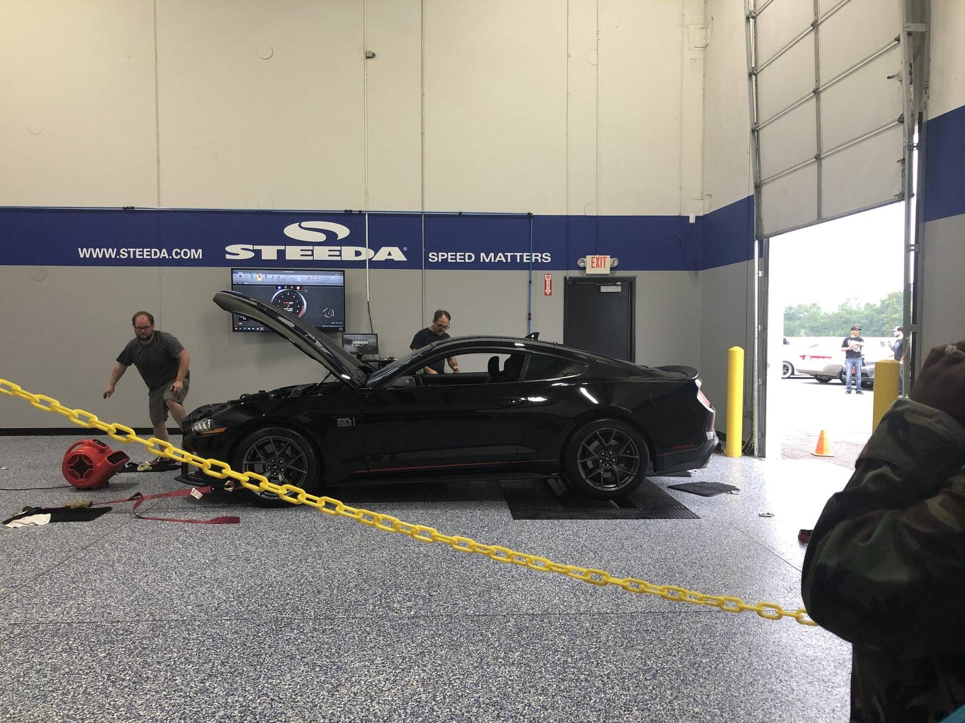

Well the stock Mach 1 with the A10 and H-pipe put down 405rwhp and 368tq it was a little less than I thought but I can never say enough great things bout the people at Steeda. They treat everyone great and are like family. Thanks again to Matt, Chris, Jamie, Scott and Julia

Uhh, why did they stop the pull at 6300rpm? The engine power peaks at 73-7400 with the GT350 manifold.
Pull that thing to redline and you'll see another 15-20rwhp.

Damn good question, I didn’t even notice. Let me find my sheet..
Thx for input bro

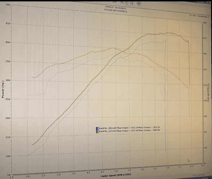

Looks right in line with a Bullitt. Seems like Ford didn't adjust the lowr powerband any. Even at around 3000 RPM it looks inline with Tuning By James' Bullitt dyno video for Steeda on the same dyno.
Looks like thy DID tweak it around 5250-6000 RPM through the Bullitt has a little bit of a dip there right where the TQ and HP cross, and then takes a little to recover. So, it seems they may have tweaked and smoothed out the top end.
Blue is stock.

This is 15% loss to rear wheels, makes no sense.
My 15 Dino’d at 407hp with a Steeda tune and intake
This is pathetic and I’m trading mine in tomorrow!
Ha!
The MT-82s only lose about 11%, I’m sure the Tremec is similar, and they’re absolutely right, the dyno ended way too early. I expect the car to put down ~420-435 at the wheels stock and properly corrected, just like the Bullitt.
