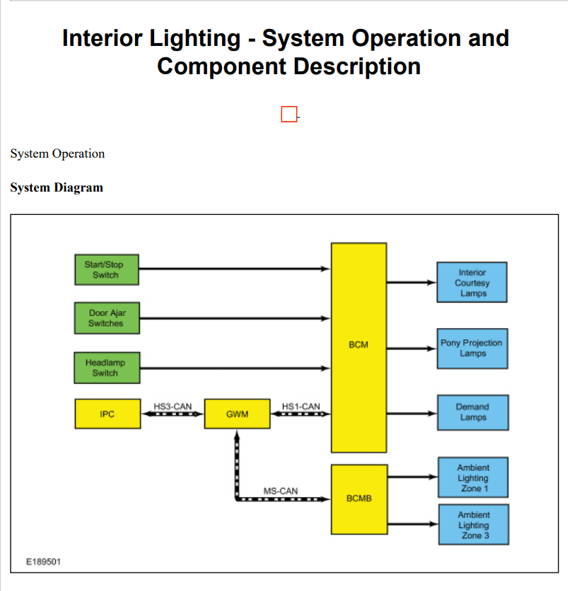

My apologies for the late response! I had a few things come up the past two nights!
I did find a flowchart that shows the components for the ambient lighting (MyColor) which is being reset. I'm willing to bet your issue lies within here.
When you set your ambient lighting, it is done through the IPC. It will then send the data over the HS3-CAN to the GWM. Then the GWM passes it to the BCMB over the MS-CAN to the actual lights. Your GWM is your Gateway Module and the IPC is your Instrument Panel Cluster.
Another page I found in the service manual says the BCMB (Module Address 7B7) controls your RGB entry lighting values, while the BCM stores them there and a backup is kept in the IPC.
It seems like the BCM might be faulty - I'm curious if they couldn't see any error codes in it or any other modules.
Nevertheless, I'll keep on reading and see if I can narrow it down.
Thanks for the info, that would make sense. The car was retaining all personalized settings when I looked at it originally. I believe they performed a recall with update to BCM before I picked it up.
I'll have to get a hold of the dealer again and book an appointment once more.
