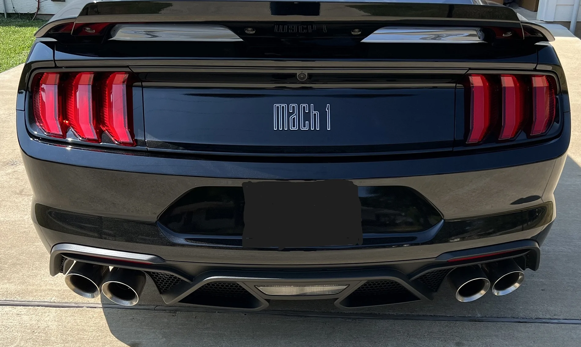

I have it installed on mine. I did 2018 up bumper, various brackets and all the jazz. The valve motors are modded to allow for control. Looks like a Mach 1.

That looks great! Any idea what the total cost of the conversion ended up costing you? Also, I thought you had to swap the 2018 taillights in, as well?

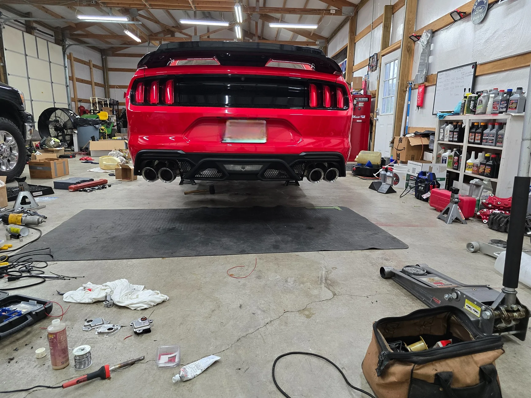

The exhaust kit was around $1600, the bumper was about $700, and the misc brackets were somewhere in the $200 range. I bought most through Levittown and my local dealer. The tails are not required but I eventually went with them anyway.
The front conversion was a whole lot more! :D
