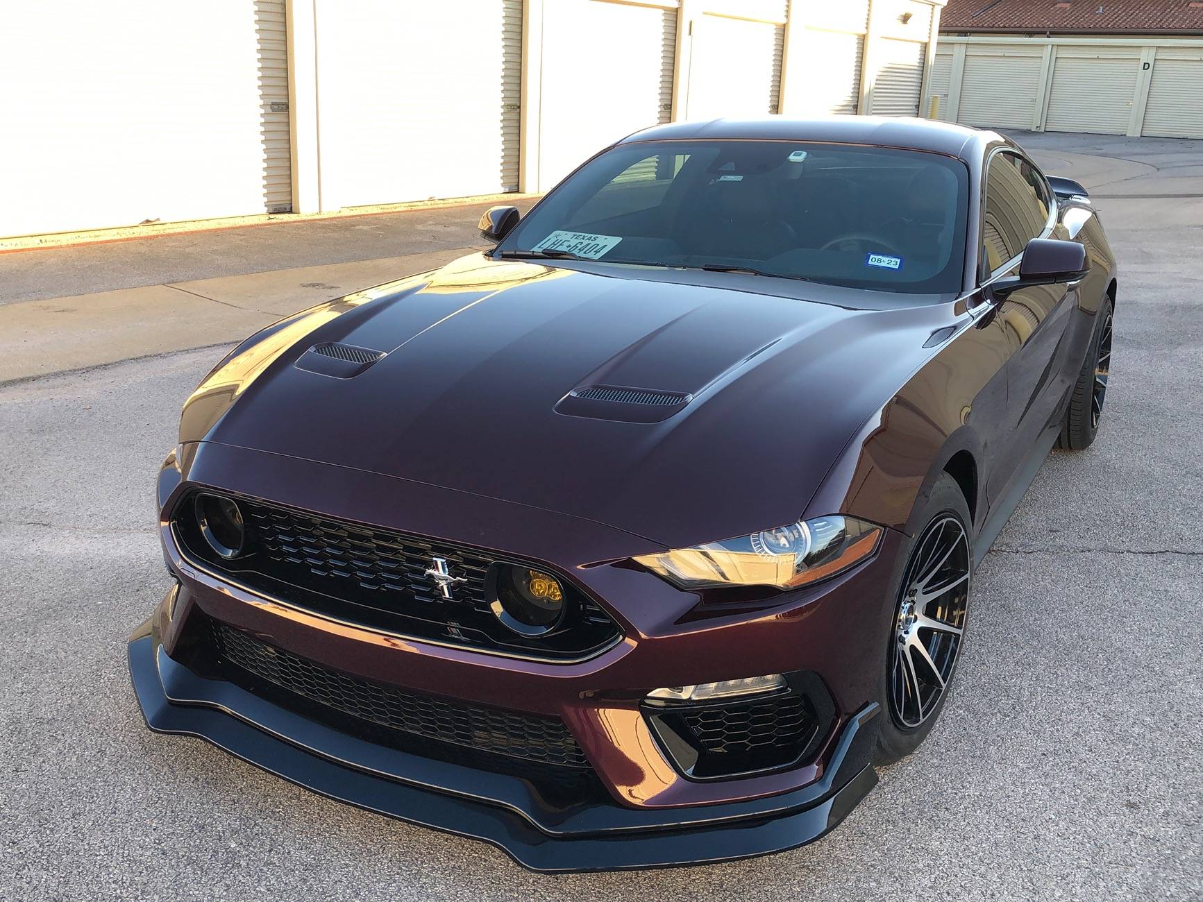

It is not really difficult per se. But it takes precision, plenty of work space and act of bravery. I laid both bumper covers (OEM and 777) on the floor (if after painting, make sure to use large styrofoam sheet or some thing to protect the paint, of course) side by side then, first, marked the position of the turn signal assembly brackets on the 777 bumper cover with bright-colored sharpie (silver works well). Then I pulled and cut off the brackets from both bumper covers. Made paper stencils off of the 777 bumper cover to transfer the bracket attachment position onto the OEM cover -- this was the hardest step for me. I used 3M Industrial Plastic Adhesive 4693H (available on Amazon) to fix the brackets and then later plastic-welded them. Side vent inserts, OEM and 777 ones, are interchangeable -- so there is no problem using 777 side vent inserts on the OEM bumper cover. That's it. I used Diode Dynamics 2018-23 turn signal assembly, which has fog lights and can be used as white driving lights. With an adaptor that goes between the headlight assembly and its plug, you can use the the DD turn signal assembly as extra driving light without tapping into the original wiring. You want to be very precise in transferring the bracket attachment position.
