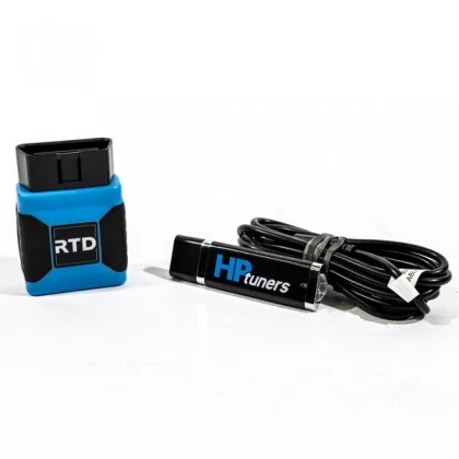

I am about to pull the trigger on a flex tune from lund with the HP tuner. I am assuming i will not be able to change the tune on the fly (like with the Nguage). Just wondering if i always need a laptop handy in case E85 is not available.

You need a laptop with the RTD. There's no way around it.

I will say it loads fast, but yeah the whole laptop portion is def more of a PITA. Once again, at least it loads fast. I just leave the files on my desktop, then you fire up the laptop, the software, plug the RTD in to the port and to your laptop, and then write file.

Other devices like SCT you can still load on the fly with no laptop so if the convenience is a factor you could consider a tuner that utilizes SCT. But as others have said it's not a bad process to use the laptop either.

would buying a used Nguage still be an option? Im just Leary about buying used electronics. Using the laptop is not a deal breaker by any means but it seems like the convenience of the Nguage would be nice considering E85 isnt abundant.

If the nGauge tanks, Lunds RTD can flash over the nGauge flash with a stock tune, or whatever aftermarket tune they gave you. I was going to keep the nGauge, but someone offered me cash for it so I said "bye".

The tunes from Lund are locked so you won't be able to edit them. At the moment you will need a laptop to load the tune onto the device and into the vehicle. Same thing for transferring catalogs from the device to a computer. Without getting into it too much as nothing has officially been released the requirement for a laptop with the RTD will be changing here shortly. Lots of good things coming out from HPT regarding the RTD. So if you get one now don't worry as these features will be available for all RTD's purchased in the past as well as the present.
