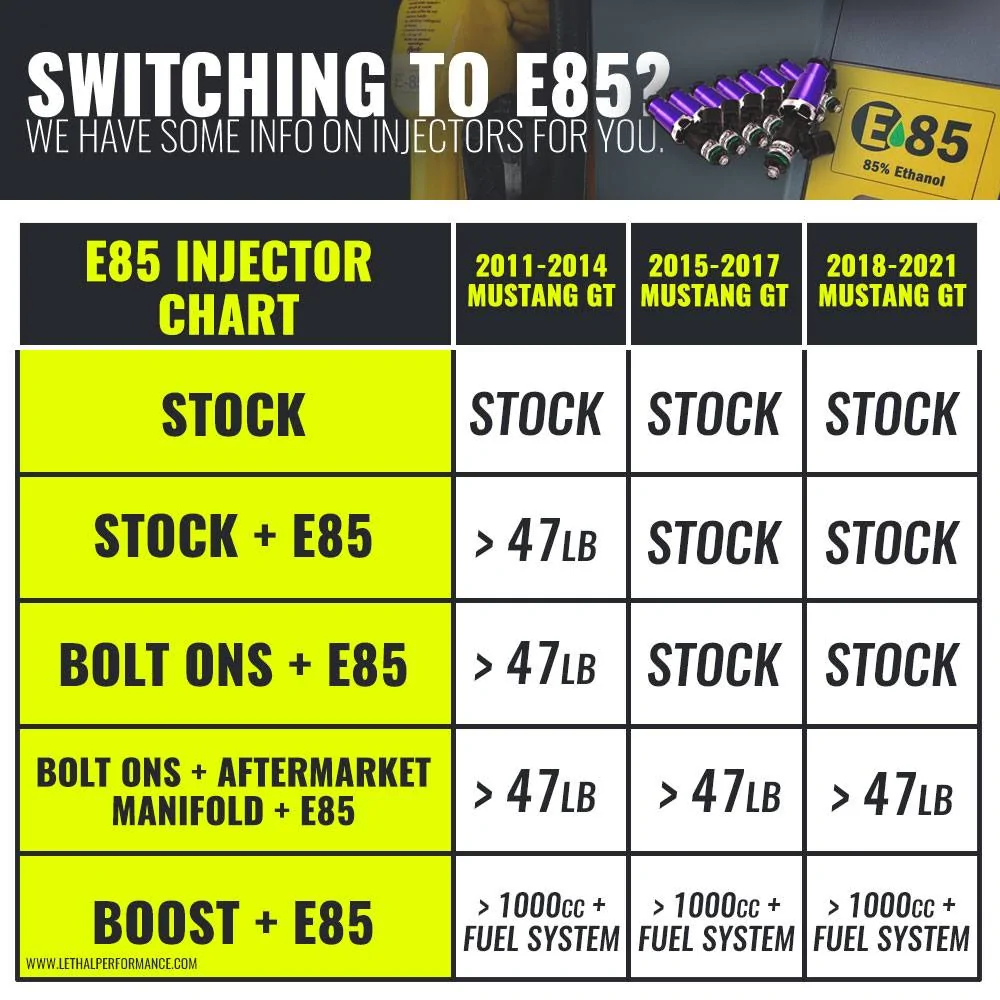

Are the LU47 injectors an upgrade over the stock injectors for an NA, full bolt on, e85 build on a gen3 coyote? Would there be any benefit from swapping them?

I would consult with your tuner on this one. However from our experience dealing with several of the top tuning shops in the country the Gen 3 only requires the LU47's when going full bolt on with an aftermarket manifold or when going forced induction. Here's the cheat sheet we use.
https://www.lethalperformance.com/i...uutK7CKCRdEC6vz4TjwMftSJqh-A6YJ1lp9rYxmM#gen2

you will not gain any power if that's what you are asking
