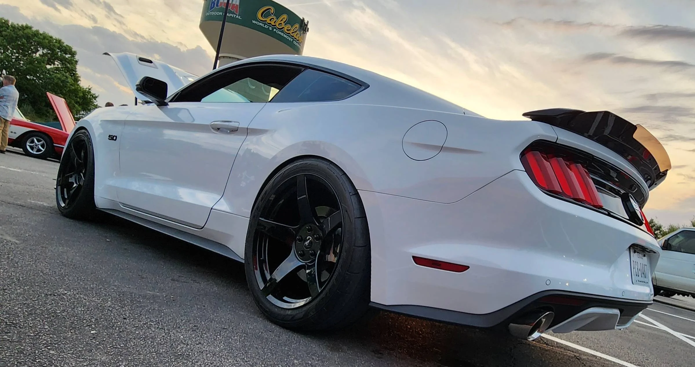

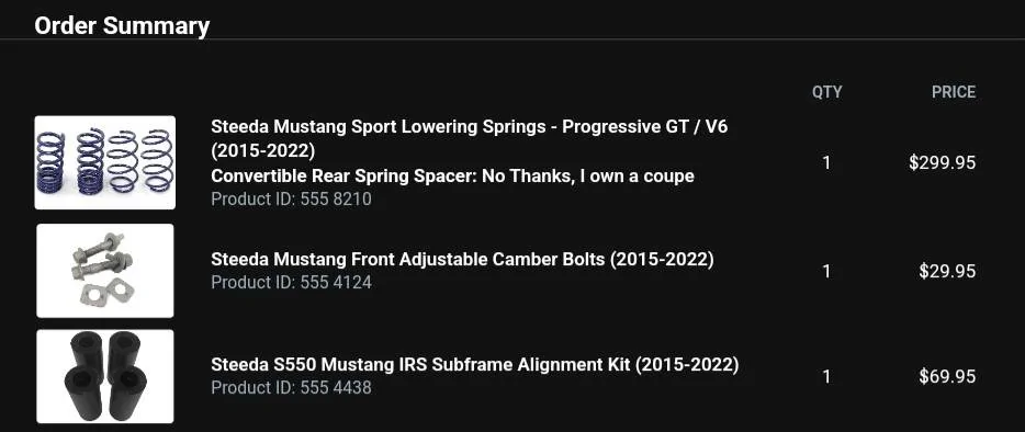

Get you some Steeda Progressive lowering springs, subframe alignment kit, and camber bolts.
Lowered the car 1" in the rear and 1 1/4" in the front. Honestly I wanted lower at first but after everything settled I'm extremely happy with the stance.

I’m doing this more for stance. But bro u named like every part in the suspension that’s gotta be like 2 grand
