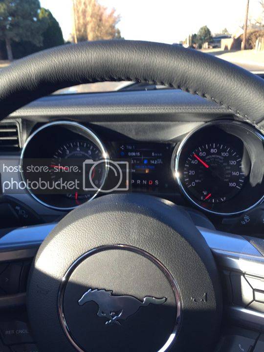

There is a gas light lights up. It's near the odometer. You can see how low I had to be for it to light up. Damn dealer didn't leave any gas for test drive

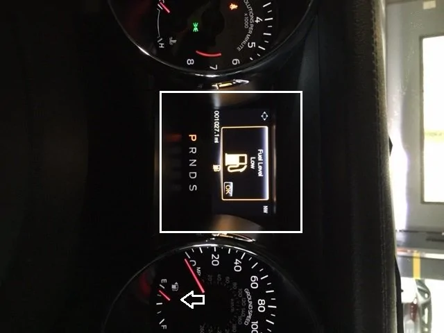

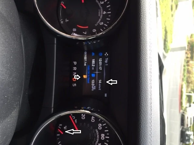

2015 GT Premium DIB 401A
I have no idea why the Taurus starts warning at 35 MTE and even has a user config to set it to a 50 MTE warning, yet the Mustang is so much lower. The attached shots are when the indicator first came on, on my GT. The dealer had no idea where the indicator was or when it would come on... I was told by Ford Corporate support that the yellow icon will switch to red, but I'm not going that low just to see if it changes color. I always fill up at 1/4 tank remaining and will continue to do so. This is another great idea for a PCM flash update: either a user settable warning range or at least bump it up to 30 MTE !!!

So the consensus here is that there isn't a "Low Fuel" indicator rather a message in the center information center. I had 35 miles to empty on my "Trip 1" display, and no message. I was told today that he thought it had two trigger points... the first at 50 MTE and again at 25 MTE. But he was basing that on other Ford models (not the Mustang). I know for sure that I have no indication at 50 MTE! I don't wait for it to get to 25 MTE. I have not found any way to configure this function.
yes, there is 2 triggers.
1st one will come on @ the 35-40 miles to empty, and will be a yellow warning.
2nd one comes on at zero miles to empty and it is red.
When the 1st one triggers, it makes the Nav (if equipped) show any gas stations on the map.
When the 2nd red one comes on, remote start (if equipped) does not work.
