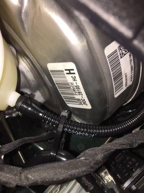

Are your cars manual? They might be leaking from the clutch line, which is super tight (should be longer). You need to push it in, add a zip-tie to the end of it (to prevent dislodging), AND zip-tie it to the metal brake line, so it's level, and doesn't pull down and out again. Mine was leaking with all of 60 miles on the clock, but not on the floor yet (thankfully). Some actually dislodge completely, if not caught on time.

On the line hooked to the brake fluid reservoir. Below is my fix. You can see the 2 zip-ties I used. Hope it helps.

You're a genius! It was definitely loose. Is it okay to top off brake fluid back to the top? I don't want any bubbles in the lines.

Unfortunately something else did happen lol. I went to check how secure it was and it the pressure pushed a bunch of fluid out, eventually it stopped. It wasn't a ton but it wasn't a few drops. I was able to get it back on. I checked the clutch pedal and it felt firm but I'm worried now it def has air. What do you think?

Unless the line was disconnected for a long time, you should be fine. And air would be at the top of the system anyway, so easily 'burped' while using the clutch. If you don't feel anything weird, it's perfectly fine. When it feels spongy, repeatedly depressing and releasing the clutch pedal is reportedly the way to get rid of most air bubbles, for future reference. Another method, due to the lack of a bleed valve, is with a pressure bleeder on the brake reservoir, but I don't like that, especially with a flimsy clutch hose attached to it, but also as an FYI. Finally, make sure to put a zip-tie at the front of the clutch hose (tightened well), as shown on my pic. Hope this helps.

You're the man. Thank you for easing my mind. I topped it off and slow pressed the clutch in out several times and while driving for a bit clutched in and out while shifting slowly for a day just to make sure everything felt fine. All seems fine and I'm gonna zip tie that sad excuse of a job well done from ford.
