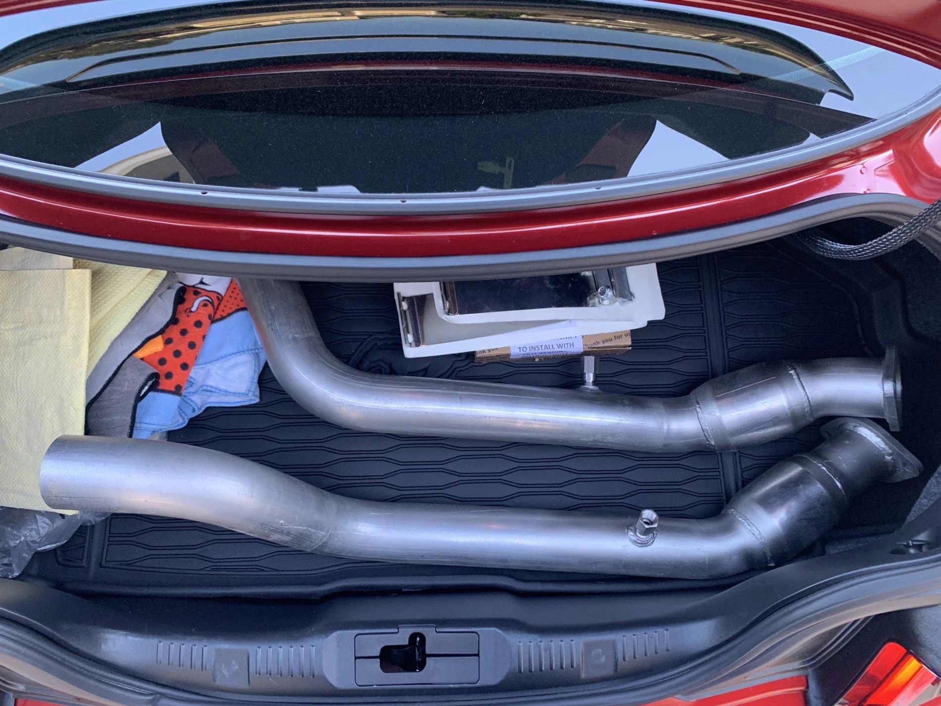

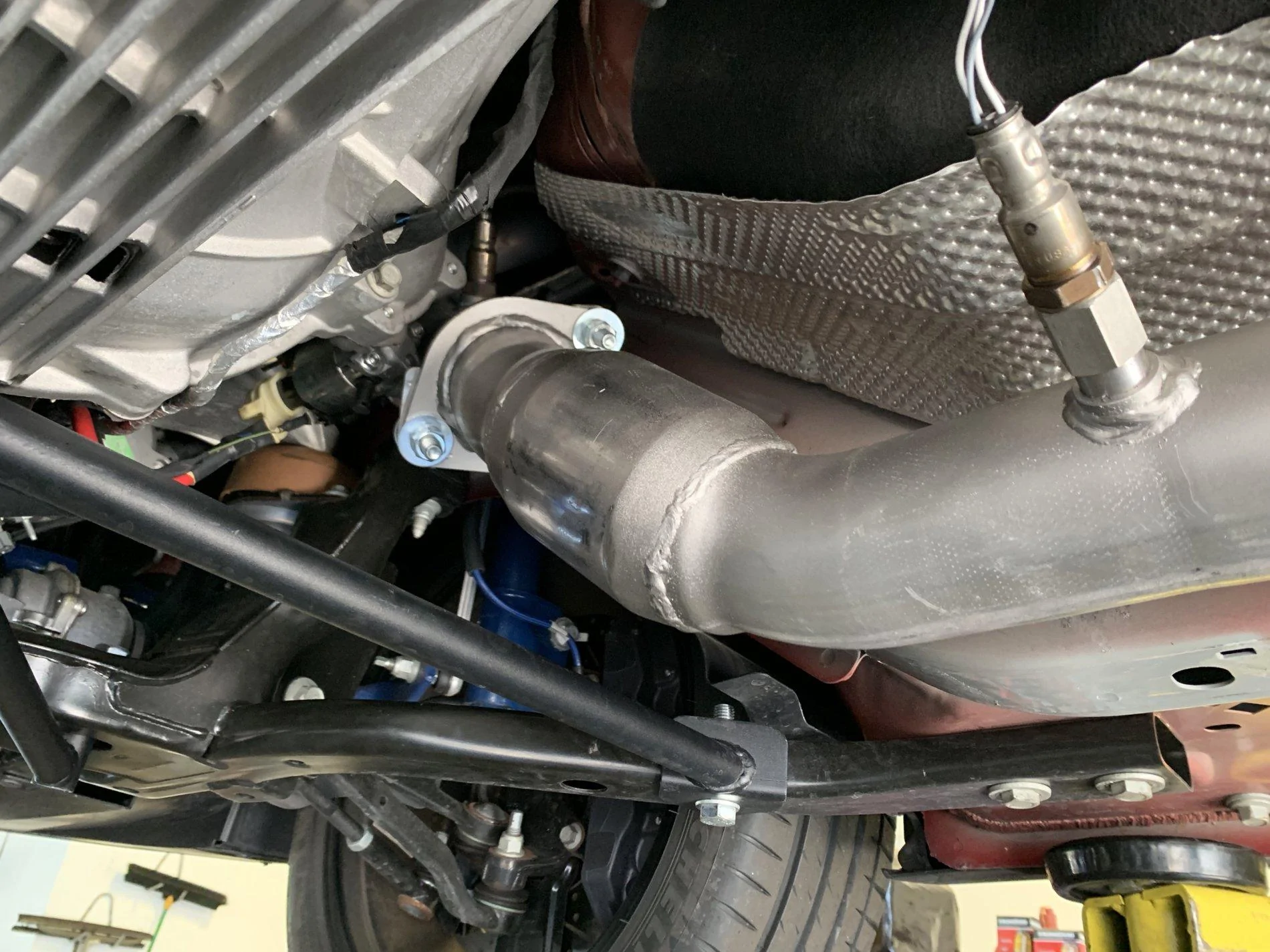

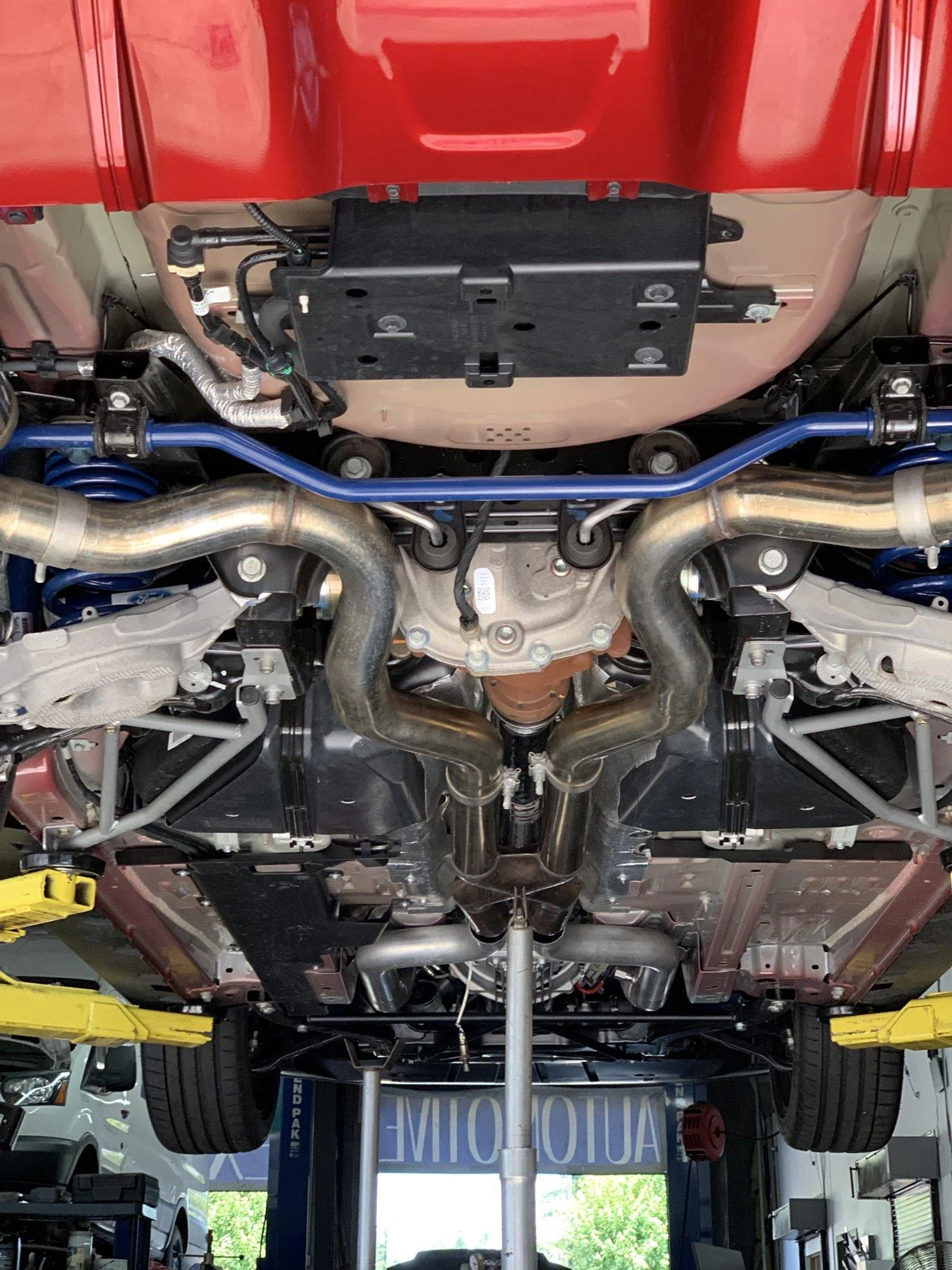

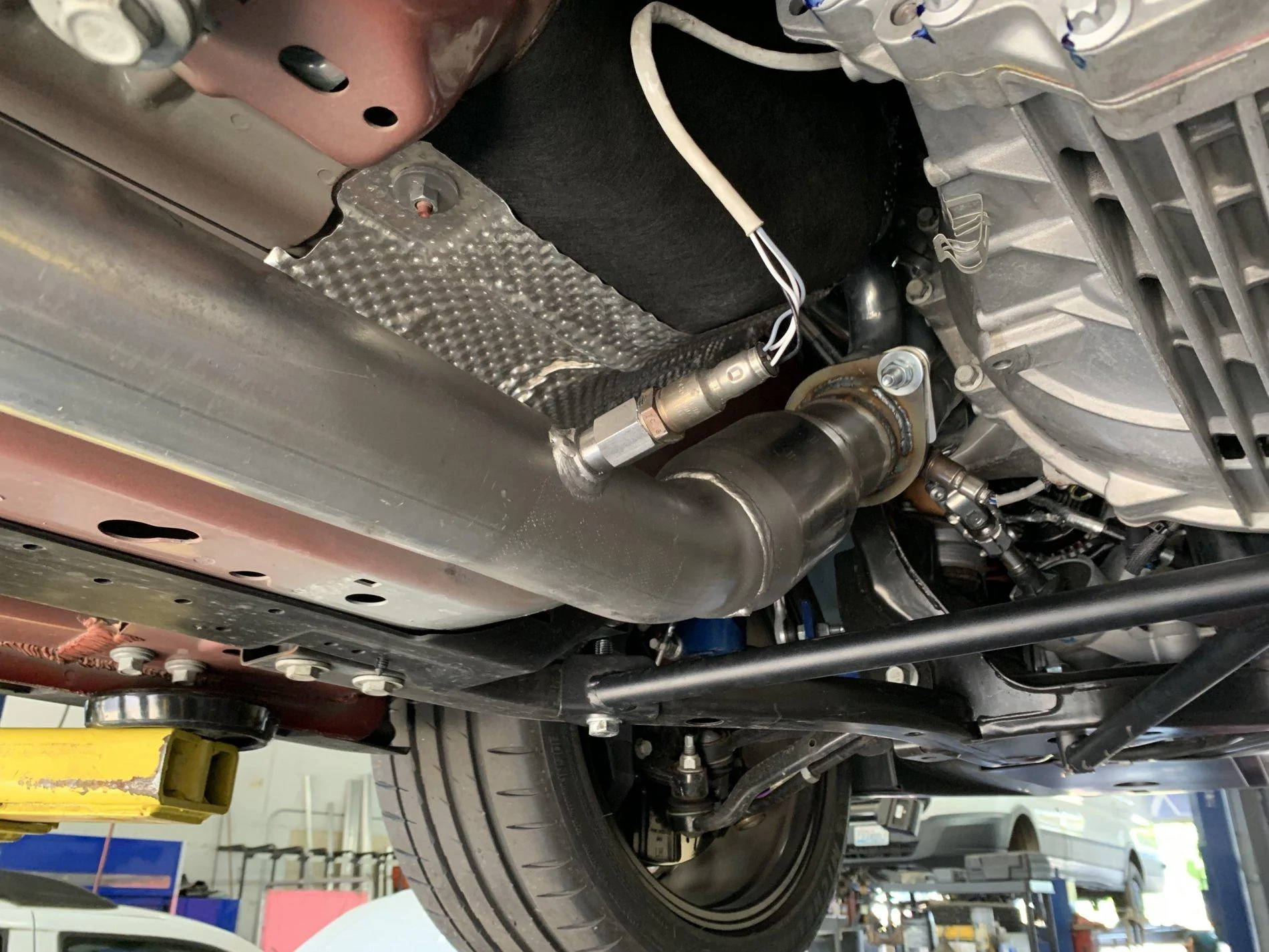

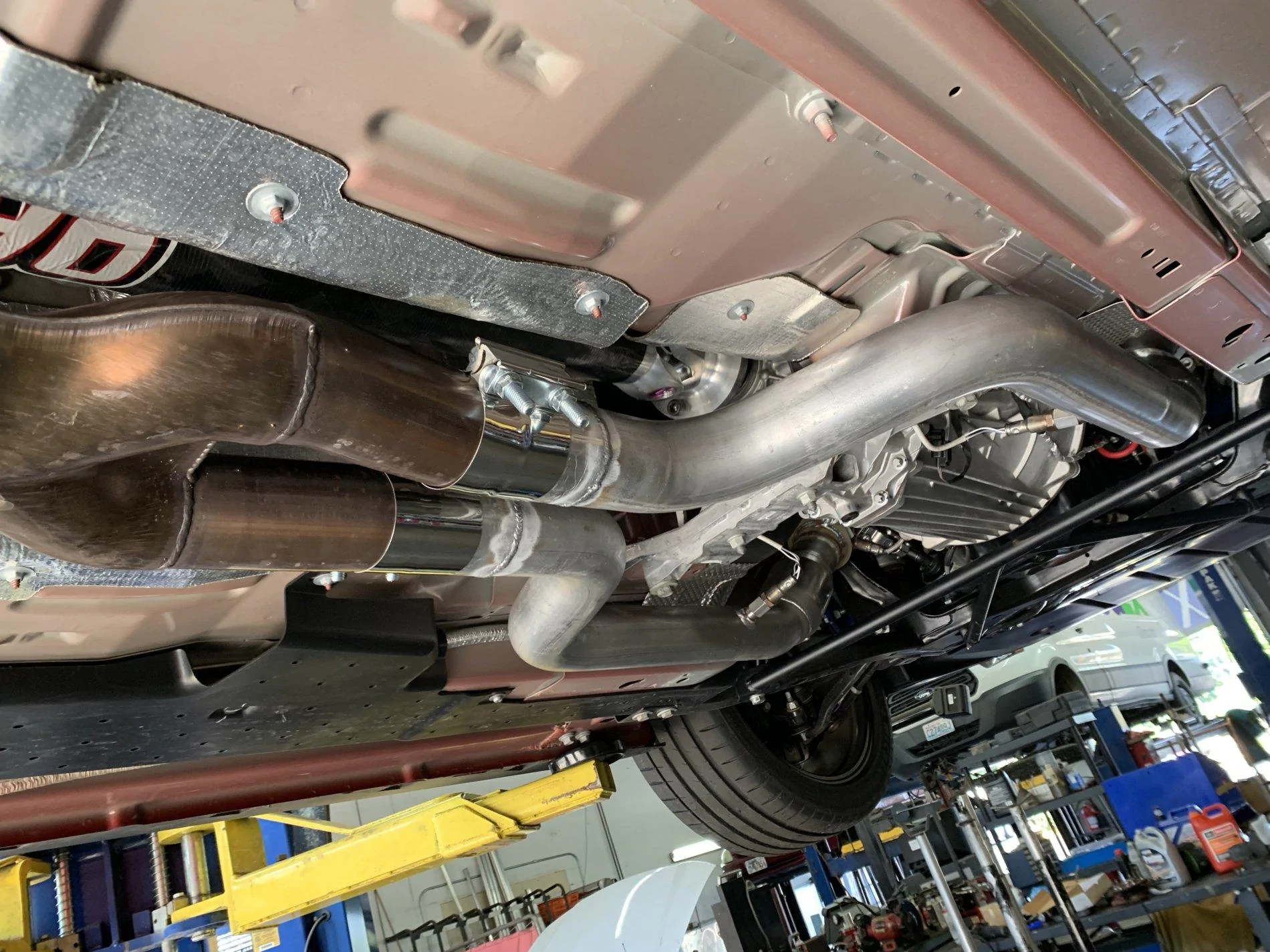

Just wanted to follow up on this. I did order the MAK Performance catted 3" midpipe kit with the connection for a 3" catback and O2 defoulers. Had it installed today. With my BBK shorties we did have to cut off one of the flanges and reorient it a bit. Lopped off the stepdown section from my magnaflow 3" catback so now its a full true 3" system. The difference in volume is considerable. I think it sounds great. Here's some pictures
