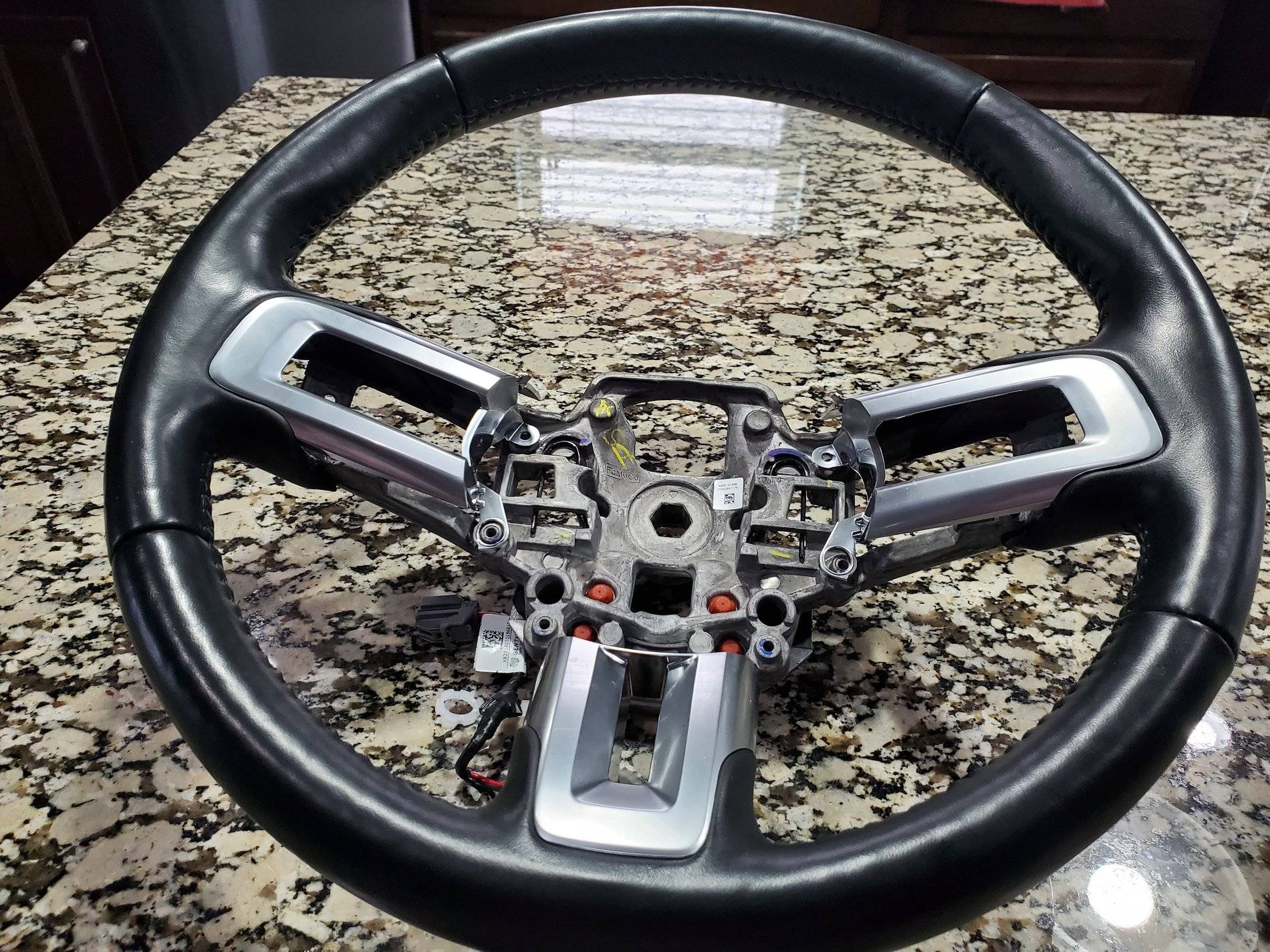

I used the allen wrench. I found it helpful to look at my steering wheel that I was replacing to visualize where the spring clips are. When you insert the allen wrench in the hole about an inch, angle it down and towards you, as you push it in. It take a lot of luck actually to get it right. I have removed mine a few times. 1st time took over an hour to get that dang spring. 2nd time took about 10 minutes and the 3rd time took an hour again. Here is a pic of the wheel, notice how you have to compress the spring down low and at an angle.
