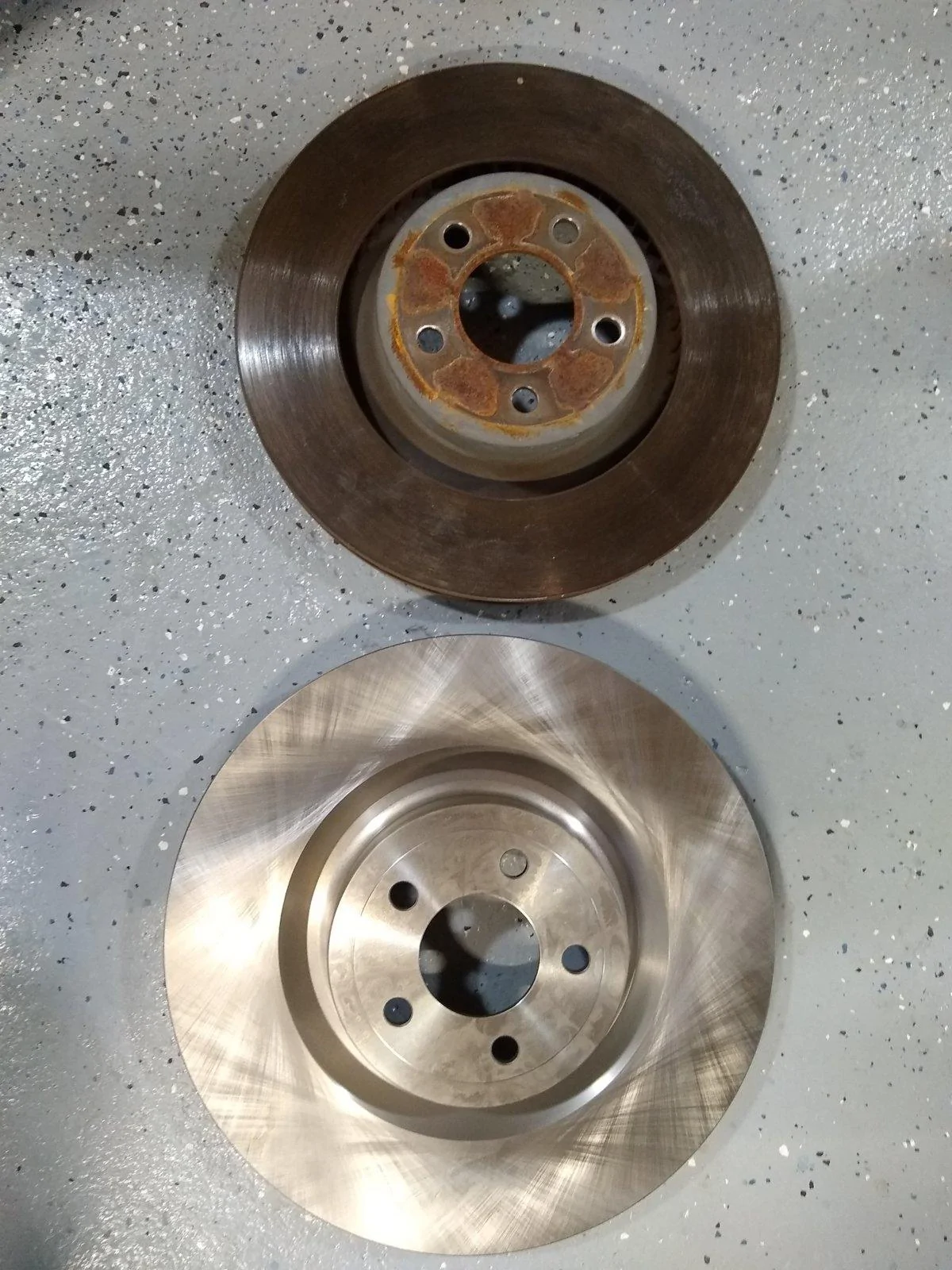

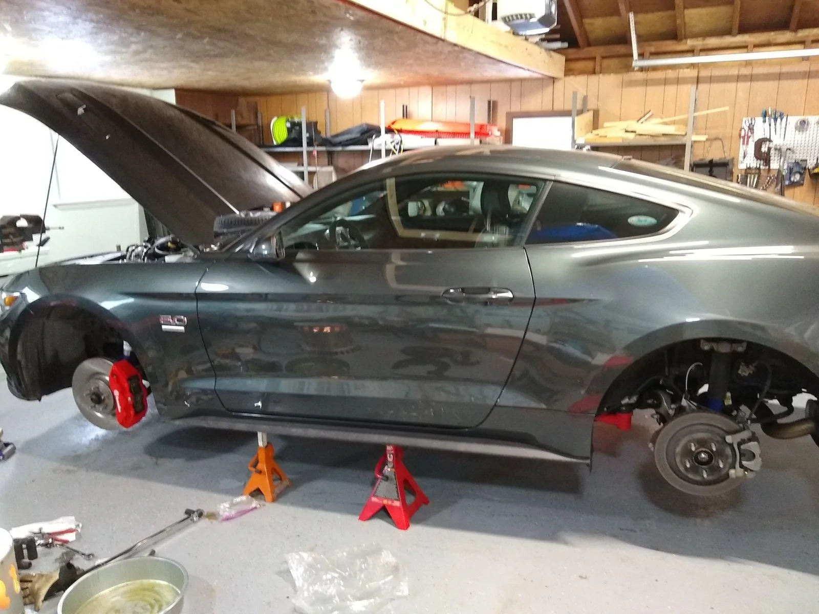

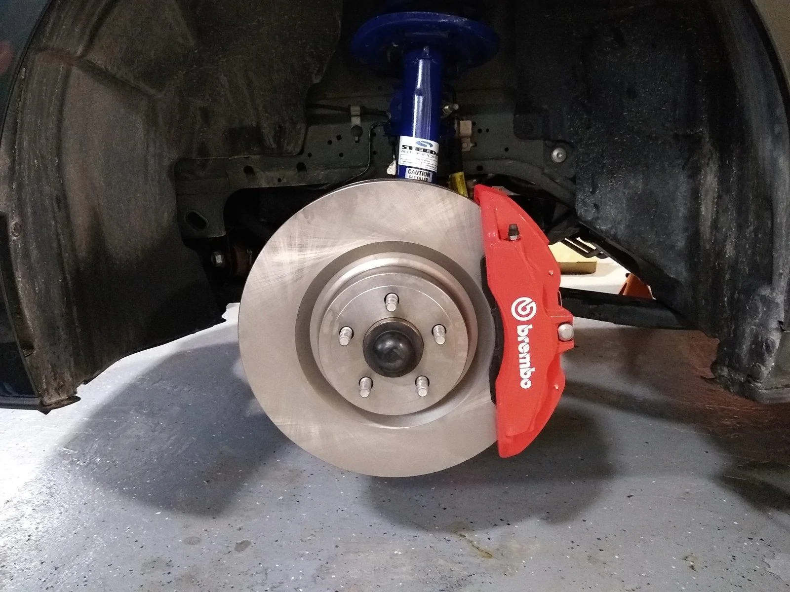

I installed the front Progressive rate Steedas and Brembo brakes yesterday. I was amazed at how softer the progressive rate springs were compressing them by hand than the stock GT springs. Hoping to get a better ride yet also flatter handling.

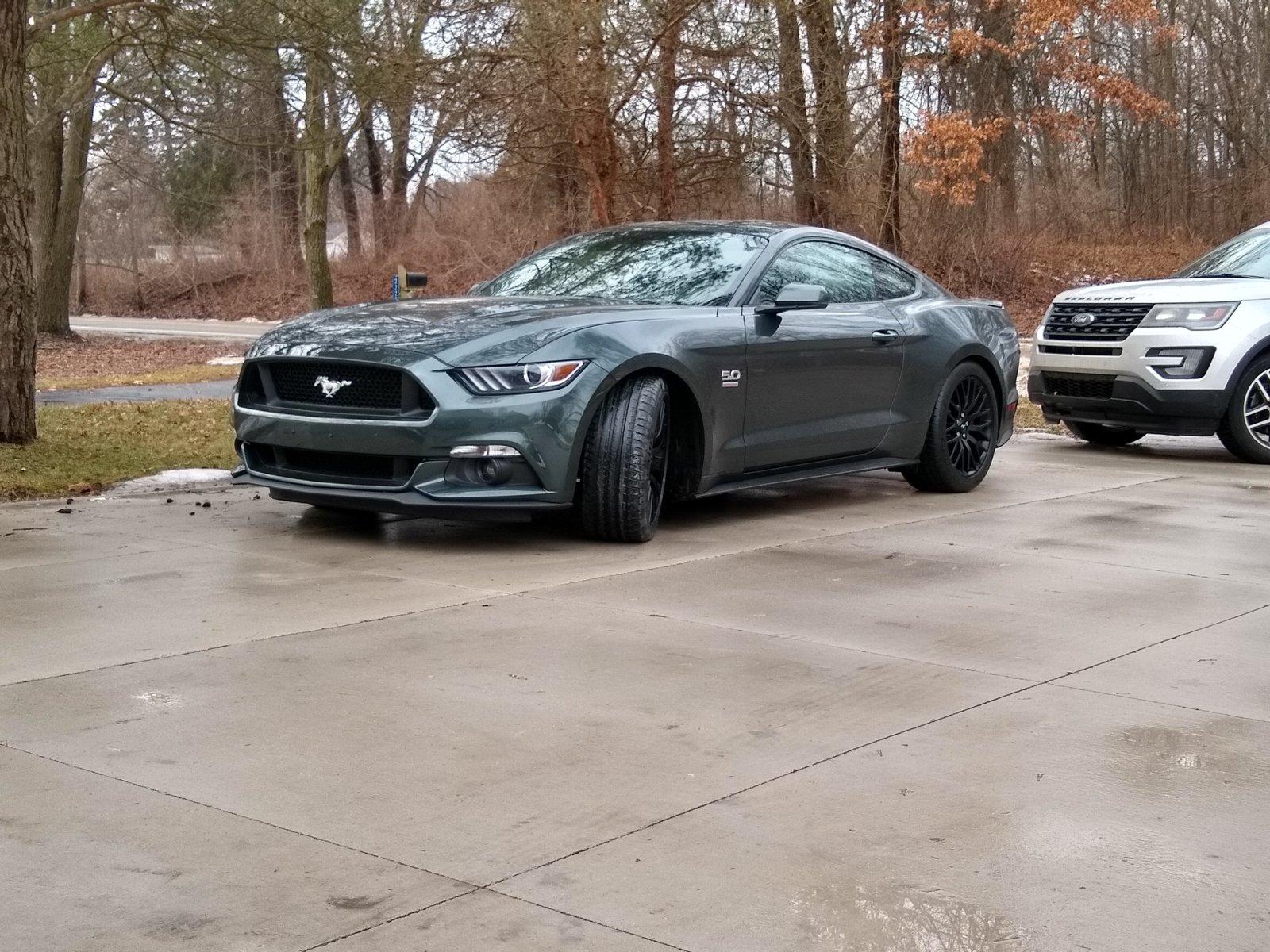

I sold the track bars a while ago. The weather here is still wintry so I haven't really tried any curves. I did put Steedas spring spacers in at the same time so the rear end is only dropped 1/4" and the front a 1/2".
I could tell immediately that the progressive springs were going to help as I could compress them slightly vs the stock springs which wouldn't budge.
They remind me of the Ford Racing "p" springs on my 2011 and 2009 GTs .
If I change sway bars I will only go with Steeda. As you said, keep the parts working together. Here is the after photo. The car hardly looks lowered. Exactly what I wanted. I'm sure it will settle a bit, though.

^Looks good man. Good choice on ditching the Track bars I think. Glad to hear its working out well! After awhile you'll be able to know if it needs a little fine tuning with the bars.

This is evidence of how much improvement is possible with these cars. It's actually shocking, pun intended lol. Glad your car is working how you want it to! Looks fantastic (best color too).
