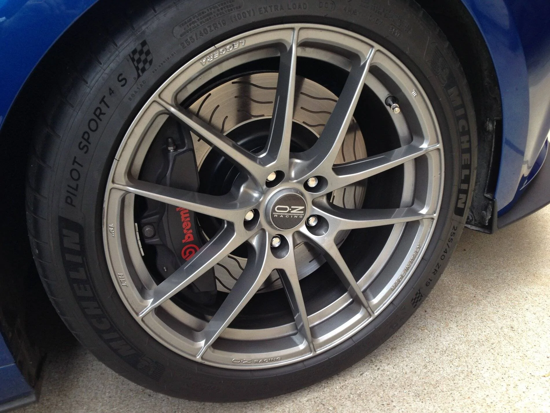

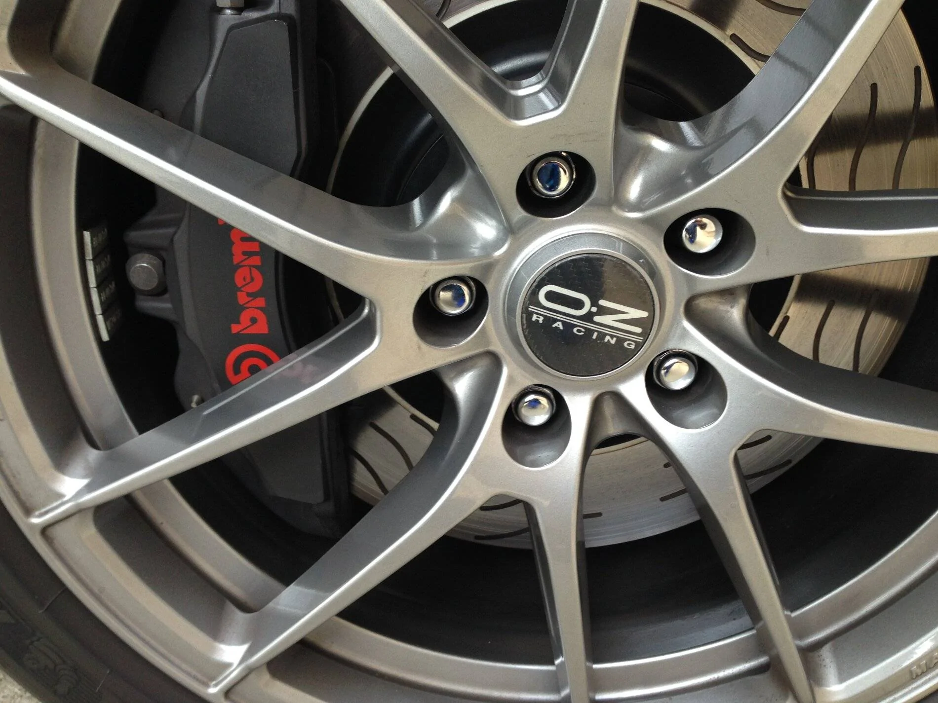

factory wheels are heavy. 33 lbs+- the SVE's weigh about 25 lbs. improves acceleration, braking
and suspension motion. first thing i did was sell my PP1 wheels/tires (Pirelli). Bought OZ RACING
set about 48 lbs lighter total and car feels quick. worth buying a matched set... SVE good weight/looks
