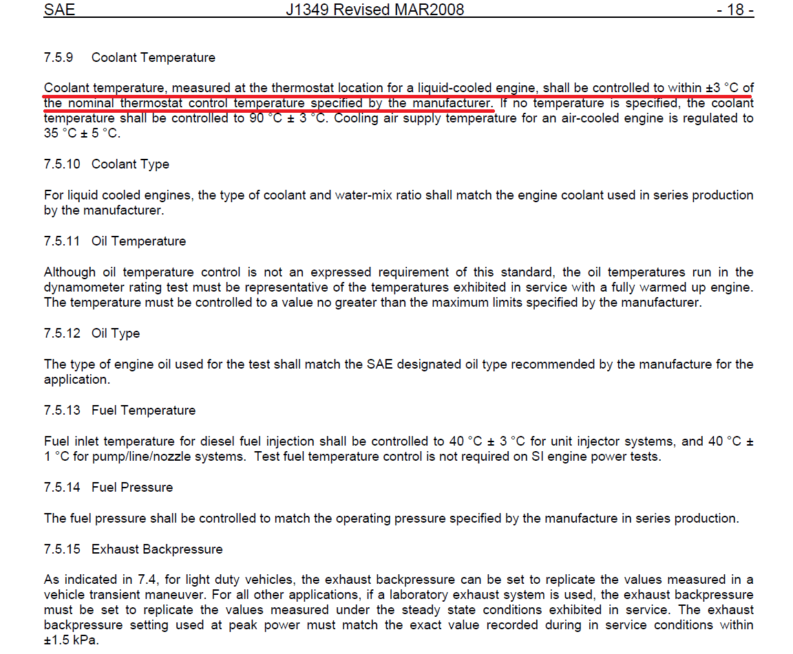

Is everyone running the tune using the thermostat 2 & would that explain some of the hp gains compared to other tuners?
Thanks for the info!
