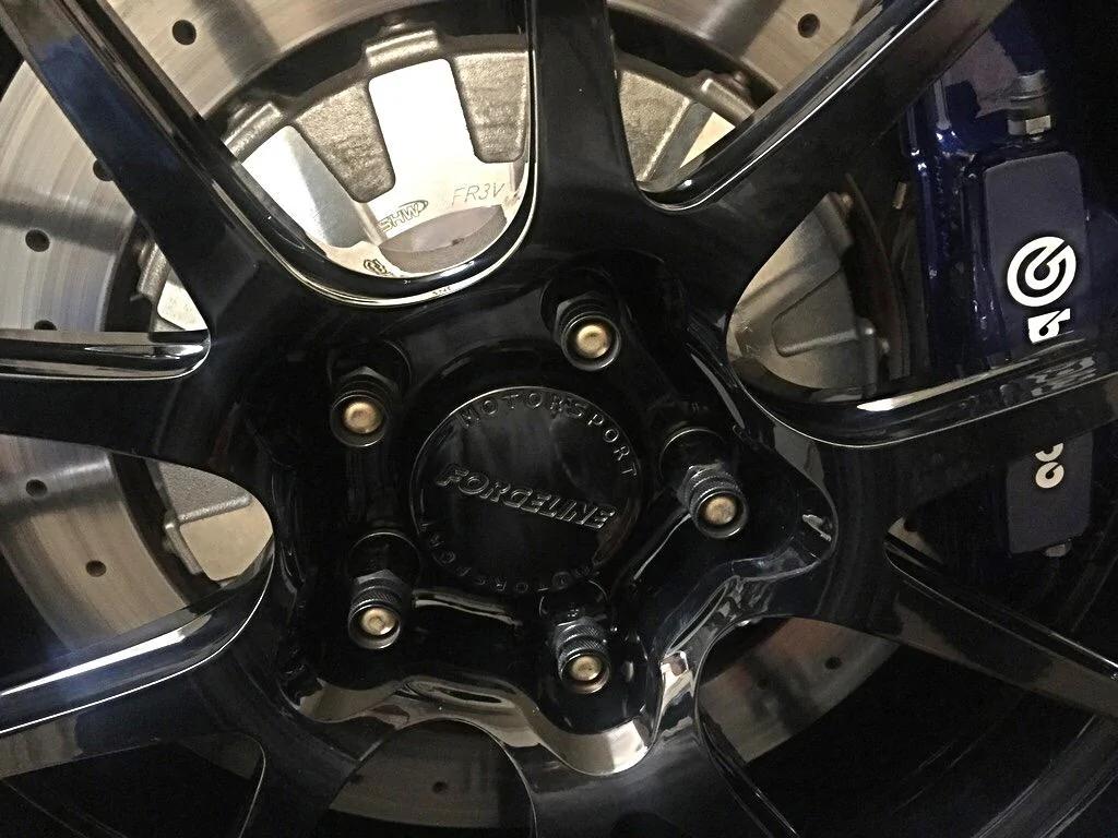

FWIW I went with ARP hardened steel studs and steel nuts for my race car. Got 5 years out of the last set with no issues (and the car was stored outside a lot); I replaced them this year preemptively.

What I’m using with my ARP lugs. Work great! They have a great seat but still work with the narrow lug holes of many aftermarket wheels.
