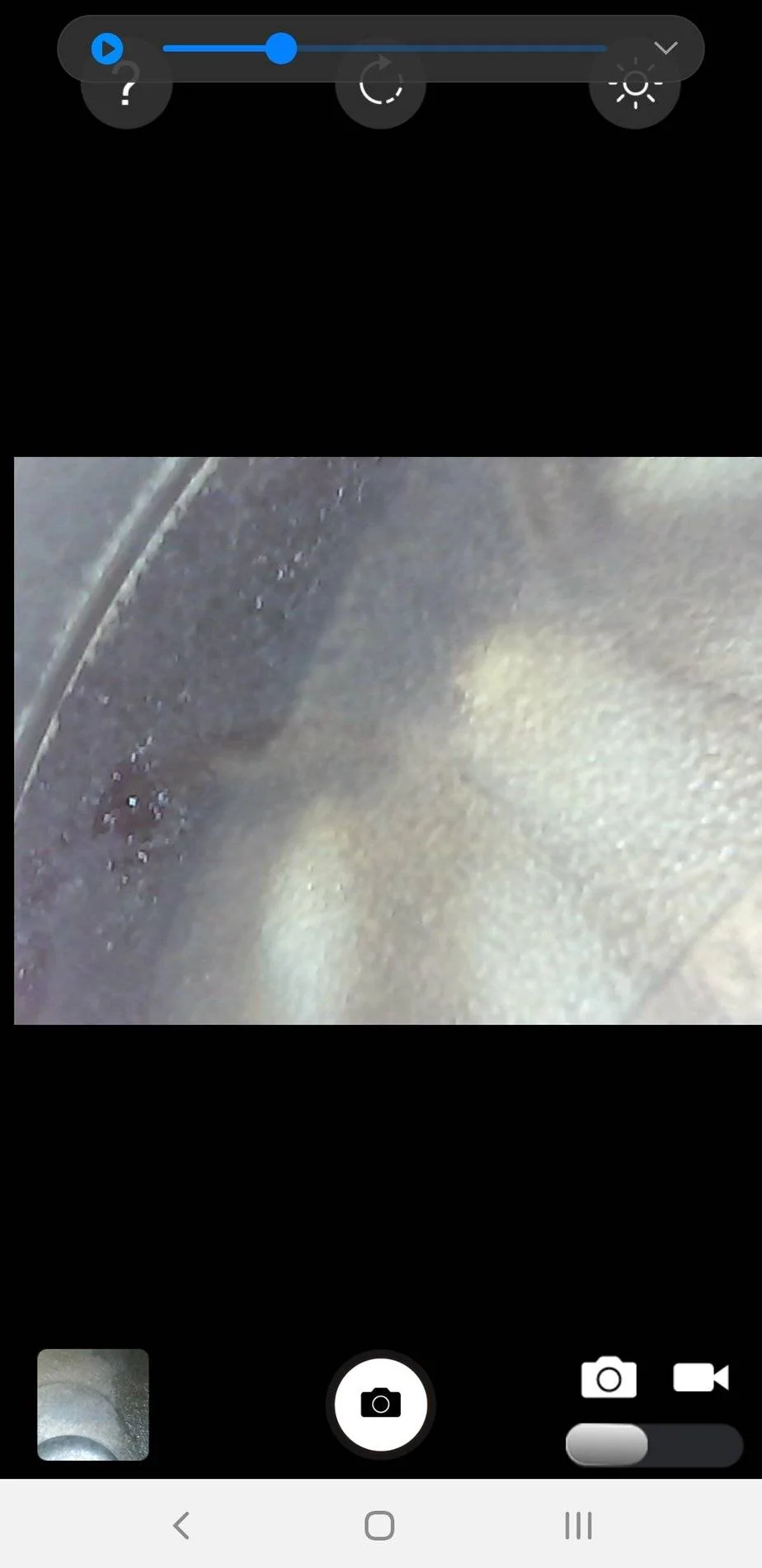

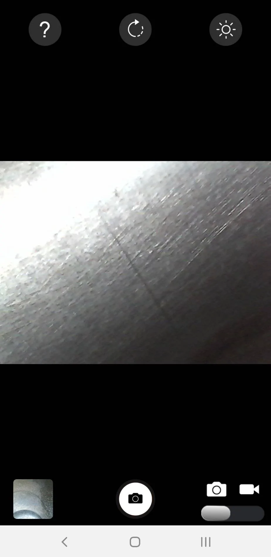

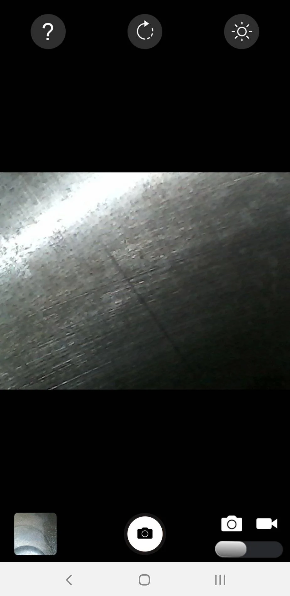

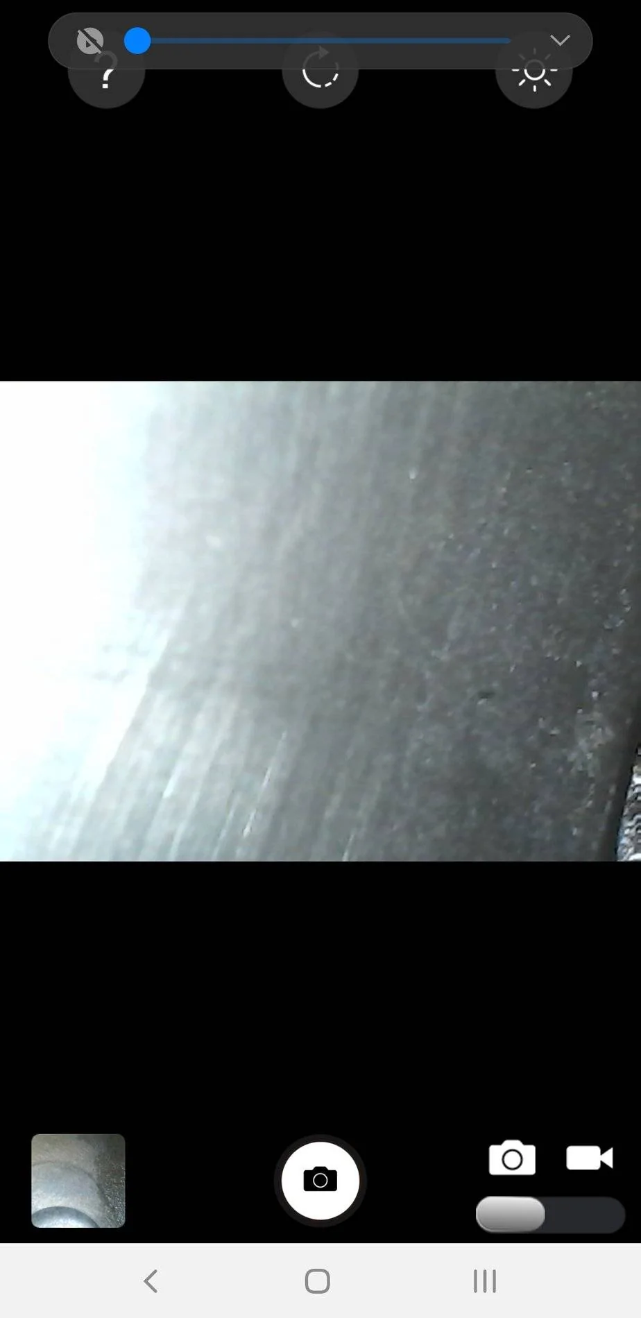

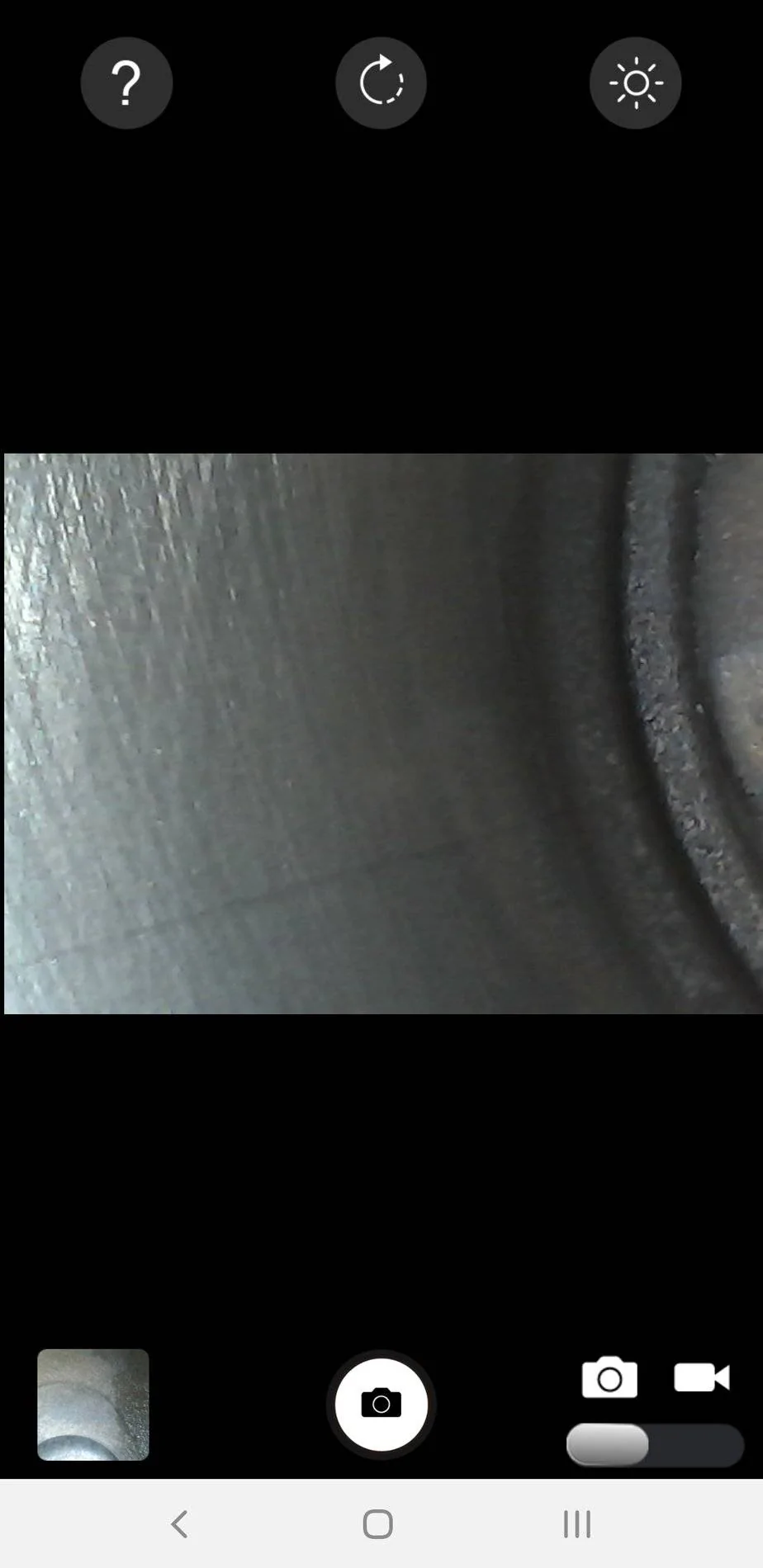

Additionally, the engine was making some weird noises and I decided to add liqui moly friction modifier, which did reduce the noises. Problem is I later found some scoring in the cylinder walls and some spark plugs with a good amount of oil on the threads.

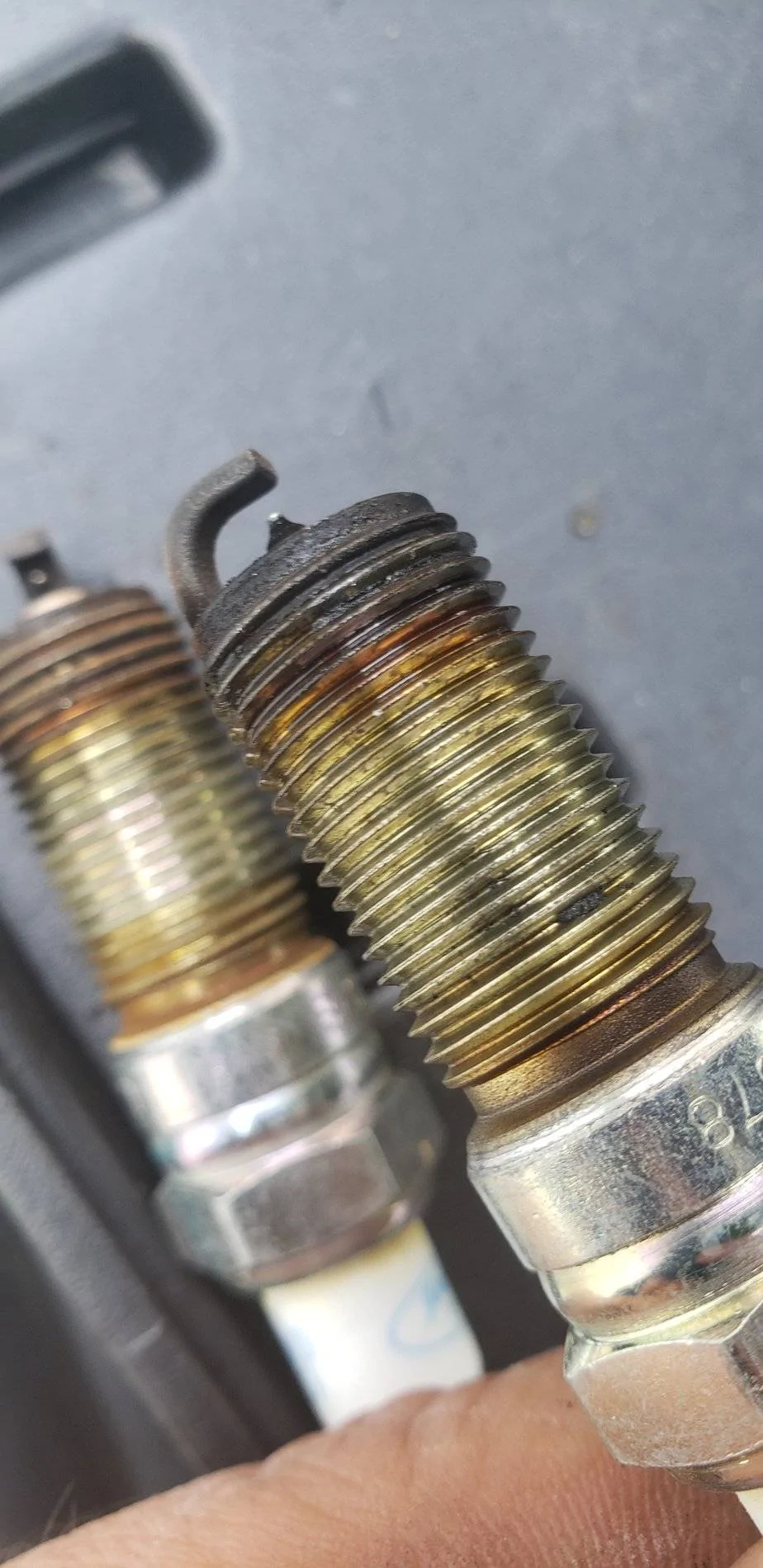

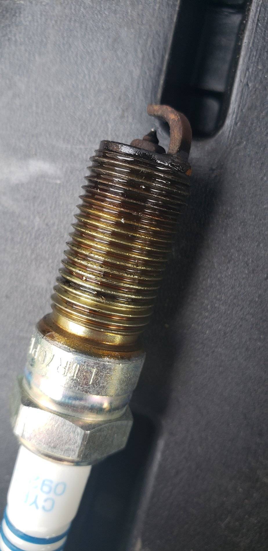

I found about 3 sparkplugs with oil up to the base of the threads and the rest had oil on about 4-5 threads. I also found 3 cylinders with what looks to be about one or two drops of fresh oil. Does this seem excessive or is it normal for gen 3 coyotes?
The pictures of the scoring is just from the drivers side bank, the passenger side bank cylinder walls look to be in about the same condition. Is this level of scoring considered acceptable for 46k miles? I don't have the full service records, but I believe it is the original short block from November 2017. It doesn't seem too bad compared to other gen 3 coyote cylinder walls that I've seen.

The oil on the plugs most likely indicates that cylinder is using some oil, or getting oil into the cylinder. Are the cylinders that the oily plugs came out of close to the PCV hose connection on the intake manifold? That would be the first two cylinders from the front of the engine on the passenger side. If so, then it could be oil that is getting into those cylinders from the PCV system. Do you have a PCV oil catch-can on this car?
The very slight cylinder wall scratches look normal. Ford has a General Service Bulletin on cylinder wall scratches, and those are well within normal.
The spark plug gaps look huge. Did you measure the gaps and check against the specs. Probably wouldn't hurt to put set of new spark plugs in.

The car is still stock so no catch can. The spark plug with the most oil on it was actually found in what I think is cylinder 8, right next to the firewall on the driver's side of the engine. I did find one that looked similar on the passenger bank in cylinder 3. I'm using mmr's coyote firing order diagram for reference
That's a relief to hear then. I did check the spark plug gaps, but my tool only goes to .045. The gap was only slightly bigger so I assumed it was good enough. I read that the plugs should be around .05 is this correct?

Yea .050 is fine for gap on oem. I think it's .049-.053.
