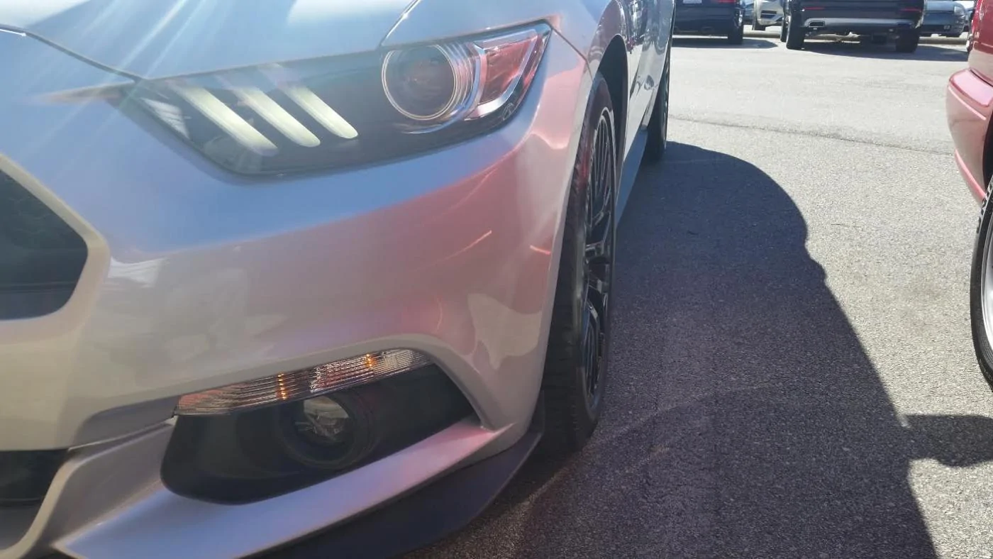

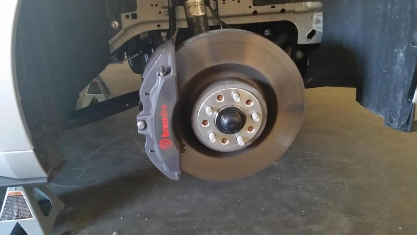

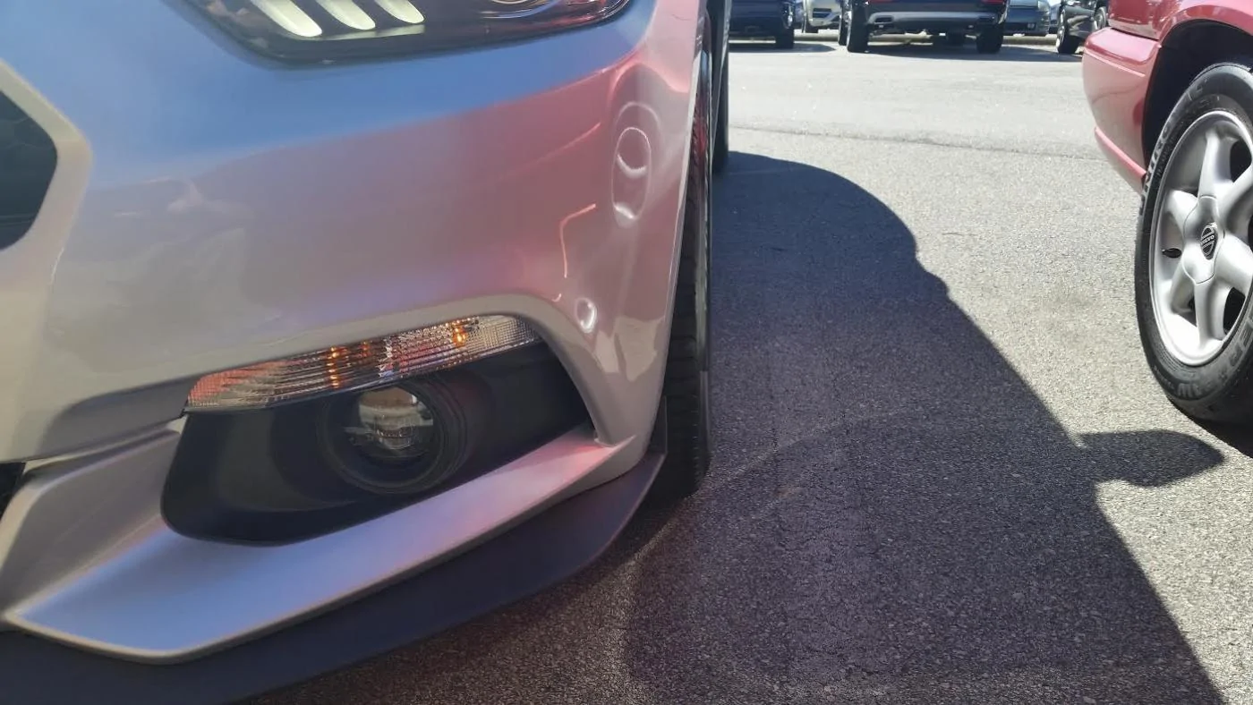

[MENTION=18047]TrackpackGT[/MENTION], that is the exact kind of setup I want. How do you like it compared to the stock PP setup?Here's mine with the OEM 275 fronts. Also a pic of the 5mm hubcentric spacer I used. It was 70.5 and the hub measured 70.36, so a nice fit.

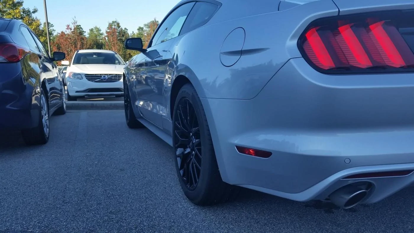

Did you just get 2 additional wheels the same spec as the rears?I really like the fact that I can rotate tires now. I also think it looks a little better with the slightly wider front end width. It definitely tends to follow road imperfections and you gotta stay on top of that wheel, but it kind of makes it more involved. Did quite well for me at the track too. So far, I haven't seen many aftermarket wheels that I like better, and definitely not $1000 plus better.
Are those the stock PP wheels? They look like it to me. And you are running the rears on the front with a 5mm spacer?I really like the fact that I can rotate tires now. I also think it looks a little better with the slightly wider front end width. It definitely tends to follow road imperfections and you gotta stay on top of that wheel, but it kind of makes it more involved. Did quite well for me at the track too. So far, I haven't seen many aftermarket wheels that I like better, and definitely not $1000 plus better.
