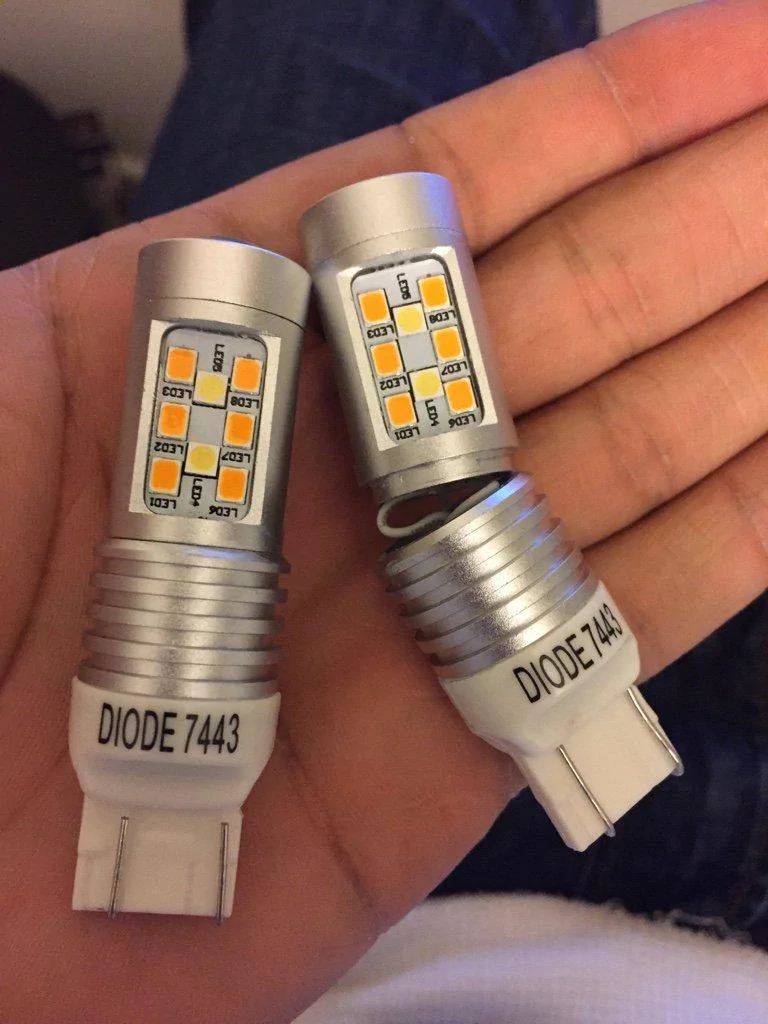

So I got my my DD switchback lights in and I was highly disappointed. First it seems like the bulb doesn't really fit in the package, but I didn't worry about that too much. I pull the bulbs out of the package, and I notice this
There is a slight gap in one of them. I wiggle it to see if was loose and then this happens
It removed itself from its housing. Not something you want to see from something brand new. [emoji58]

That is another thing we are addressing in the next production run of these bulbs. We have not actually seen that issue with any customers (until now) but we did see it on one during QC.
We will be contacting everyone who purchased and offering exchange at no cost, as soon as we have the new bulbs. We are no longer shipping these. While quite a few of you have them installed and are looking great, it seems they are just too buggy right now.
I am honestly very disappointed in our performance with this particular product. We focused on the LED and electrical design, and that part of this bulb is still really awesome. Brighter than anything else out there, perfect digital timing on the dual color circuit. Clearly though, we did not check the tooling and molding on the base carefully enough, leading to the fitment issues and the issue above. The electrical design is meaningless if you can't install it.
We'll be back very soon with all the bugs ironed out, and the quality, reliable product you all expect and deserve. I really appreciate everyone's patience, and I do apologize for any frustration caused by our mistakes.

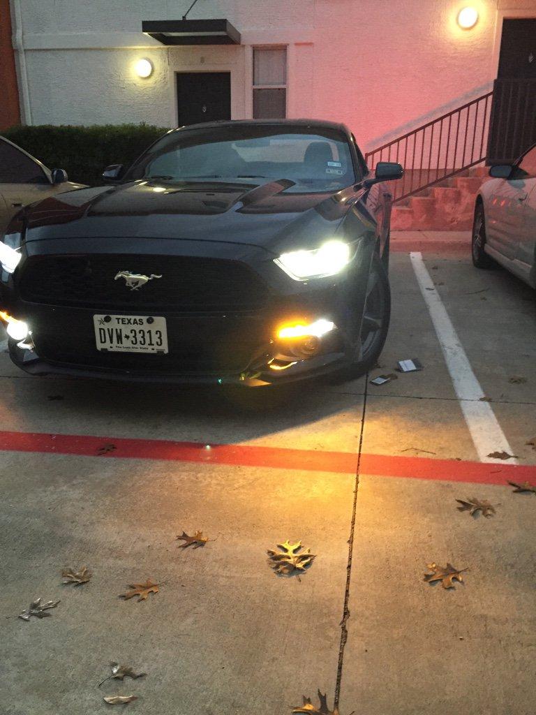

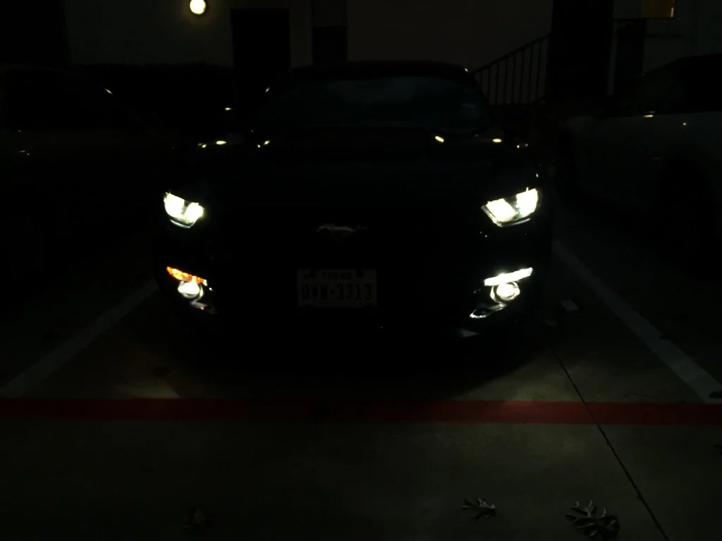

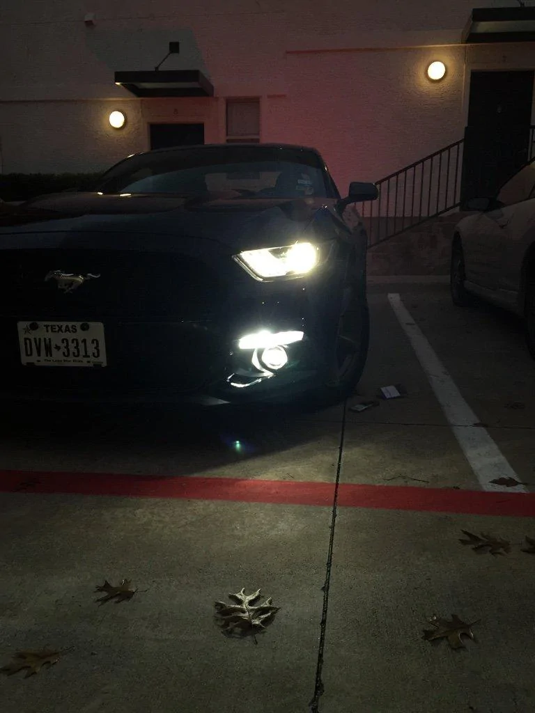

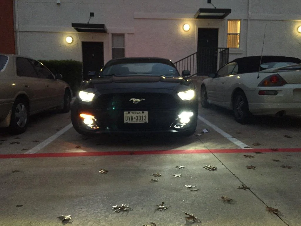

I decided to put in the non damaged bulb just to see what it looks like and how it functions and these are the results. Sorry for the iPhone pics
I don't mind the double clicking when the turn signals are on, but personally I don't like the color. The temperature doesn't match with the LED fog lights or the HID headlights. Just looks a little off to me. DD, any chance you guys will make an all amber LED for the front signals?
Yes, we actually have three options for standard amber LED turn signals. All have been on the market for quite some time and use a different base connector than our new switchback bulb, so they do not exhibit the same issues we are seeing with that connector. Please PM for more info!

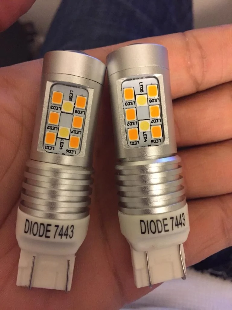

Yes, we came to the same conclusion, they pop right off if you get the right spot. You want to use a very small tool to pull back on the bottom corner on the inner side. Here's the install video!
Regarding the vanity lights, I noticed they are a bit more dim due to the direction the LED is facing (concentrated into the bracket) vs. the omnidirectional OEM bulb. Just wanted to let everyone know that you can use a small strip of reflective foil tape and bend it around the bracket to more evenly distribute light from the LEDs.
