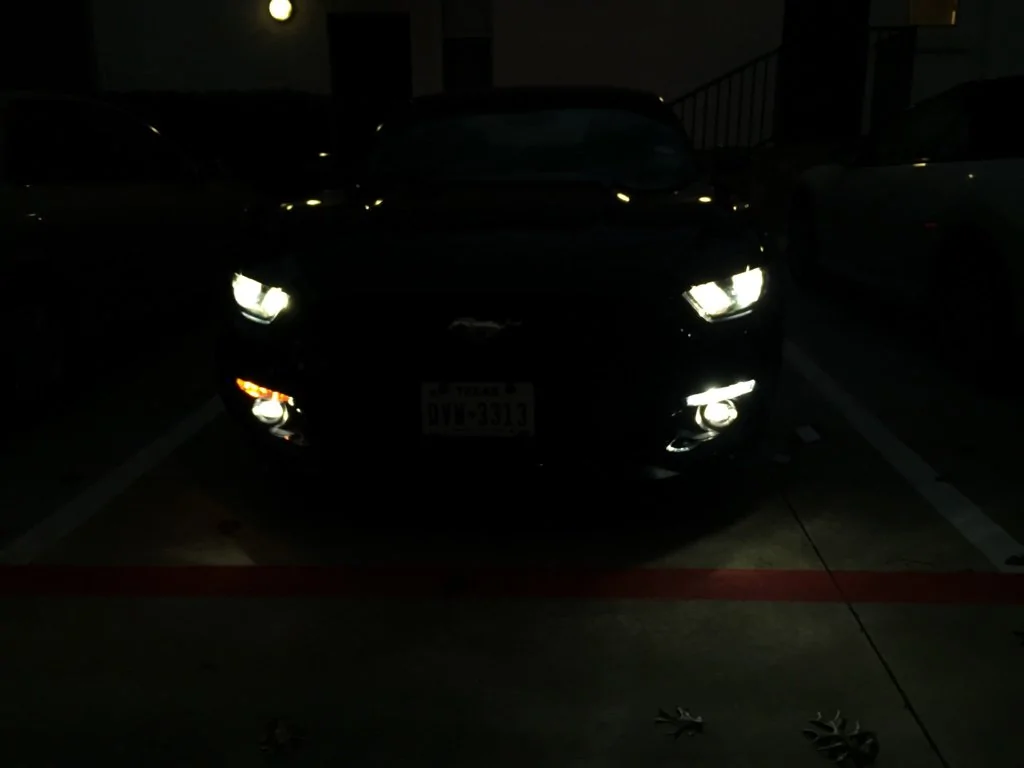

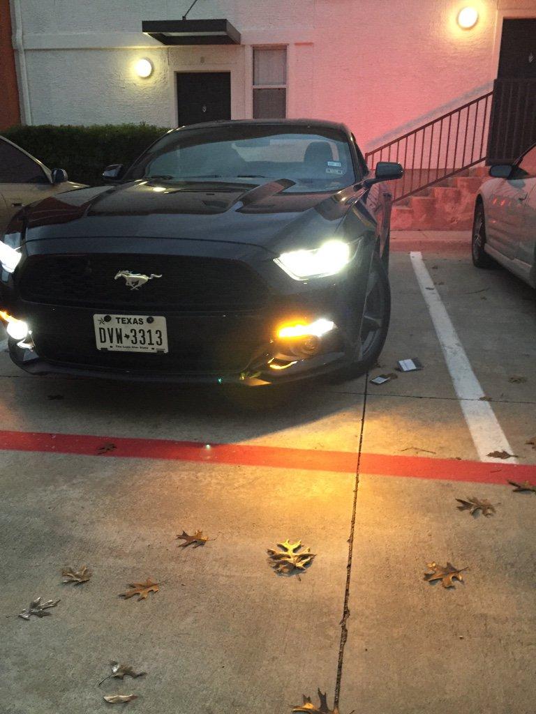

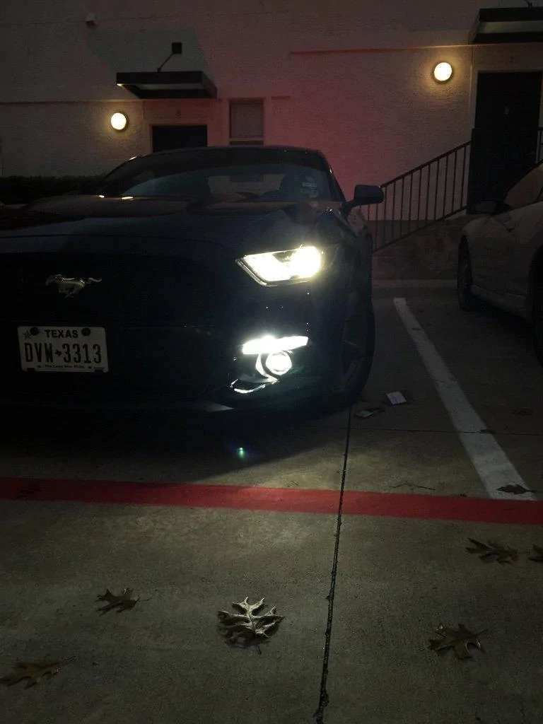

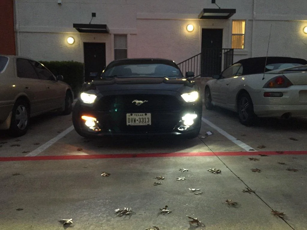

I decided to put in the non damaged bulb just to see what it looks like and how it functions and these are the results. Sorry for the iPhone pics
I don't mind the double clicking when the turn signals are on, but personally I don't like the color. The temperature doesn't match with the LED fog lights or the HID headlights. Just looks a little off to me. DD, any chance you guys will make an all amber LED for the front signals?
I would like the temperature to match as well, kinda why I am holding off on this.

Yeah, the HID's and LED fogs have a slight blueish hue, while still giving off a crisp white light. The DD bulb is just a really bright white. It's not off by much, but enough that it messes with my OCD. (I'm not really OCD, just trying to paint a picture here lol)

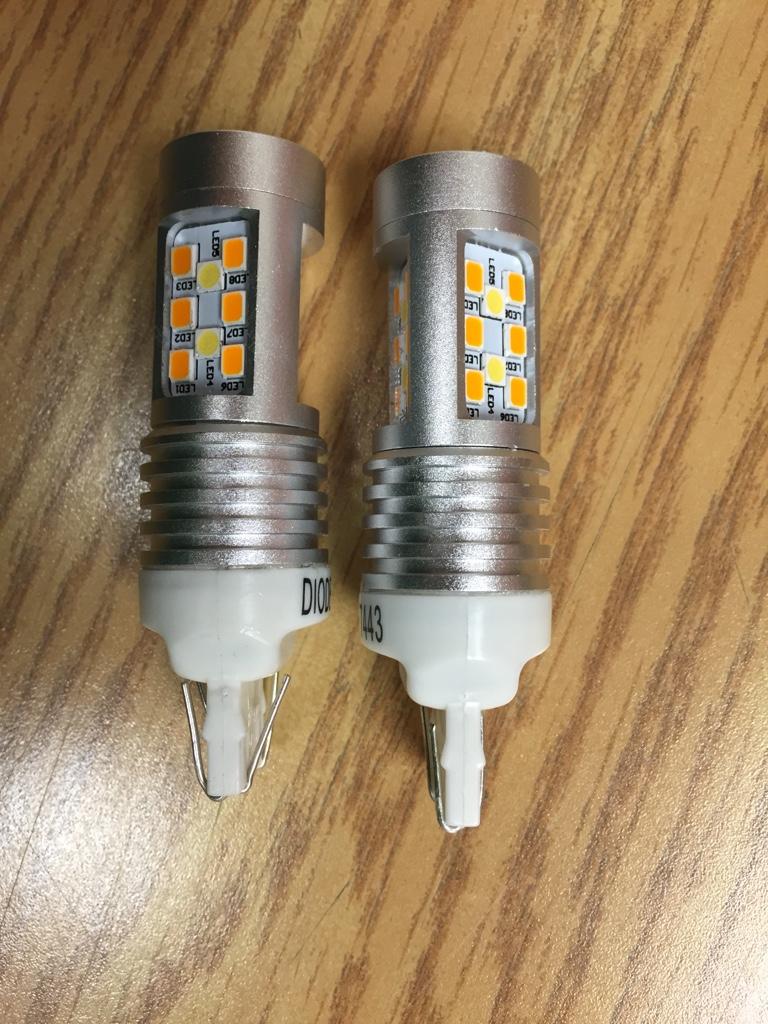

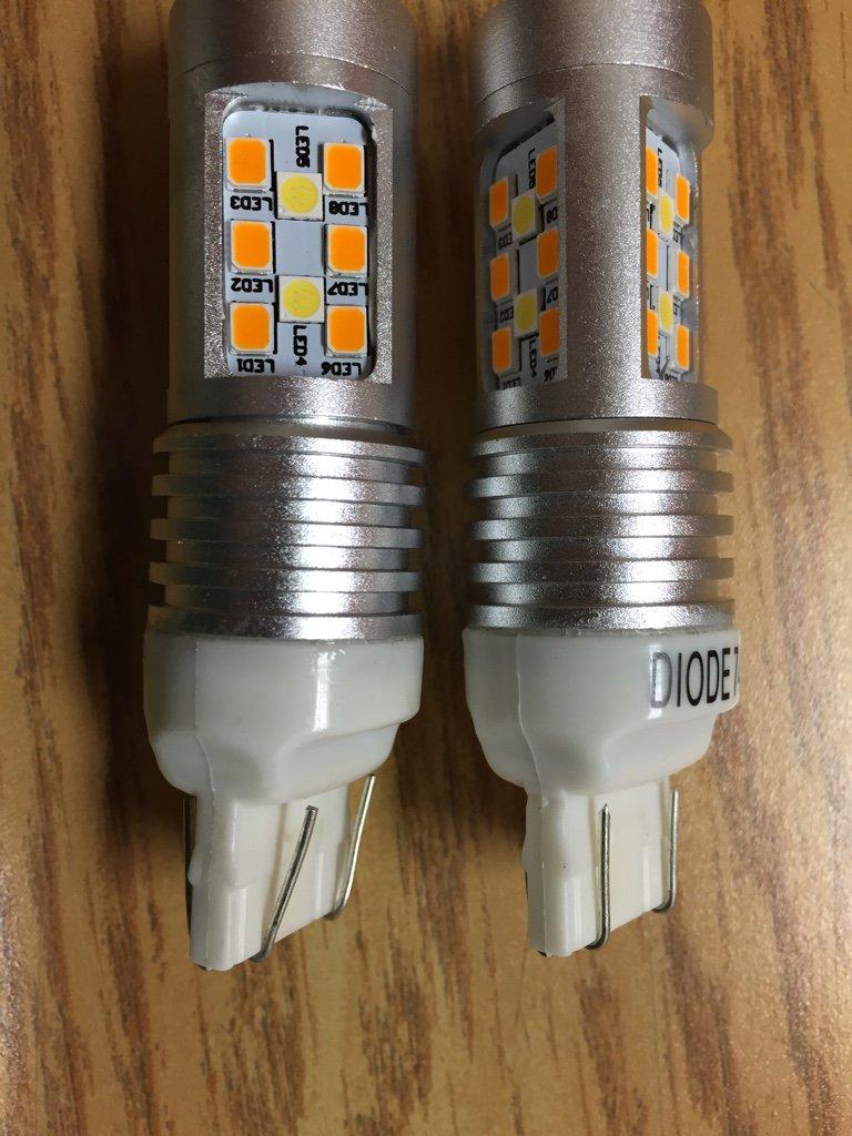

I received my switchback kit today in the mail. After looking at the connectors on both lights I can see why it would pop out of the connector. If you look closely at the pictures you will see one of the bulbs connectors are extra long and could Push itself out of the socket. The other bulb looks fine and might work. My car isn't here yet so I cannot test this out.

I found a temporary solution to Diode Dynamics switchback LEDs. The small LED fits fine, however the larger dual colored one did not fit properly and fell inside the housing. Luckly I was able to find a strong enough magnet to pull it out. After inspecting the OEM bulb and the one by DD I realized the metal wires are too long on the DD LEDs. If you cut it a tiny bit of the wire just up to the part where its supposed to clamp on it will fit, but its not entirely secure. Use the OEM bulb wire a a guide for length. While I was able to install both properly without it falling off, I am not sure if it will hold. Since my car is a Summer car and I won't be driving it anytime soon I will not know if it will hold. So Diode Dynamics when you do come out with the revised version, I would like to exchange the larger bulbs, for my peace of mind.
I hated the orange OEM look, my original plan was to tint the overall housing, but this is a way better solution. I really like the overall look, and I would recommend it to anyone, once they've fixed the fitment problem.

We have already redesigned the base of the bulb to ensure proper fitment in the 2015 Mustang. The new shipment is expected to arrive within the next few weeks.
Feel free to give us a call for more information: (314) 205-3033
We will replace any set of switchbacks that have experienced fitment issues in the 2015 Mustang
