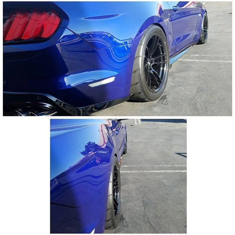

I have a stock supsension ecoboost and went 315/35/20 in the back on 10.5 width wheels. Love the look but it pokes just a bit and I rub over certain dips in the road when I have a passenger or heavy load.
I know people say 315 is ok, and I love the look, but I plan to drop down to a 305 when I need new tires because the fitment is just a bit over-sized. I can only imagine it would be worse on a lower car.
Go with 305 width at the most IMO.

With the 6gr stock 20" offset tge 315 35 20 are close and rub 305 35 20 good or 295 35 20 for rear 285 35 20 fronts do catch shields 275 35 20 best for front 305 30 20 also good for rear but I'd recommend 35 profile my current set up 325 30 19 rear and 285 35 19 rear cup 2

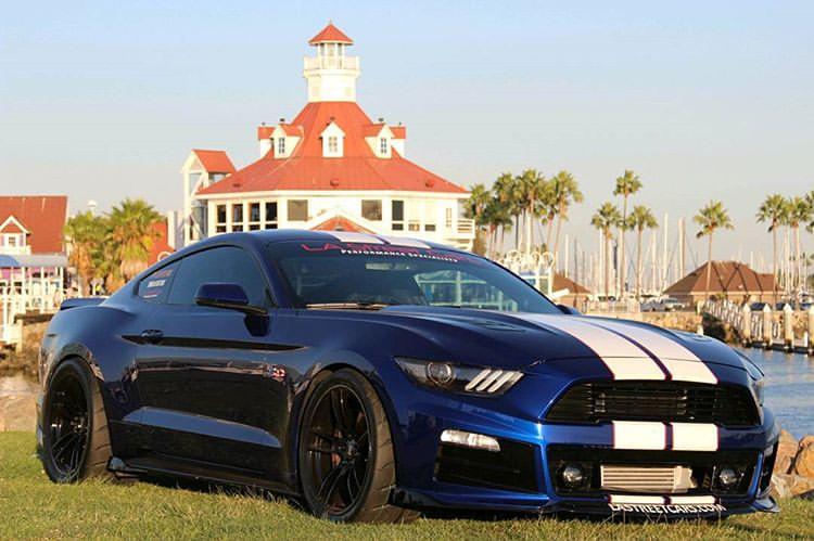

We run 275/35 and 315/35 on our STR wheels with a 9.5in front and 11in rear wheel with 59mm offset out back. There are no issues with this unless you go with an extreme drop.

When my car finally arrives, my intention is to basically run the same setup as in the photo:-
P51s 19x11.5”....345/30s in the rear:headbang:
