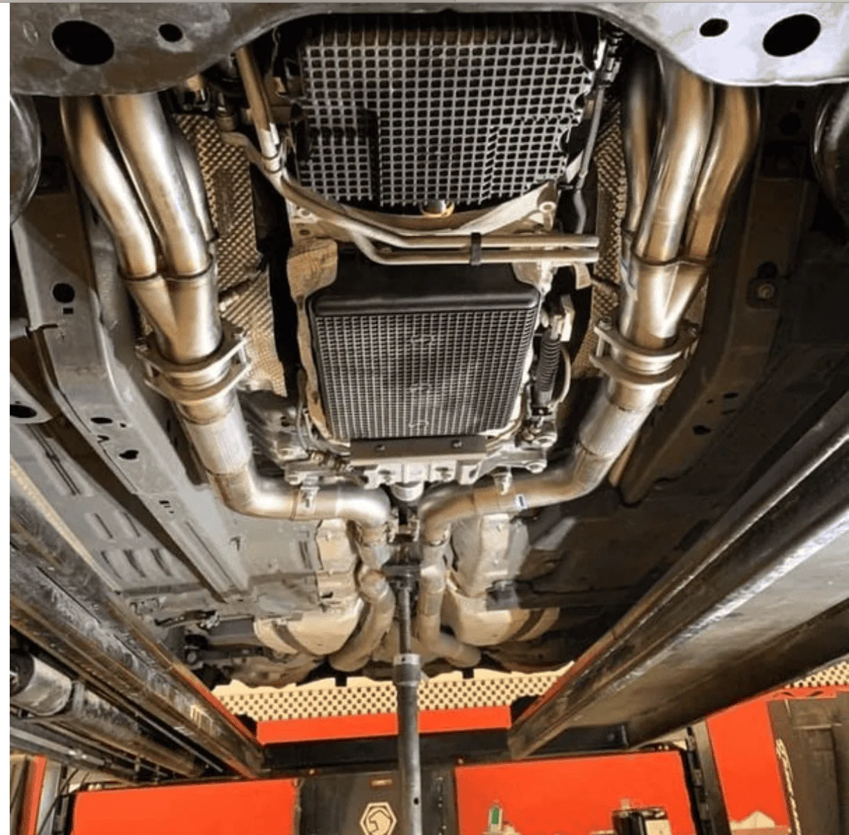

I saw this photo on the American muscle website. I am leaning towards this. and maybe o2 spark plug spacers because of check engine light.
I can't find anyone who wants to sell their connection pips so this is what it has come to.

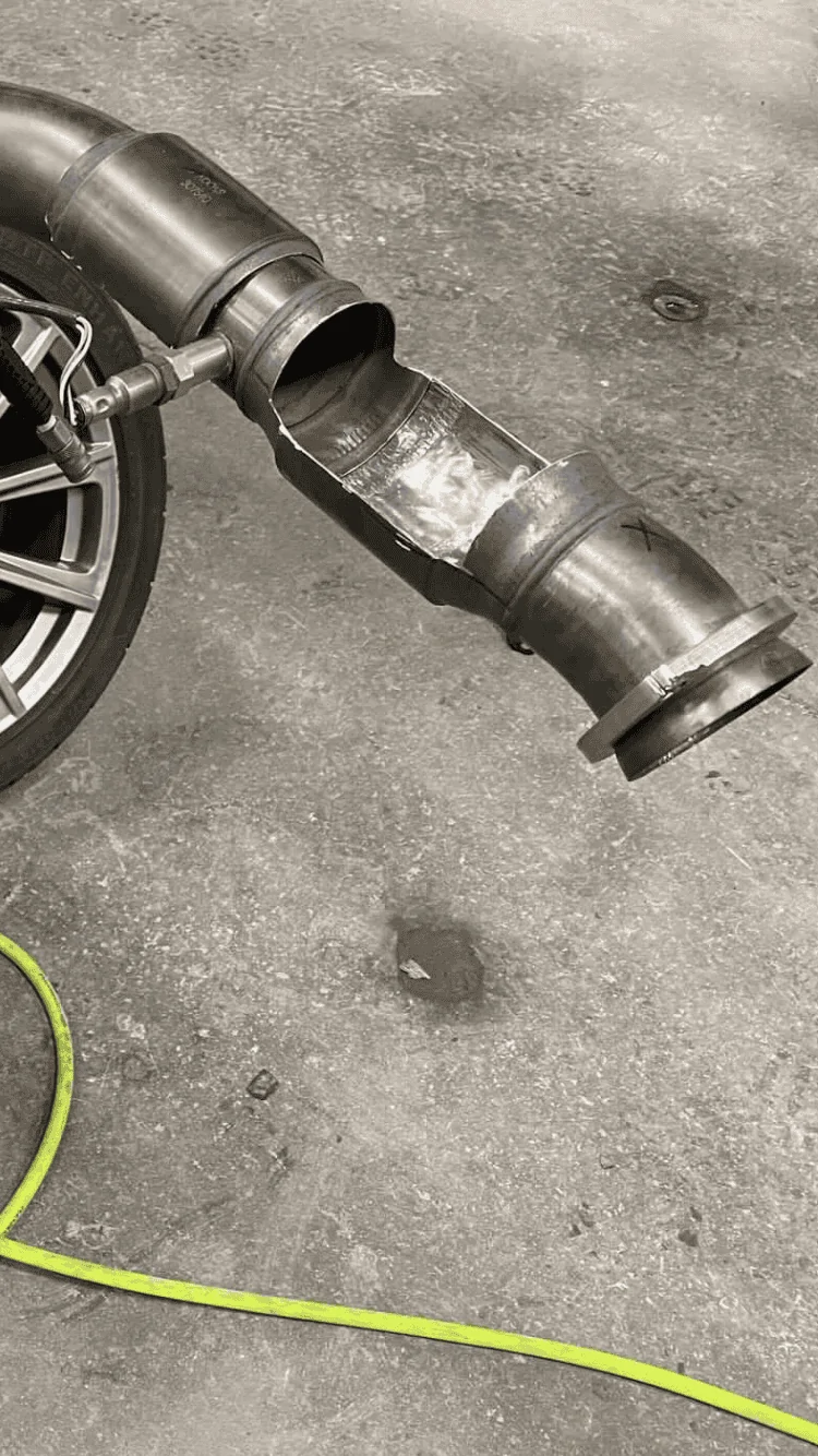

We did this to my Kooks cats….
I would like to do something like this off possible. It would be nice if you had a photo of it after you finished but I can image how it looks. From under the car I’m sure no one could tell

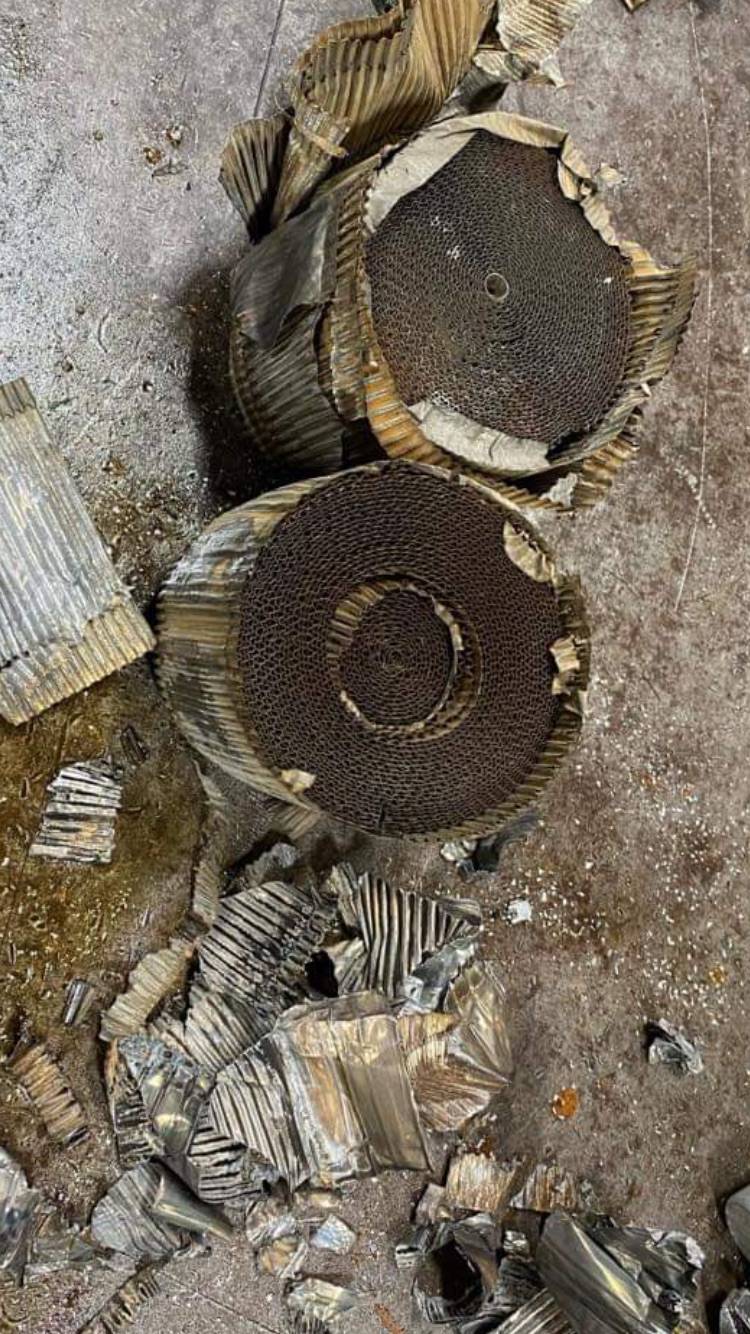

Sometimes the cats clogg when over 700 whp and you can blow your engine that way.
I know a few people personally that blew engines because of clogged cats
I thought that was mainly from stock cats. I think high flow cats can handle that power fine, especially kooks. They use quality stuff.
I could be wrong. It would just be a shame to cut up a perfectly good system for nothing.

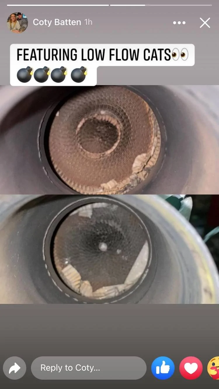

These what my Kooks cats did after 10K miles. Also caused a ring land failure because of it. Factory cats are far more robust and a better construction design than just rolled metal.
