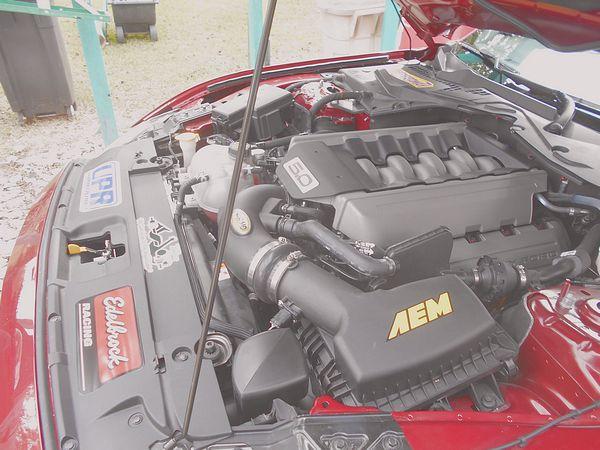

For the record, if you go drop in filter there are better choices than K&N. They dont filter well and you can over oil them. I'd recommend a dry filter like AEM.

I did the AEM drop-in w/Airaid tube and will wait out the warranty a little while till I get a tuner. With a resonator delete X-pipe it helps a little, mostly for sonic's.
