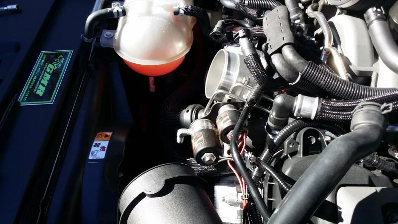

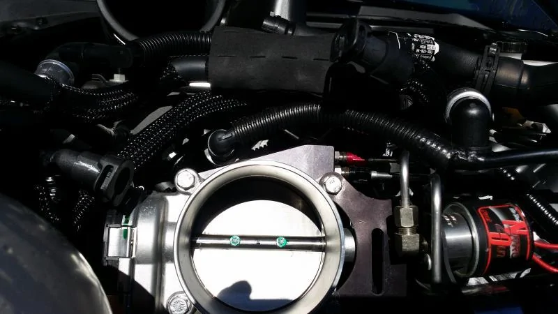

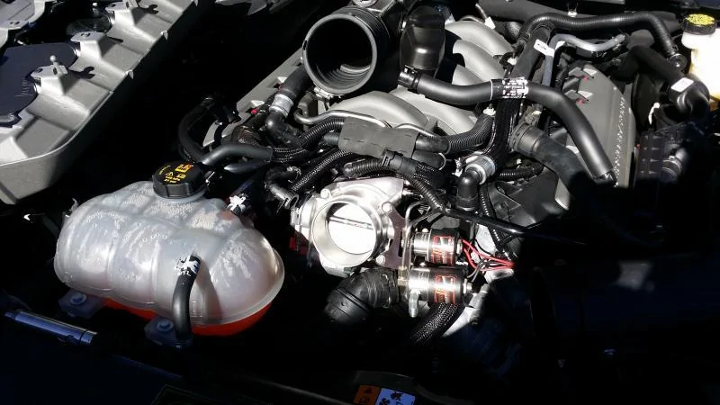

I've had the nitrous outlet plate kit off of my 2013 GT just sitting on a shelf, so I decided to put it in the 15. Space is a lot more limited on the factory air intake, so the purge solenoid that was directly mounted on the nitrous solenoid will have to be remote mounted, but other than that, everything seems to work pretty good. I will work on mounting the bottle and figuring out where to mount the progressive controller/switches at a later date.

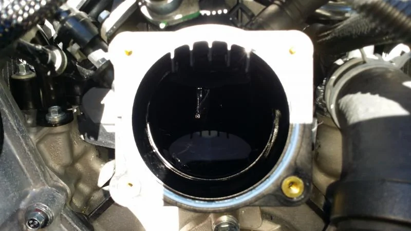

On a side note and as shown in the last picture, I will definitely be getting the passenger side oil separator, as the front of the throttle body is spotless clean, but the inside of the intake manifold has a film of oil in it. Also, its a bit hard to make out, but there is an actual PUDDLE of oil at the very back of the intake manifold. The car has 2,200 miles on it BTW.
