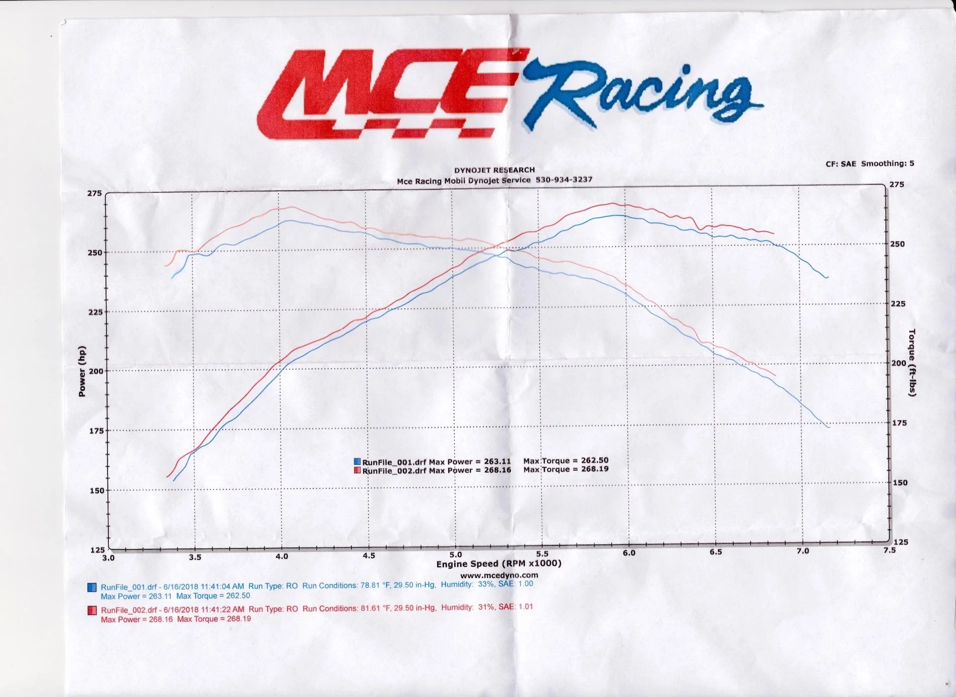

So I finally dynode the car today. Not necessarily the best conditions (81.61°F and 31% Humidity). Results are 268.16 HP and 268.19 torque. See attache graph.
Now this is with the stock intake manifold (need to finish porting my intake) and I think I am running a little rich...so a data-log and tune revision is needed.
Not complaining, for a naturally aspirated v6, i'm please...but I think some refinement is needed.
Thoughts?

Appreciate the run just to see how it came out and what you get out of the port job! I know temperature and humidity have an impact, but it sucks seeing their advertised dyno graph have 295 on the PRX93 tune and 260 on stock when most people seem to be getting more like what you got. The curves do look smooth though which counts for that improvement you mentioned.
I don't even want to do know what I'd get with the high temperature and humidity (showing 73% right now) of South Florida! In the beginning before I looked into it more, I was naively hoping that CAI, shorties, exhaust, and the intakes with the tune would hit the 300 barrier.

[MENTION=28654]Nagare[/MENTION]...the catch is I am in california...we do not have 93 octane fuel...this was on the 91PRX tune. Also....this is with the STOCK manifold...have not installed the ported manifold as I have to finish it (been really busy). So another run is in order to really see what is going on. A member on the FB cyclone forums says if the temperature were more favorable...I would probably be around 275 at the wheels...which seems right.

Gotcha, didn't know about you being on 91, that could explain a bit and looking at it again, did you stop pulling early (around 6k) or did it just fall off? I'm thinking if you ran it to 7k+ you'd get higher numbers. So if better temps put you up 7hp, running it all the way 7300 or so (that's what it seems like mine tops out at stock) would probably net about the same.

We stopped at 7k because we were unsure if MPT disabled the rev and speed limiters. Looks like I might have to do another run, but that will happen after I finish porting my intake manifold and install them.
