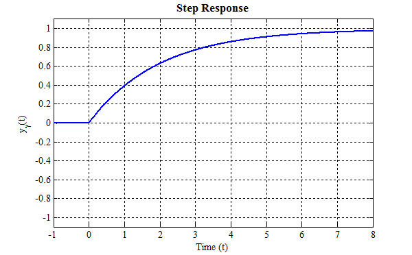

So I read the entire thread up to this point. This is what I speculate is happening.
Let’s say that you could press the pedal to exactly the position you want, in zero amount of time. Now let’s graph the throttle signal to the engine on the vertical scale, and the time it takes to change the throttle position on the horizontal scale.
Graph 1. Your car is in Normal Mode. Your foot suddenly presses the pedal from 0 to 1. A mild shape curve is what the ECU delivers to the engine.

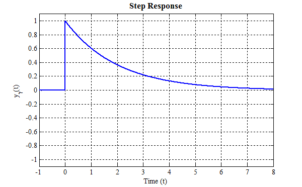

Graph 2. Here is what I speculate the PedalMax does to the throttle-by-wire signal: the sudden spike curve.
Graph 3. Add the second graph to the third graph, and you arrive at what instant throttle response would look like: The ideal step-response curve.
So yes, the PedalMax "amplifies" the signal generated by the movement of your foot (but only at the beginning), in an attempt to compensate for the designed-in "mellow" response. In reality, the signal shape in Graph 2 cannot be precisely achieved. Instead you may get something more like Graph 4, but you would not be able to detect the “ringing” in the red curve, because of all the “mechanical filters” in the car (including in the drivetrain, and regardless of transmission type). (The curves shown in the white papers, etc. show that they have eliminated any electrical ringing.)
So the PedalMax makes the car behave more like it has an old fashioned pedal cable.
As for Drive Modes, it seems to me that Normal is for “normal” driving, i.e. like driving any other plain car: moderate acceleration, good mpg, etc. And possibly for when your GF drives it, with less chance of her getting wheelspin if she has a heavy foot (but normally drives a Prius).
With the automatic, “just grab ‘S’ and punch it” leaves a little to be desired for throttle response, IMO. Part of that is a short delay to wait for the tranny to sort out which gear, etc.
So I can see where PedalMax would be a nice mod to have for all cars. My concern is if the ECU really does at some point in the future determine it must re-map the throttle response – again back to true Normal Mode, which is with intentional throttle lag, such as to prevent wheelspin.
And since the PedalMax is before the ECU, the ECU might just think that your foot changed its driving style, and therefore decide NOT to reprogram.
I think the takeaway is that you get improved throttle response in all modes, but the other parts of those modes (steering, traction control) remain as originally intended.
