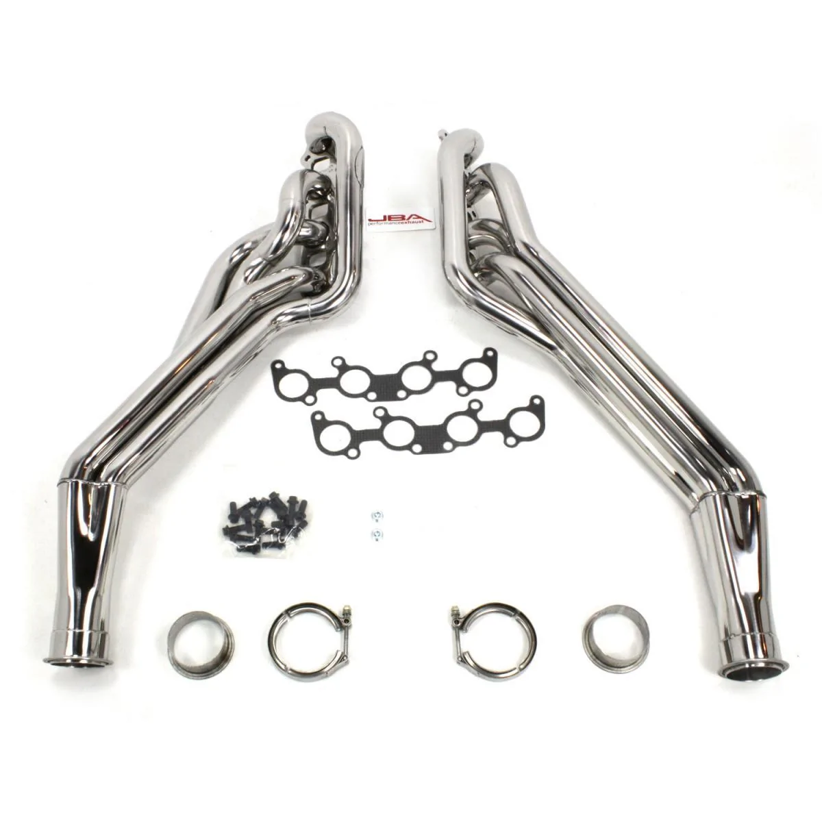

Is anyone on here running JBA long tube headers. They seem to have a high quality set of stainless headers with a cattedx pipe. Less than $1100 for both.
I have found the headers for around $570 and the cat x pipe for around $520. I know that JBA makes quality products. Just wondering if anyone else has installed these.

I helped install a set of these. They were ceramic coated. We had trouble clearing the steering shaft because his engine is lowered for a CJ, but other than that they seemed fine. I don't remember being too enthusiastic about the supplied gasket.

friend of mine had them on his 2011, they were nice headers, made nice gains too, only issue I noticed was they hung lower than other headers, Im sure its different on this chassis

I always use an OEM manifold gasket. My SW gaskets were crap too.
same here, I reused my stock header gaskets with my Pypes LT install on my 2011

I had a shit experience with a JBA full exhaust fitment on an old car, proceed with caution....

I have the ceramic coated version along with the complete 3" exhaust. It sounds great and is not loud at all. Nice deep tone to it.
One primary on the driver's side would just touch a stud for the heat shield. But only sometimes at WOT. I cut the stud down a little and that problem was solved. Otherwise it cleared everything well.
