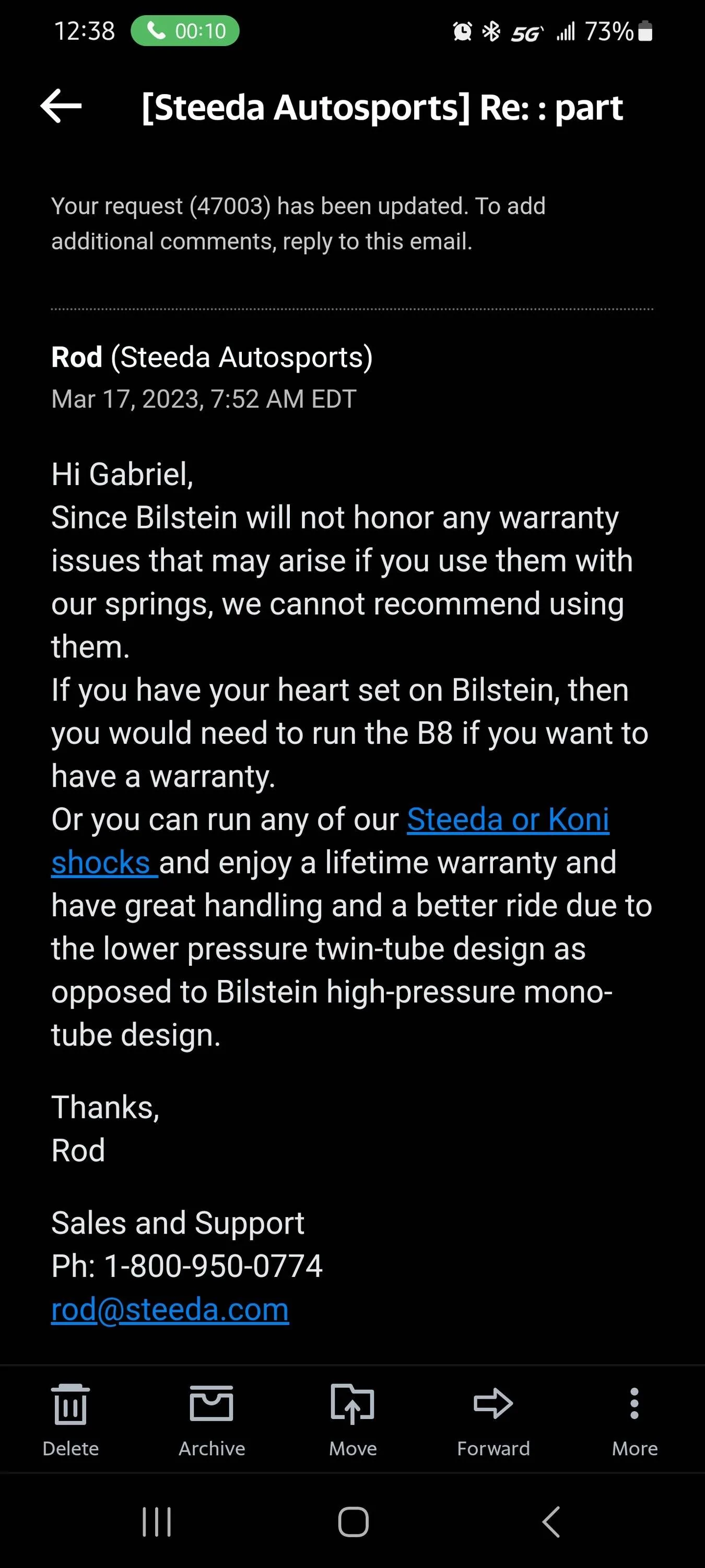

well this is embarrassing because I did actually buy b6's, but my BMW brain had b8's on the mind when I wrote that post. I bought these to pair with my BMR springs. Steeda even sells their springs with b6's https://www.steeda.com/steeda-555-2423-s550-lowering-springs-bilstein-dampers
I emailed steeda and they told me the warranty with Bilstein wouldn't hold up if I ran it with that setup. They told me the B8s would be better suited but I don't see any with the mounts for the bottom.
