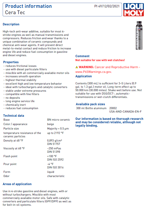

My 2021 Mach 1 developed the ticking noise after my first oil change, which I did after one year (with only 500 miles on the car.) I used Mobil1 5W30. A friend of mine did his first oil change on his 2021 Mach 1 but he used Valvoline VR1 Racing oil, 10W30. He did not develop the tick noise. I then changed the oil again using the same VR1 Racing oil (also 10W30.) I also added one container (300ML) of Liqui Moly Oil Additive Cera Tec 3721. I added that after reading numerous posts on its ability to eliminate the tick noise. Coinsidering my friend did not use that and only used the VR1 oil I assume the oil really is what eliminated my noise. It's been another year since then so I will over the next few days be changing my oil with the VR1 oil but without the Liqui Moly. I will report back as to the tick noise and if it returns or not. You may be asking why we used 10W30 - well we do not drive our Mach 1's in temps lower than 40 F and thus 10W30 is perfectly fine. VR1 oil does not come in 5W30 (factory recommended viscosity) otherwise we probably would have used it if it did. Hope this helps!

I'm also an advocate of Ceratec, it cured the tick in my friends S197, night and day difference.

I've heard about ceratec but does anyone know whats actually in it?
